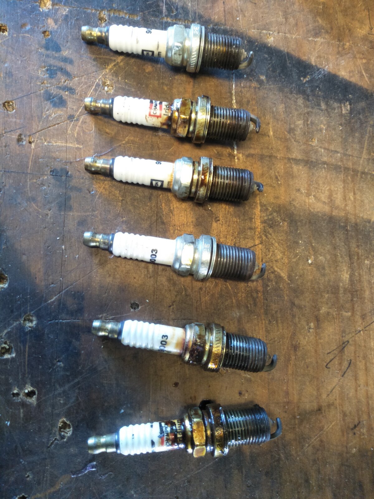

This looks like the problem.
All plugs except 1 and 4 have oil on them.
I guess that would mean there's a problem with seals/gaskets under the Rocker Cover?

Hi,
The plugs dont look too bad, I would replace them with a set of NGK, never been a fan of Champion plugs.
It would be worth checking the rotor arm and distributor cap etc for wear and carbon build up.
A new rocker cover gasket will help with the oil in the plug holes but I dont think it would of been doing too much harm.
