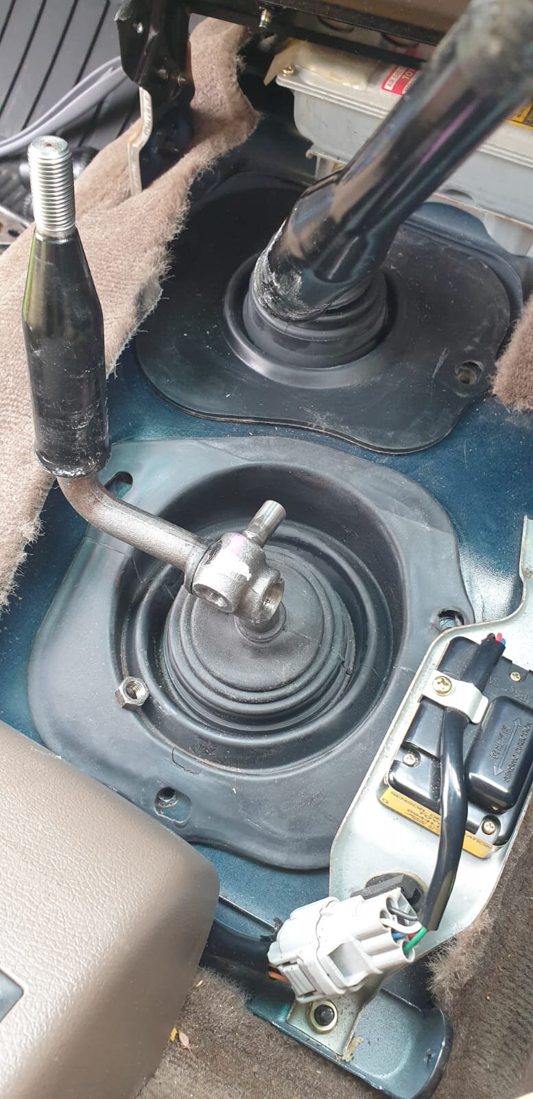

After the nightmare fuel problem, I've just brought the 80 back from it's MOT and whilst driving over the meadow at home, I put it into Lo ration, just to give it some use, trying to avoid the common seized shifter problem.
Unfortunately, when I then tried to put it back into Hi, there was no resistance! and the stick literally went straight to floor (so to speak!), literally horizontal with the centre consul!
I can get it back into Lo ratio, but there's no engagement in Hi ratio whatsoever, just feels loose.
So, obviously I now need to strip it down at the weekend, but trying to get a bit of heads up before I do and wondering whether anyone here, has also had the same problem?
Thanks in advance.
Cheers
J.

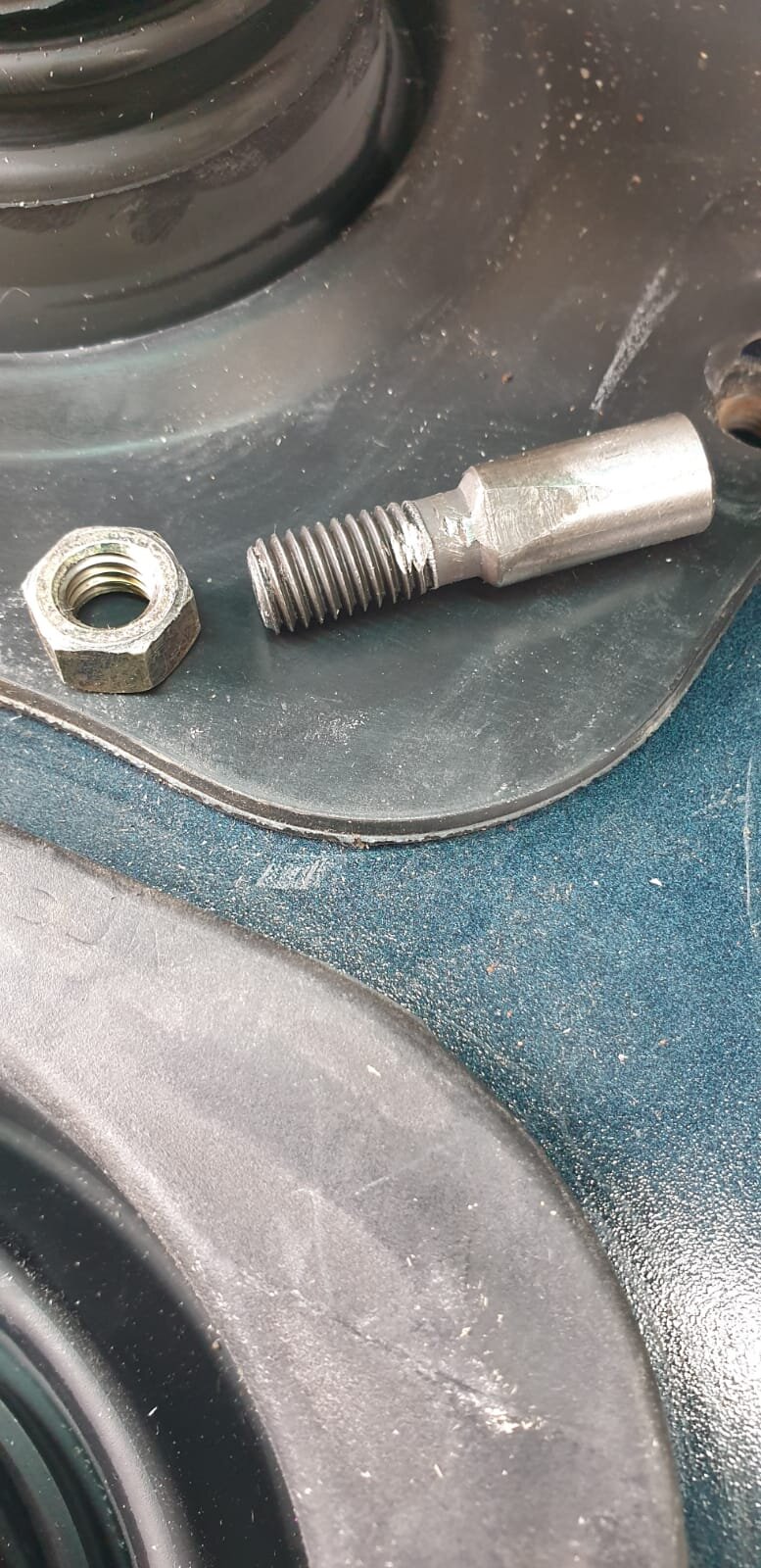

Well..... Stroke of luck!
It was just the locking pin that had unscrewed, so straightforward.
Bit of Loctite, job done. :grinning:
