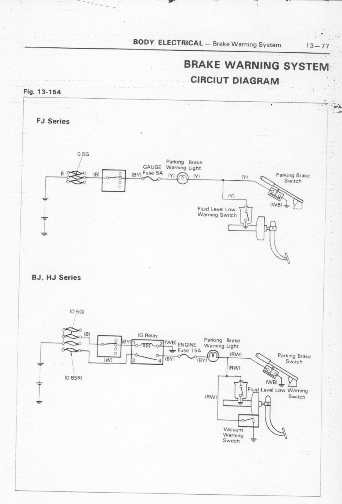

Hello everyone and thanks for taking the time to read my inquiry and bigger thank you if i can receive some help
I have recently purchased a hj45 ute and am having hell getting the brake lights working. not being able thus far to locate a wiring diagramme to suit has been less than fruitful.
i have done the basics checked globes , fuses checked connections and cleaned them , and even rerun earths, tried to follow the loom but being in remote australia there have been alot of "bush Mechanics" done on the vehicle so i actually am surprised that the previous owner didnt use coat hangers for wiring with duct tape for insulation! can anyone direct me or supply me a brake light diagram to suit my model hj47 2h diesel 1976
any input would be helpful. They worked upon recievership and i have had to take the instrument panel out on a few occasions to do other work i have power to the switch off the brake pedal with 2 wires but the other 2 are not recieving current, looping out the wiring bypassing the switch still gives me no brake lights.
like i said any help would be appreciated.
Hi,
Only found HJ brake warning system diagram so far
Maybe that helps
