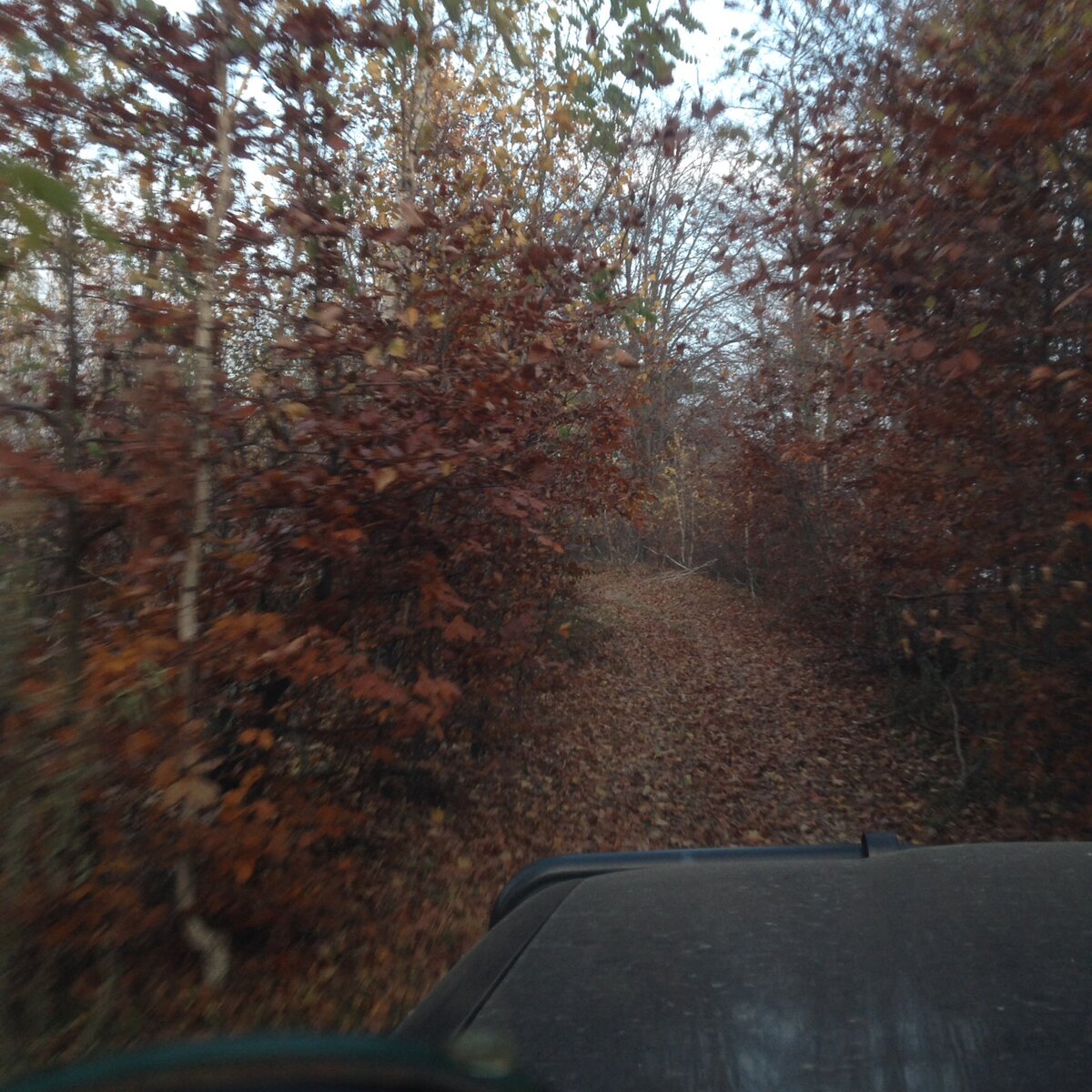

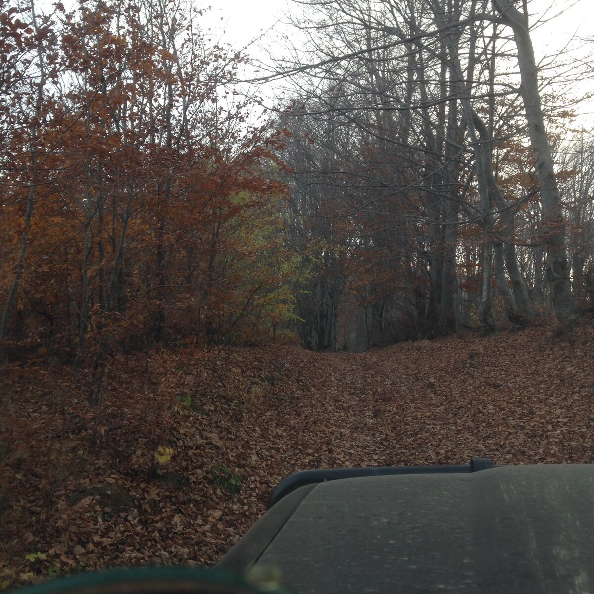

I used mine on Saturday. Went to a small village and found it was their market day. What a nightmare, millions of folks all blocking the road. It took so long getting through the village, only to find the only way back (not going through the crowds) was across the mountain.
The track was very tight and in one low spot, 1/2 m mud! I managed to drive through the first part, but the next two were too deep without a pull. Handy, these winches! No proper photos I'm afraid, these are all I took that are handy from the iPhone, the rest are on the camera.
