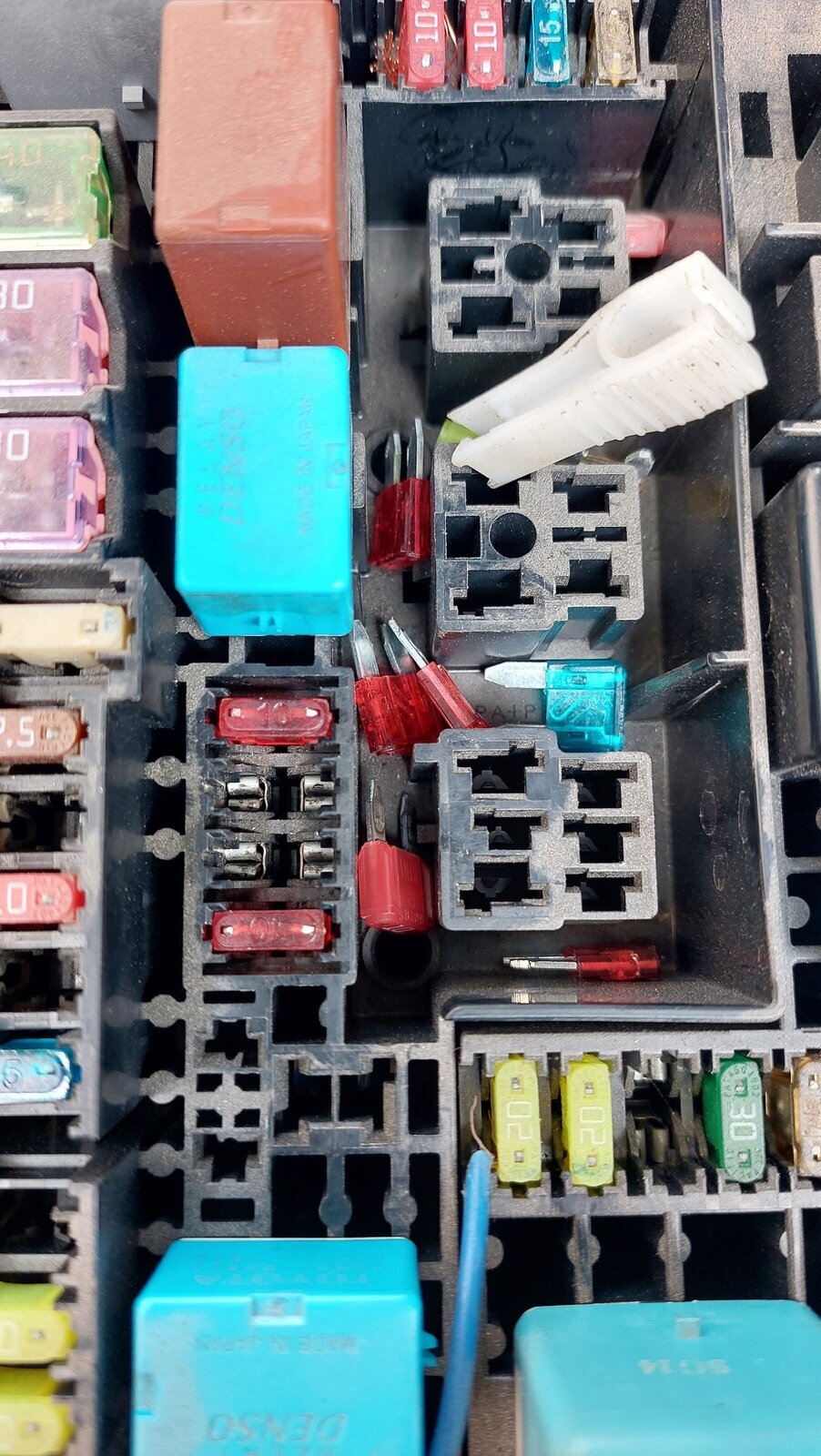

Few interesting finding today.

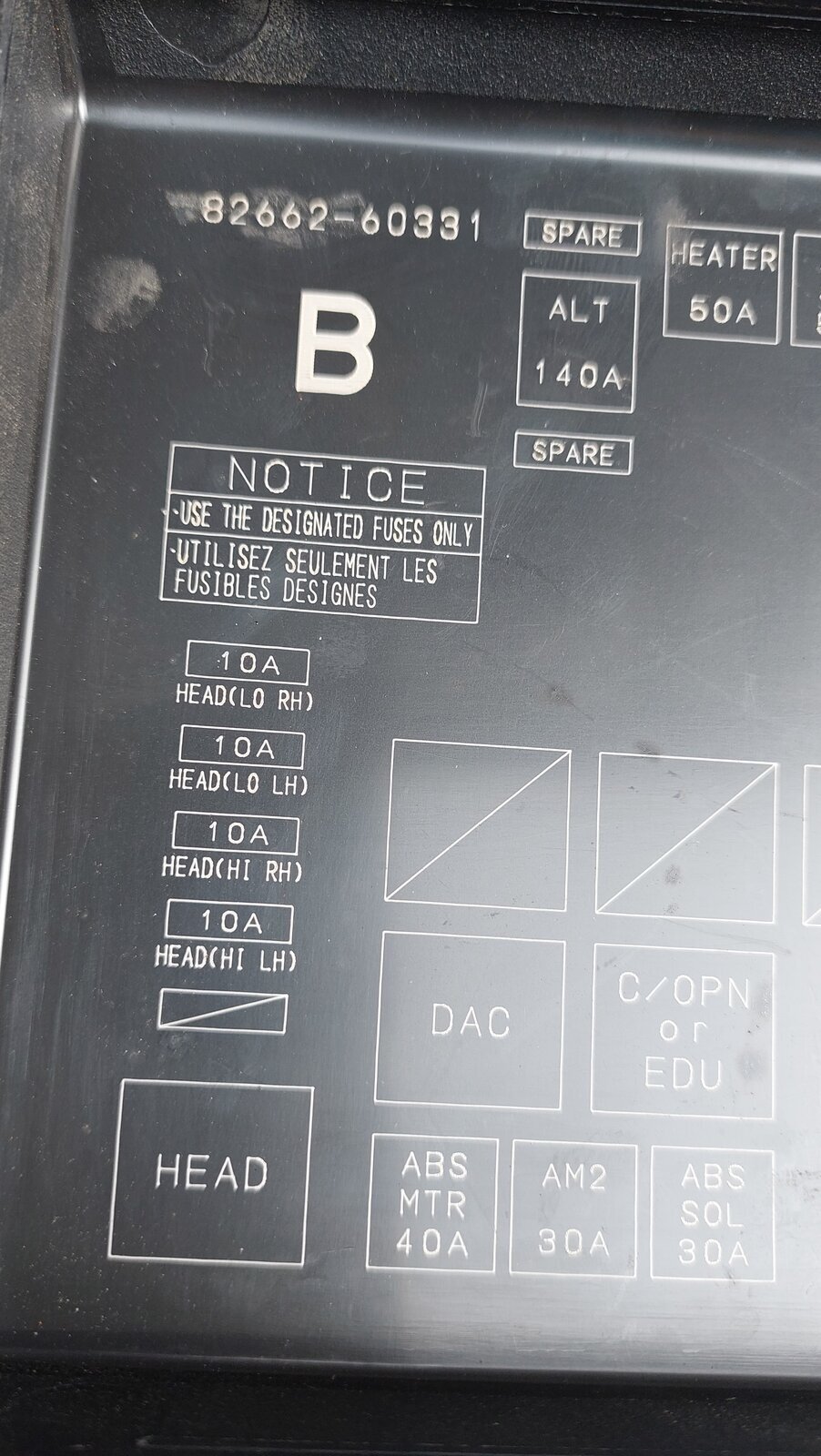

Just done a fuse test and removed the 4 fuses for the lights.
On installation of the fuses I noticed small sparks on the 2 middle fuses but still showing battery voltage as fine.
Couple of other things I have noticed since I removed my 4 fuses my drivers window loses its auto feature and my dash clock loses time.
My puzzle is the time lost is around 42 minutes but my clock was correct when I parked up.
I have not been outside for 42 minutes but around 20.
Puzzled to my findings.

All fixed and working correctly.
Blown fuse and I was looking at the wrong fuses like a big dope.

Great, well done! It doesn't help that the fuse box diagram claims there's 4 fuses for the headlights, but only 2 are fitted...
Yep, I've found confusing info on my fuse box lid as to what is there and where, glad you got there Tony.

You hit the nail on the head as that was the part that threw me off looking at them fuses as 2 are blank anyway but yes got there in the end.
