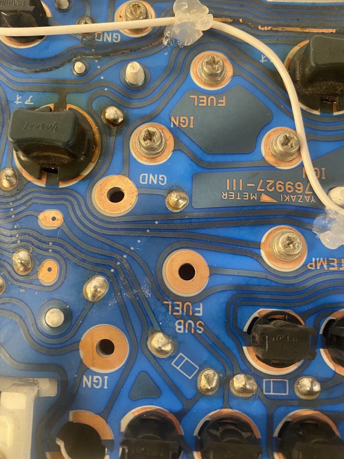

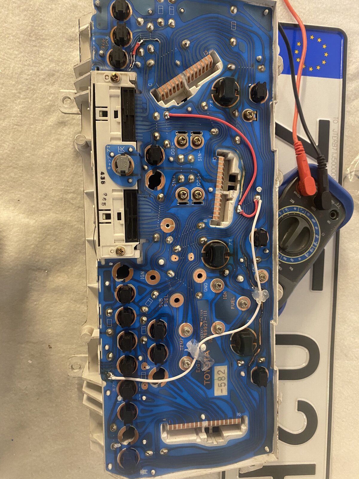

My instrument cluster is not working properly.
Speedometer, the light for the speedometer is (was) only shining up till (60km/h), which leads me to believe that the second lamp is not getting any current.
I've checked all the lamps, and they are working when connected to a 9v battery. It's been like this since i bought it.
Engine temp (Water) and Fuel Gauge:
Niether the lights work here anymore, it was working when i bought it. (bulbs works when connected to 9v battery).
When i drove the car to the registration control, the Engine temp and Fuel Gauge light suddenly came on for about 5 seconds, AND the radio turned on, then after about 5 seconds it turned off again, and its not working anymore.

The cluster has had some repairs done - Or, it has to do with the immobalizer system.
The cluster;
The wiring is what i've done yesterday, to tidy it up. And to fix some other traces that were bad. I've just re-done someone elses work basically.
Finding a complete workshop manual with EWD for HZJ78 seems impossible, so does anyone has any ideas?
Hopefully tomorrow ill be done with removing all the Immo/alarm system and the former owners electrical work. Then i'll see if there is any difference.
