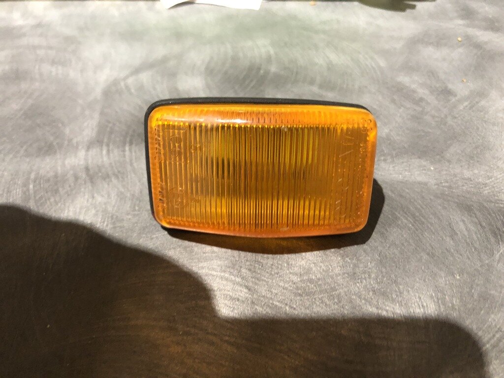

I appear to have lost my side indicator for the passenger side wing. Can anyone advise how easy this is to replace? My inner wings were welded to the outer so will I need to cut a hole for access? I cant see where the indicator comes in from the wing.
Has anyone got an indicator for sale?
If you take the screws out of the side indicator, there's enough slack on the main wiring spur. Before disconnecting the connector tie a piece of string on the main loom connector so it doesn't fall back into the inner wing! I didn't do this once and it was a right pita to reconnect! All is possible without any cutting! How's it going man,since a while?
The indicator has fell off with the wiring connector! I have a hole where you can see into the Wing with no wire!
Update managed to find some KZJ70 replacements. Someone was breaking a kzj70
