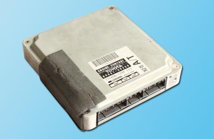

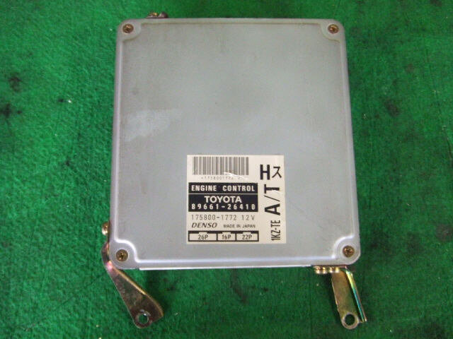

I now know that a secondhand ecu for a KZJ78 is very rare. Recently I had to get my ecu refurbished and Rommel is running again but I've become a bit concerned about reliability especially if the ecu were to give trouble again particularly in a remote area.
I have seen a lot of a similar ecu for sale and wonder if anyone knows what the difference is between the two.
My part number is 89661-60250 and the part number for the ones I've seen for sale is 89661-26410.
I've attached pictures of both and as you can see they both mention "1kzte auto". Will 89661-26410 work in my '94 KZJ78 (1kzte) Auto?

Hi
89661-26410 is off a Toyota Hi-ace or Regiusace.
Its the same basic engine, but I dont think the gearbox will be the same, possibly not the fueling either. Both of these could cause problems.
On the other hand, we only progress because people investigate ideas, if its cheap, give it a go and see what happens.

Thanks for the replies and advice. Is it possible to cause damage by trying the 89661-26410?
I wouldnt have thought so, the most likely result will be that it wont start cos the fuelling set up is wrong, or you will get odd gearchanging, cos the gearbox setup is different.
Pete
