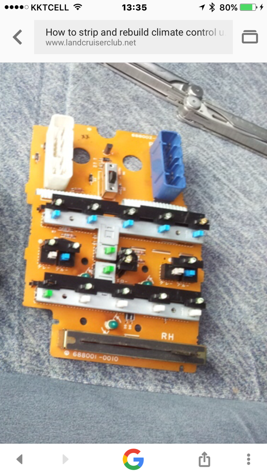

If it’s like the 80 there soildered light modules that’s are not a switch over product.
Mine have faded too maybe someone here can shed more light for the 90 series?

This is what I mean Geoff on the 80
