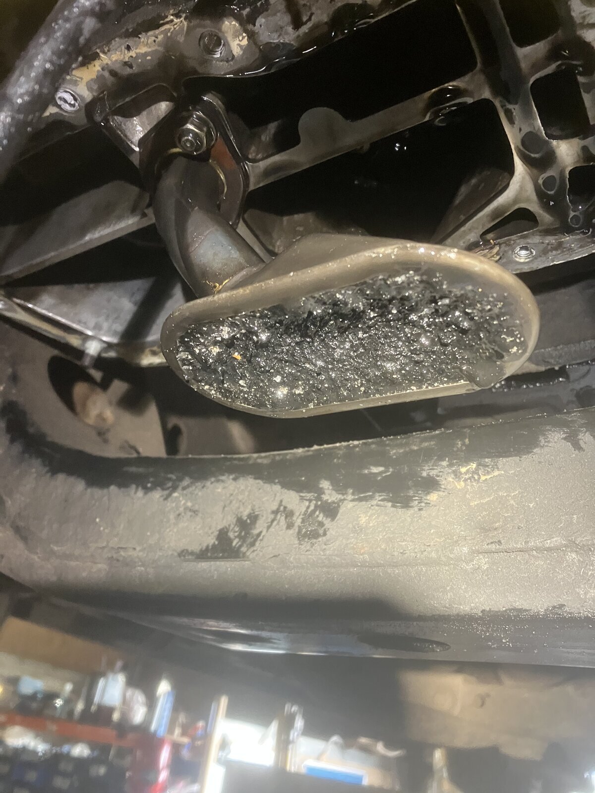

As you can see from the picture the suction filter was really dirty, please do not be miss led that the shiny bits are white metal, as I had a really strong head torch and it was mostly carbon grit that the light was reflecting off.

That looks well choked, it's a wonder any oil was being circulated.
The gauze on the strainer should be clearly seen through the sump drain plug if clean.
Carbon and other sludge can be caused by injector blow by, which is why Karl asked the questions about injectors and seals etc.
If you are going to clean your egr, do the throttle body/inlet manifold at the same time.
For more information on the injector/seals problems that dog the 120, that have on occasions wrecked engines, do a search or trawl back through the threads, they are well documented.
