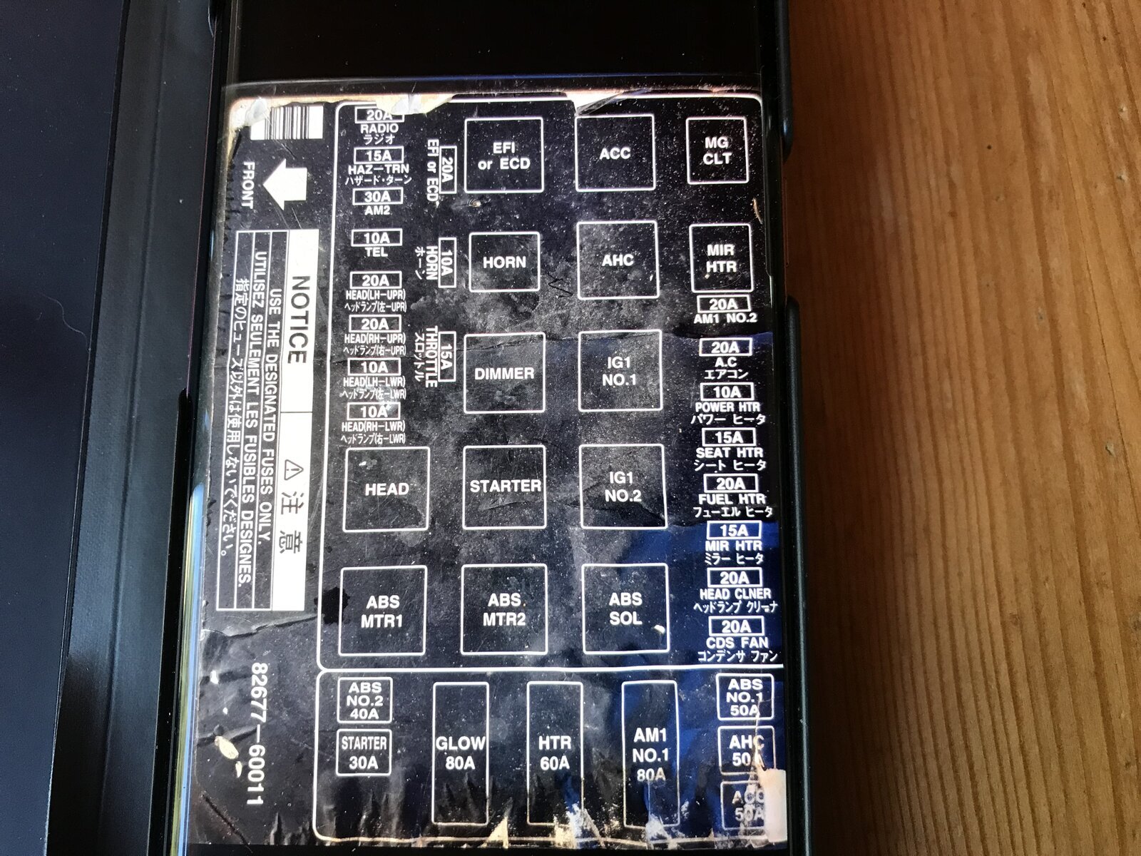

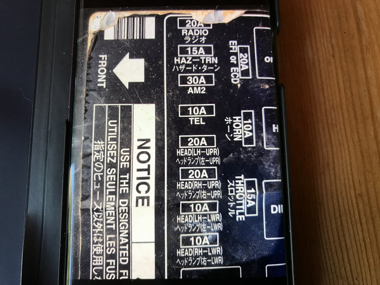

Hi Jibberjabber thanks for the reply the year is 2000 and the fuse is AM2 ? (Photos) and with the alarm it is an aftermarket ‘Steel Mate’ Sometimes if I unlock it and put key in ignition the dash lights show but you turn the key to start.. Nothing and a blown 30amp fuse . Sometimes it will turn over a couple of times and then blow a fuse ??? . WIERD

My 100 is a UK spec, and has an AM2 fuse, but it's a 15 amp and is for All components in "IGN"
Forgot to ask, petrol or diesel, I'm guessing petrol as it's a Lexus.
As it's when you turn the key to start, it's possibly something to do with the starter or the starter circuit, have a very detailed search using a torch looking for a break in a wire that could be touching someting else, or in other words a short circuit
