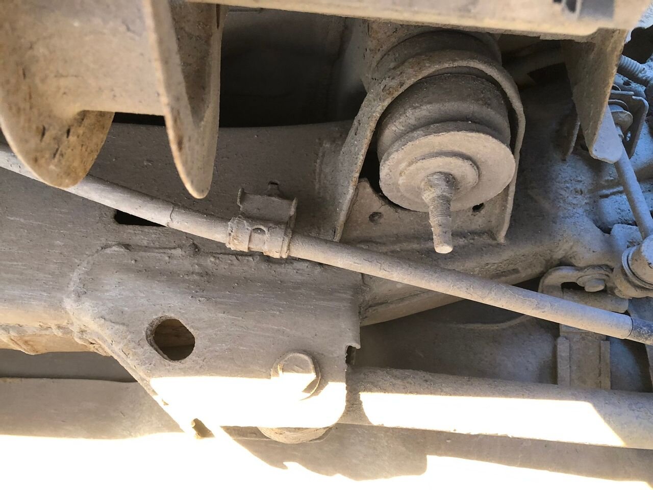

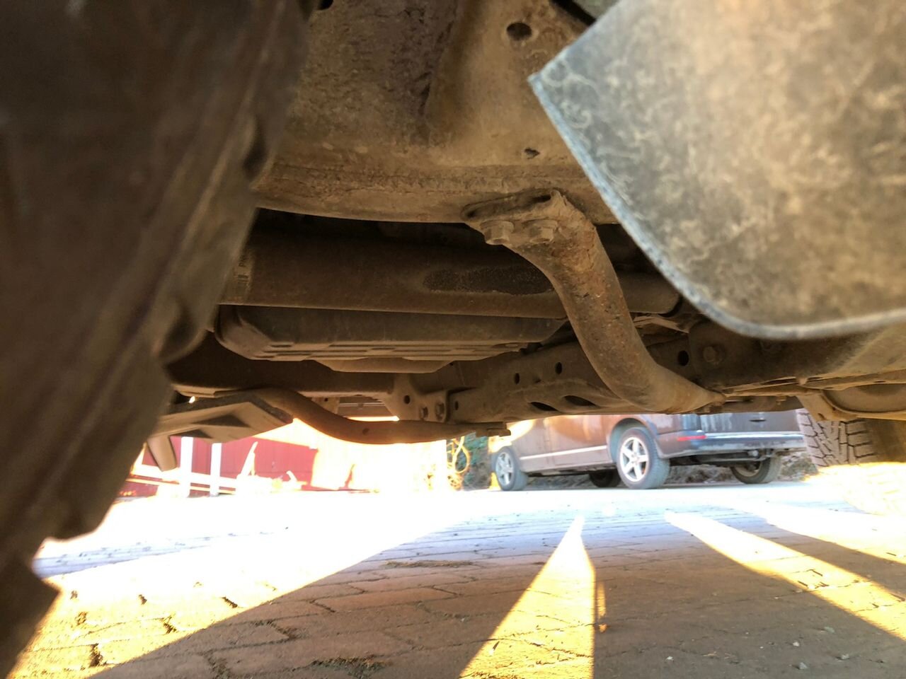

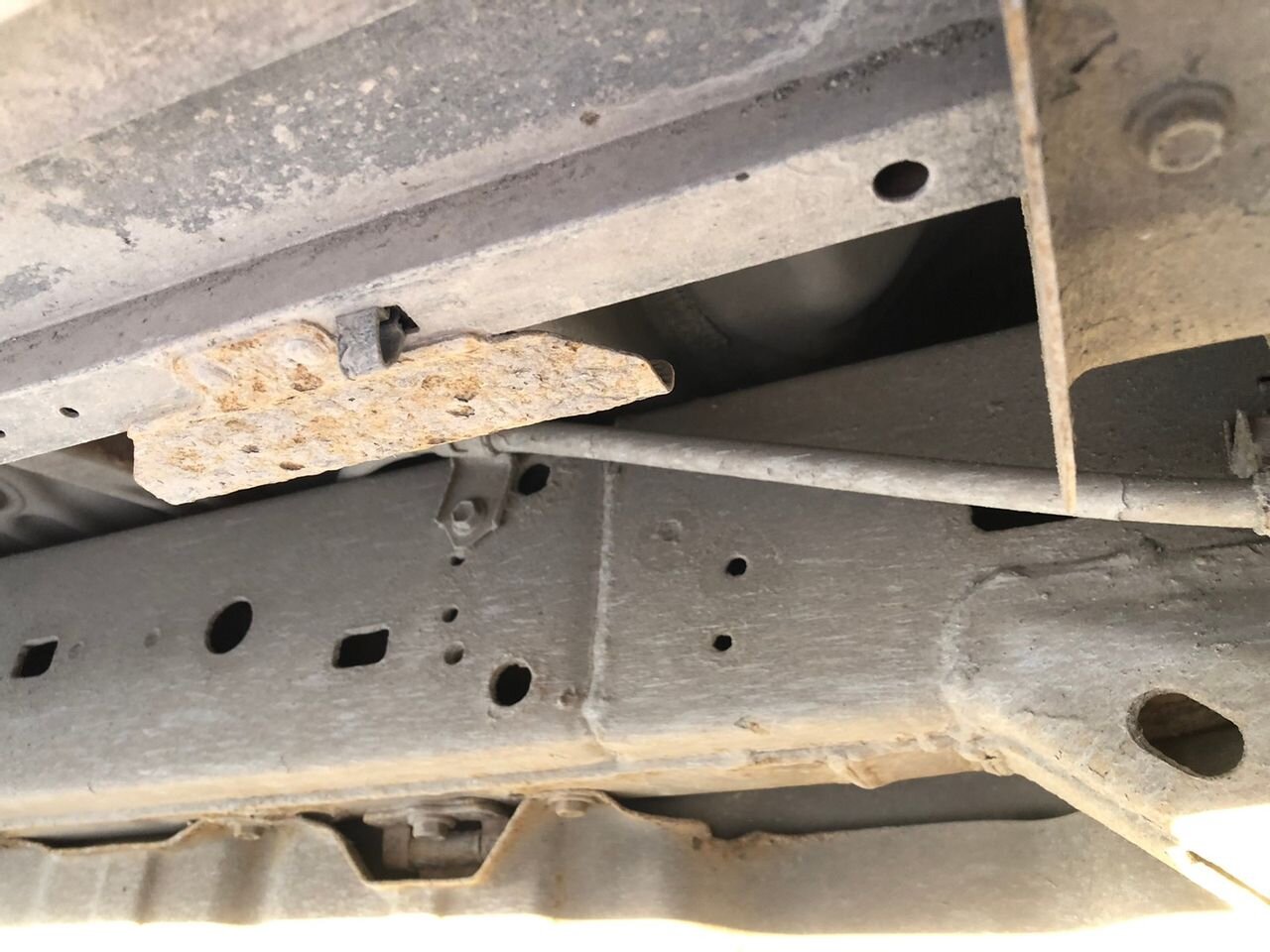

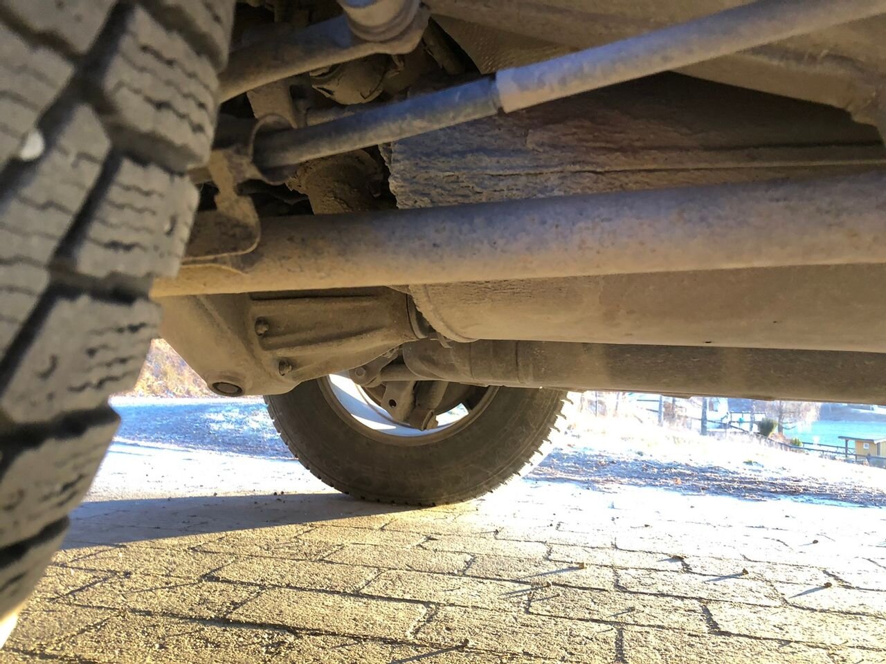

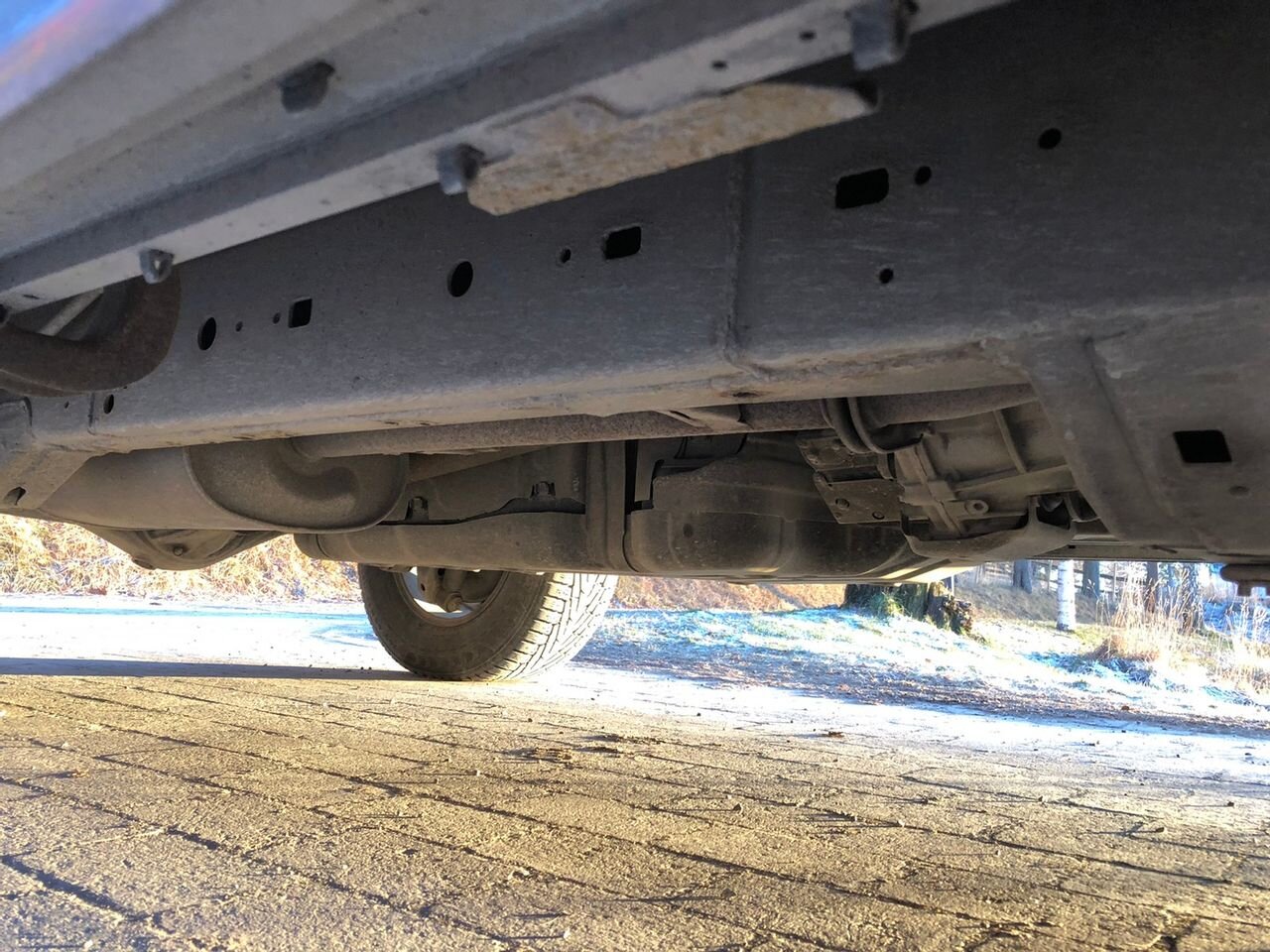

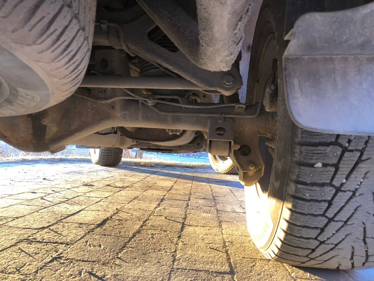

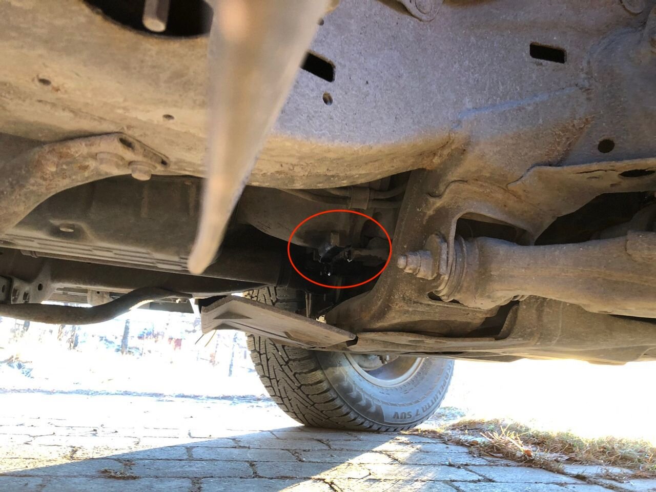

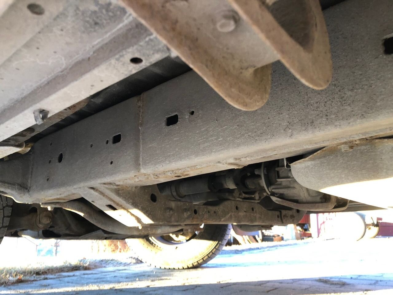

Hi guys. Thanks for all the replies. So I am stilling searching for a land cruiser. I have my eyes on this one (link below, it's a n LC120 from 2007/8). Can you have a look at the pictures and let me know what you think of the condition under the car. In my opinion it does not look so bad but my understanding of such things is limited. There are two pictures that are concerning me a bit. I believe I am seeing some oil leakage. Attaching those pictures here so you can have a look. I have added a red circle where I have spotted the leakage. If that is a leakage at all:
Link to the car: Toyota Land Cruiser - [Leaving Land Cruiser Club]
The owner just had it serviced from Toyota. He is mentioning that no remarks were made regarding any leakages. But I don’t’ know, Toyota maybe didn’t check under the car..
Do you know where I can get my hands on a service manual for LC120 (2007-2008) and also maybe LC150 (2010-? This for sure will help me to get an better understanding of what should have been services so far based on the milage.
Ps! I see that the owner has added some of the pictues twice. The picutes of the underside are toward the end.

The areas you have circled are grease thrown off from the prop shaft and is a good sign , that means the props have been getting serviced , dry props = wear on the uni joints , under the 120 looks OK from the 2 pics you have shown , some rust is visible from just behind the side steps that is common on 120s it will need treating as soon as possible if you want to keep the 120 in good condition for many years to come , maybe more pics could show the rest of the underbelly to see if all is as good as the 2 pics .
