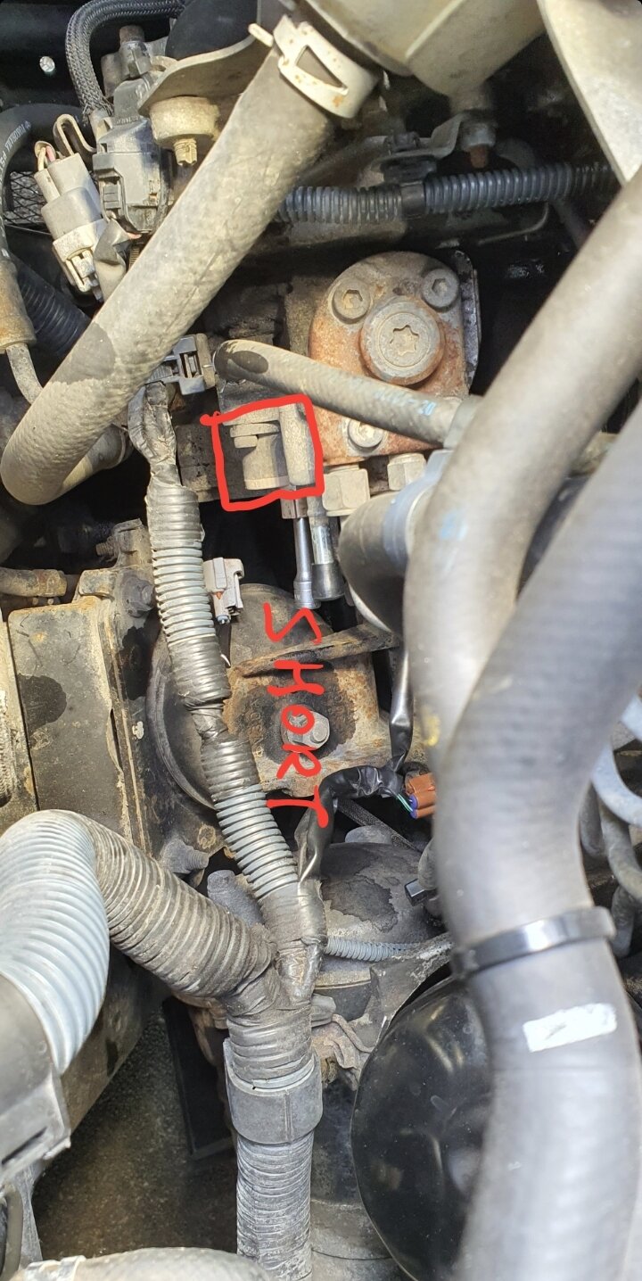

The SCV is the Suction Control Valve and is the valve that regulates the fuel pressure on your high pressure diesel pump. When these fail, they can cause the engine to splutter and die, and I don't think there is much warning when they are about to go.
The original ones fitted by Toyota were short, but then they were redesigned and replaced with a longer version. The short ones are notoriously unreliable, and a lot of people change them to the longer version before they fail. There is loads of info on here about it, and TonyP mentioned it above.
I've attached two pictures so you can tell the difference. Lots of videos about it on YouTube fourby4diesel too

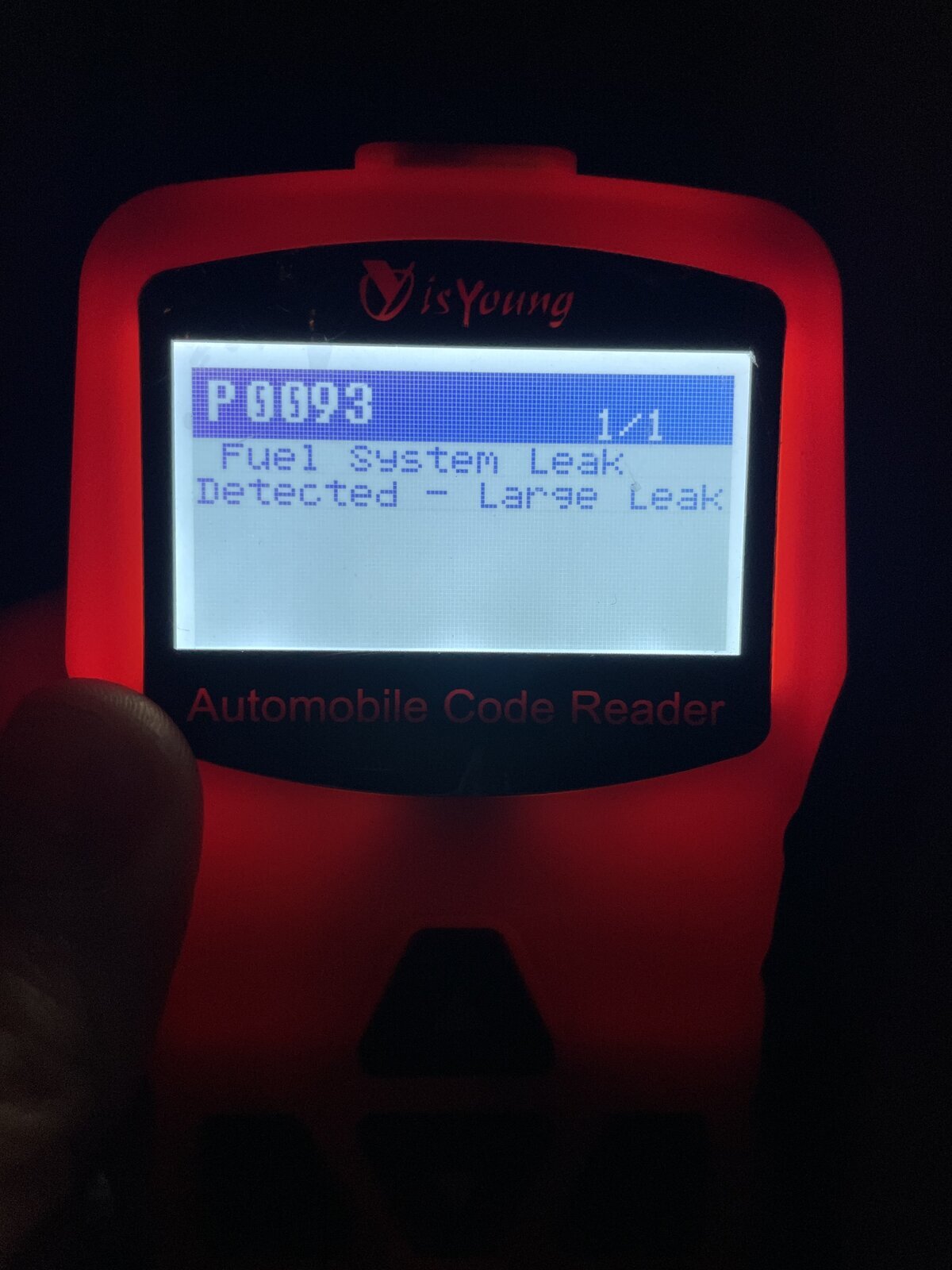

They both showed the same codes, one gave text too. It is P0093 - Fuel System Leak Detected - large leak

Any signs of diesel pissing out anywhere? Have you got pressure on the diesel filter primer?
Could still be the SCV I suppose if it's broke and the fuel.pressure has dropped, that might cause a leak code. Let's see what the experts say.
I was defo getting large leak errors (sorry can't recall the code), which were resolved by changing the injectors.
Injector values can be checked to see if they are within tolerances. There is a pinned thread in the 120 section which has some good info
Karl - no diesel pissing out of anywhere…..no puddles and sitting at half a tank after driving home (gingerly) 5 miles…
Haven’t cleared the codes, as wasn’t sure if it is best to leave it to the experts.

Symptoms of SCV failure
The most common symptoms are a lack of power or rough idling; both these faults may be intermittent. DTCs P1229 and P0093 relate to excessive pressure in the system caused by the SCV sticking open longer than it should and will cause the engine to go into failsafe mode where the engine power is restricted. DTC P0627 relates to the SCV circuit, this could be caused by an open or short circuit in the SCV field coil or in the wiring.

Hi Paul, SCV is cheaper and easier than injectors and will need to be changed sooner or later if its the short type.
