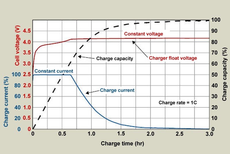

Is it unreasonable to expect the steady voltage out of an alternator to fully charge these at 80% of the alternators capacity?
Charge graph from http://batteryuniversity.com/learn/article/charging_lithium_ion_batteries
