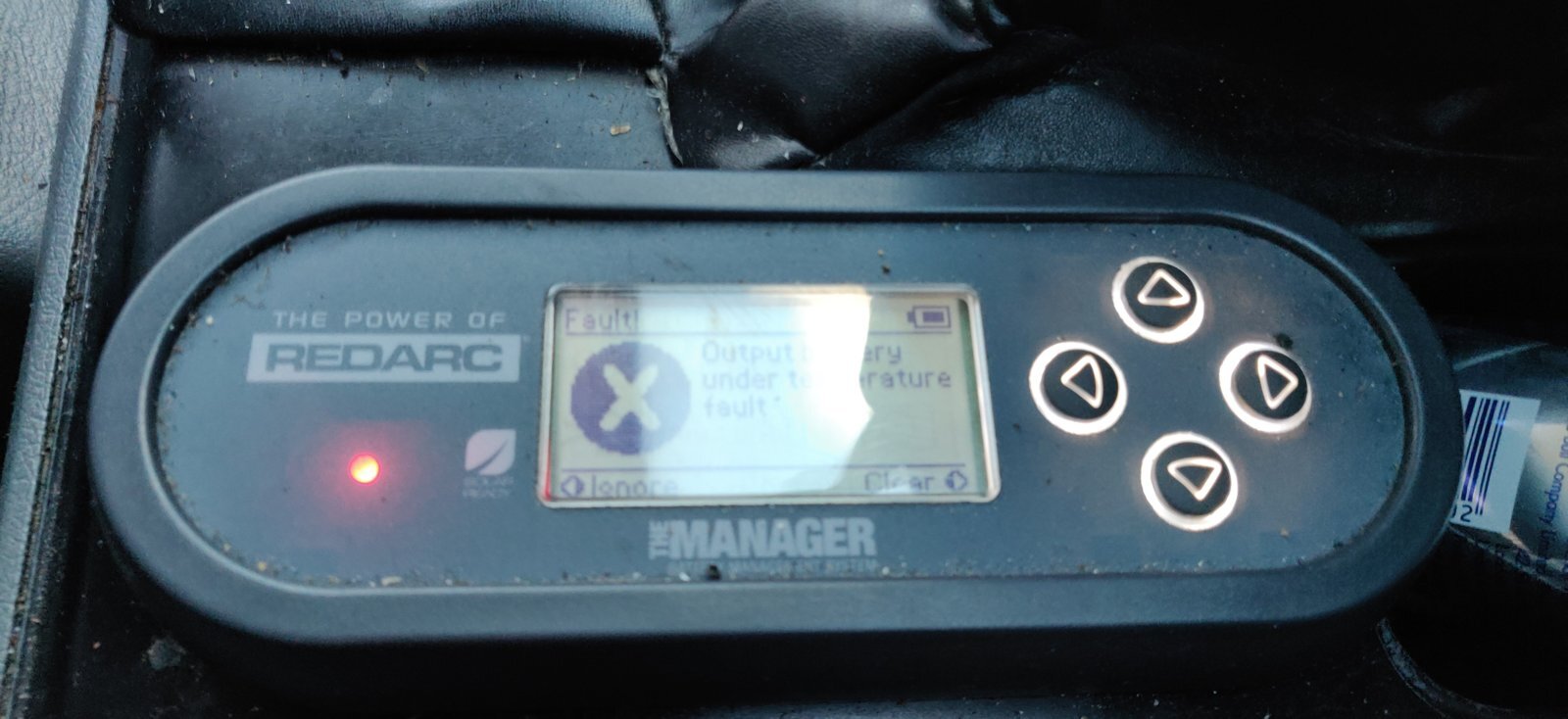

My Rev Power battery certainly does not like being cold for very long.
Took this photo on a frosty winter morning where the overnight temp was sub zero but nothing like -10 or -20. Apologies for the glare, but the message reads "Output battery under temperature fault".
The battery happily came back to life after the cab warmed up but the warning I took from this was if camping in wintery conditions make sure the battery is reasonably insulated and be vigilant that both charge and supply may be interrupted if it is too cold.

We’ve had a -10 night so far but thankfully the inside of the trailer stayed just above zero. I have the batter located between the two 70l water tanks so when they are full it takes quite a bit of cold to drop them to feeezing point. Which then of course I have two problems!
