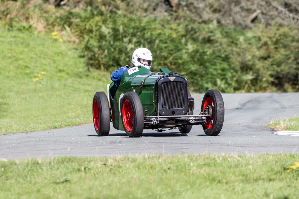

My Austin seven race car I built from scratch over the last 7 years, I am now competing in the VSCC hillclimb championship. Modified from 10hp to 42hp.
Like you when I die, I'd like someone to pop its road wheels wings and lamps on, and drive it to my funeral.

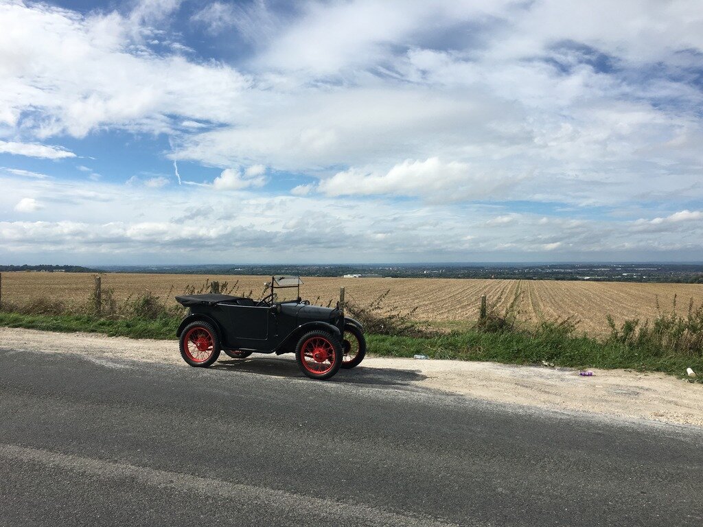

My Austin Seven Chummy, very slow and steady, I'm beginning plans with a group of nutters across the country to drive a group of these from Twickenham to Tokyo for the Rugby WC final.
I know my sevens inside out now having spent years working on them, tinkering, modifying, improving when money is available. I am genuinely interested in improving the cruiser I have right now and I'm sure I will learn as I do it.
