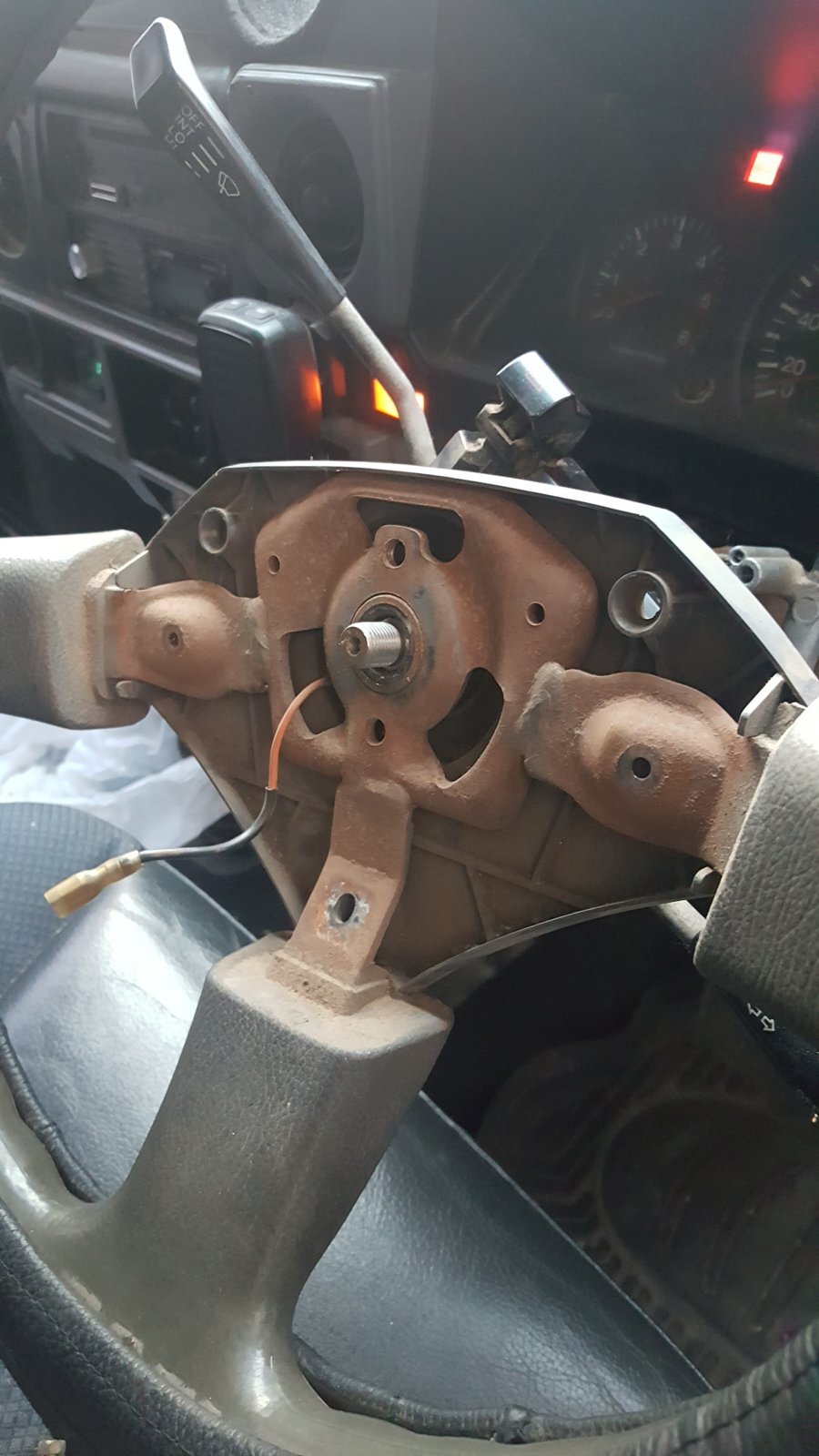

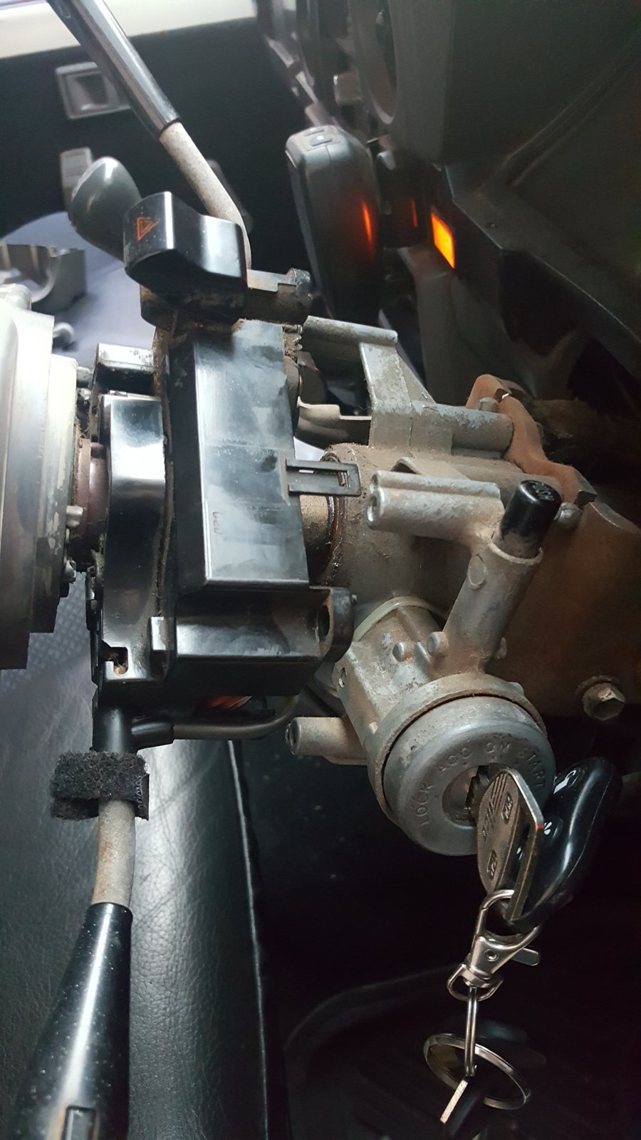

Hi All,
I have an electrical issue with my 93 Troopy which am hoping to get some help with involving the dash indicator light for the main headlights. Whilst I can actually turn the lights on, the blue light on the dash remains dormant. The problem is that I can't tell when my lights are on full or not. I mean, I don't mind blinding people but they don't like it so much :-)
I think the contacts just need cleaning (he says, with no assurance whatsoever) however I can't seem to actually get access to it because of the steering wheel is in the way - any ideas?
Thanks muchly, Richard

Hmm, yeah i suppose so, good thinking! :-) the thing is it used to flash intermittently between switching - kind of halfway point - so I know the bulb is ok. Or was a week ago, it has since stoped flashing intermittently ha ha although it could be the bulb, and I will have to check, I think its something else...could just be loose wiring going to the bulb I suppose...

Hmm, yeah i suppose so, good thinking! :) the thing is it used to flash intermittently between switching - kind of halfway point - so I know the bulb is ok. Or was a week ago, it has since stoped flashing intermittently ha ha although it could be the bulb, and I will have to check, I think its something else...could just be loose wiring going to the bulb I suppose...
I would say that there is the possibility of either a poor connection that’s got worse or a blown bulb that was touching intermittently and has now failed. Remove that bulb and put 12v across it to check, swapping for a known working bulb and testing both the bulb under suspicion and the good bulb in the socket for the headlights will tell you what’s going on. Either blown bulb as it won’t work in the known good socket or poor socket/circuit to the headlights dash light.
Ok, so I took out the screws at the front of the dash (facing the driver) but couldnt get the actual dash off - like its stuck towards the windscreen. Is there a catch there that Im missing? Feel like such a dumbass lol sorry!
The light has flickered on intermittently between switching states so can only guess its a wiring issue. If I can get to the bulb I will certainly try and measure the voltage across it and check the wiring end to end...
Just swap bulbs before you try checking the wiring. It’s far easier.
