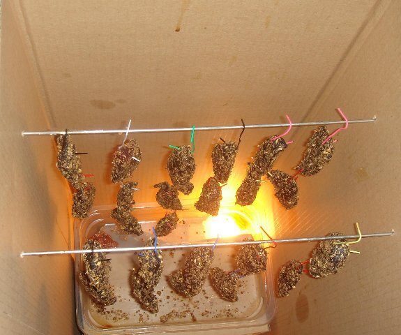

Making the box:
  1. Cut the dowel rods to be just longer than the box. Press them through the box so as to for hangers.
  2. Pop some other holes every inch or so into the top of box to form air holes. About as thick as your thumb.
  3. Do the same air holes along the bottom of the box.
  4. Place the lamp into the middle of the box. If it's very wide two 60W lamps would be better.

  6. Hang the meat from the hangers using paperclips.
  7. Turn the lamp on and wait :)
We made this in New York in winter and with the lamps on we made a batch of biltong in 3-4 days. The thinner, dryer pieces would be 2-3 days so start checking early.
Dryness is a matter of taste but the best is when it's still quite pink inside - much like a rare - medium-rare steak.
Contents of box:

Should the box be covered while curing and will the meat drip at all i:e; should the lamp be protected from drips?
Interesting Chris. When I made it I just used "rock salt" - whatever that is. Can't say it was either way. Will double-check next time.
Chas - Yes, they box should be covered. There should be enough thumb-sized holes to allow air to flow.
I don't recall the meat dripping but we did make sure the meat was not directly above the light. You want warm air - not heat. The first batch we mad had a slightly cooked slice of meat above the bulb which is not nice.
