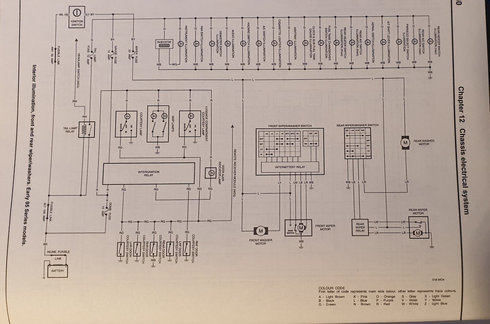

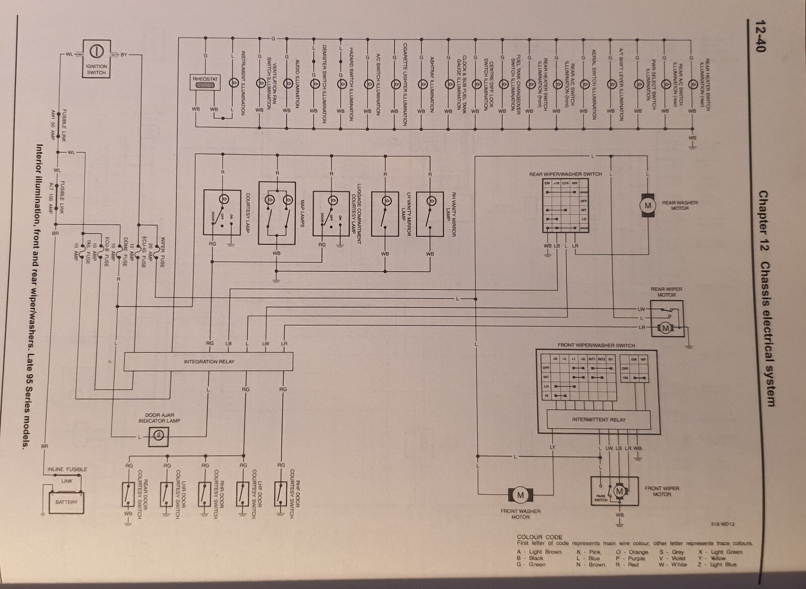

Changing my mind on this one - I thought it sounded like a stuck relay.
But I looked at the haynes wiring diagram and it looks like its ground side switched, so I'm suspecting the switch.
What year is your 95, there are two wiring diagrams!
It's a 1998 KZJ90L-GJMNTW. VIN is JT111GJ9000018156
Not sure which diagram applies to yours, but don't think it matters.
Try this - disconnect the plug from the washer pump. Check continuity between the LR (Blue/Red) wire and ground. If it's at ground when the switch is off, I think the switch is knackered.
