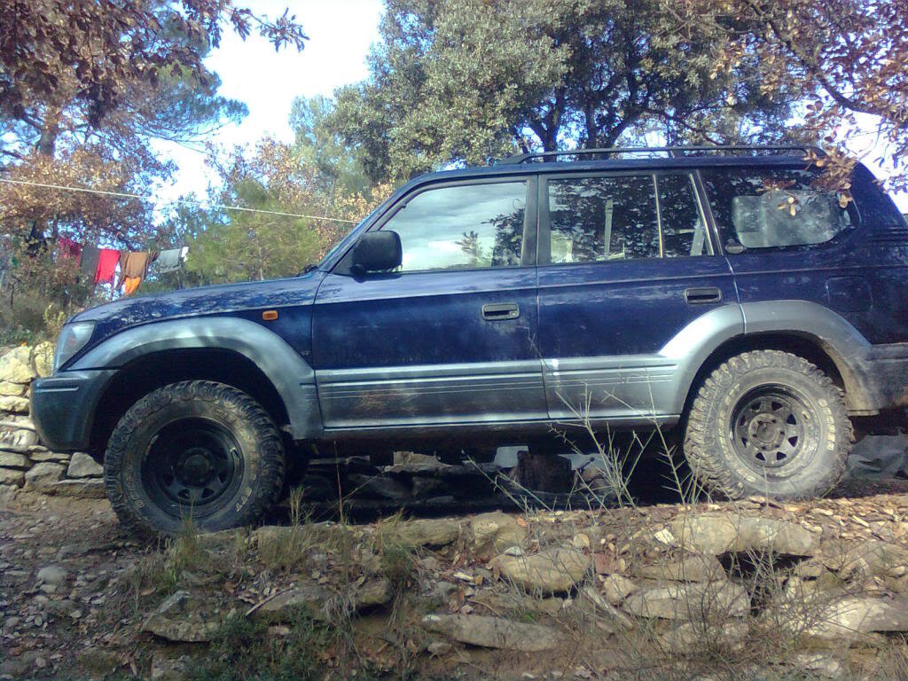

try paddocks 4x4 for the rims but remember that you will have to buy new wheelnuts as the ones for alloys are not sutable - they have a flat washer that sits in a counterbored hole in the alloy whereas for modulars the nut sits in a radiused hole - check out the price as i paid 4 euros each!
