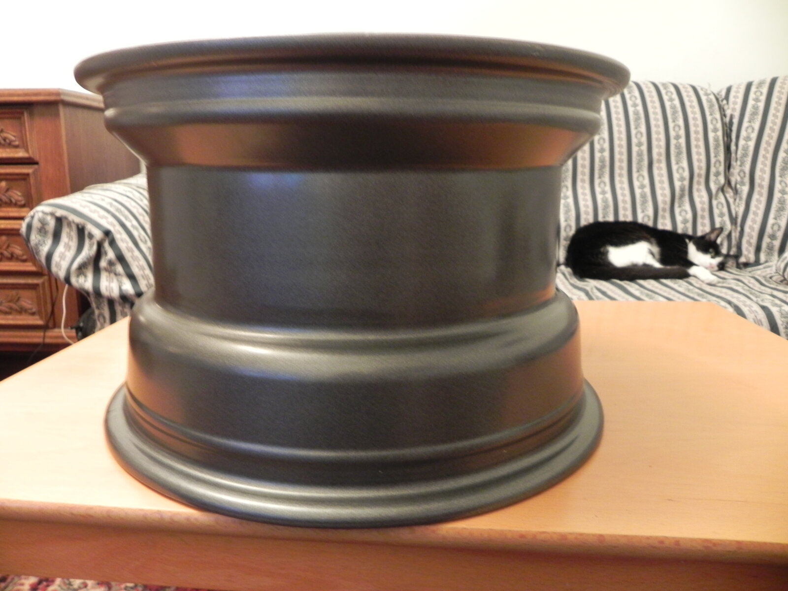

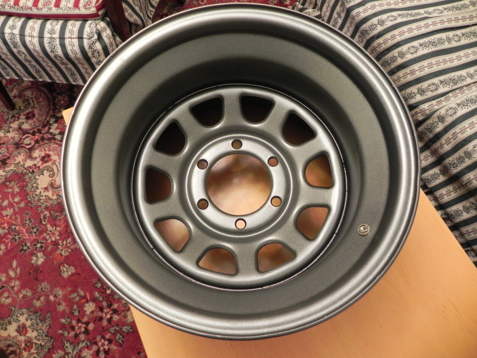

Here they are, I bought them new off a shelf in 2006 and I've recently had them
refurbed...
16" diameter
10" wide
Now, the complicated bit (for me) offset or backspace or whatever folks want to call it (why is it we can't all speak the same language when talking about the same thing?)

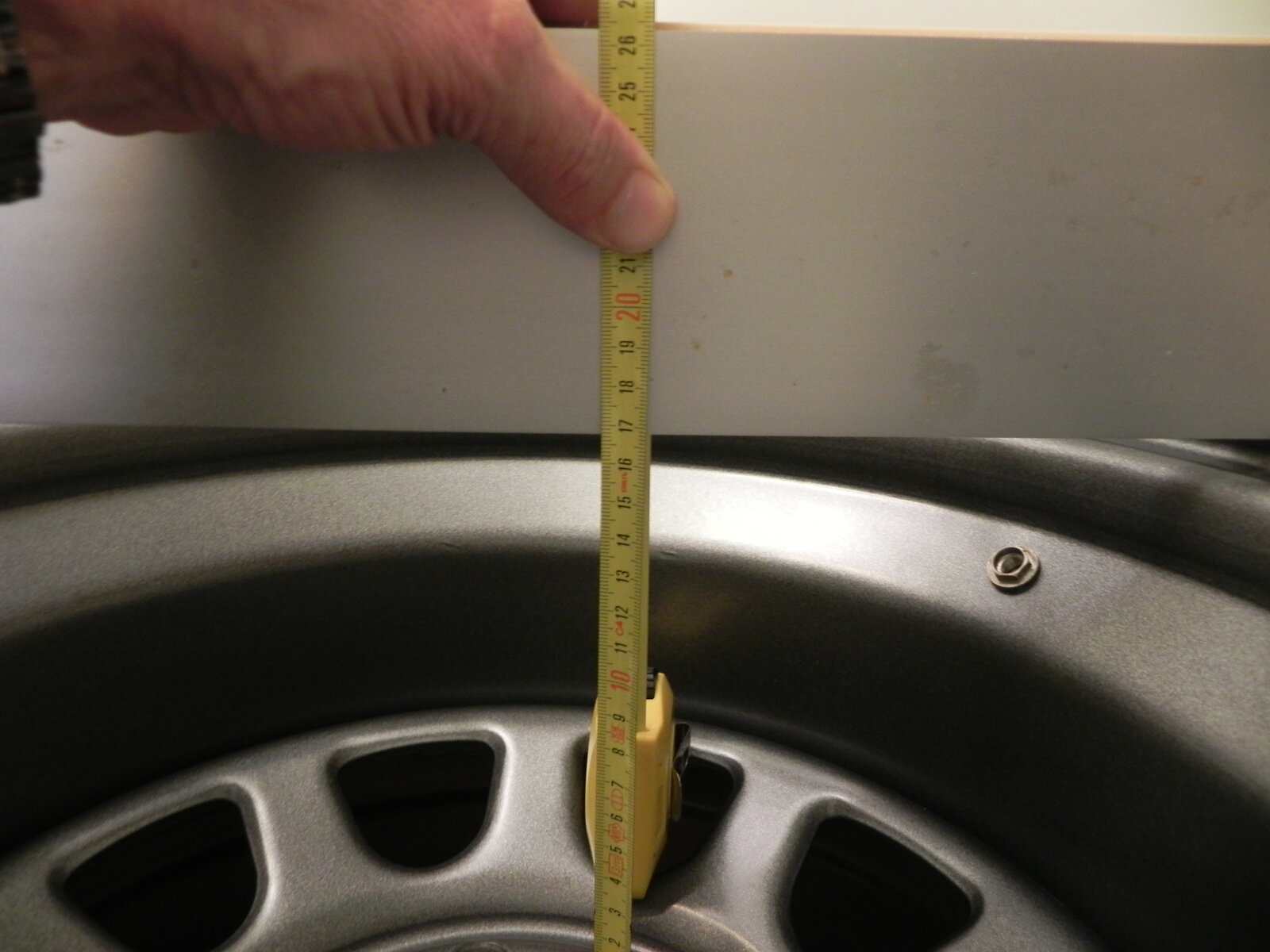

With a straightedge, I measured rim edge to centre on the outside = 168mm
I measured rim edge to centre on the inside = 104mm
Would it be correct to take the total width (rim edge to rim edge) = 278mm, divide it by 2 = 139mm and deduct this from the outer dimension of 168mm = 29mm
Would this be known as -30 offset?
What would be the backspace, 104mm?

Too tired to even try to work it out but my first thought was -32 is a more common offset and i wonder if the thickness of the rim might have something to do with the unusual 29mm ?
Jap modular 16x10 -32 should not be difficult to find
Is it not written on the wheel i can see 16x10 ???? ???? ? 10 9 2006 on there .
Negative offset brings the wheel closer to the curb , i think backspace is what Americans (and LR people) call offset .
Bloory 'ell Shayne you've wrapped it all up in one (3 actually) post :lol: :clap:
I've been searching for ages and I can find 16x10s but with no reference to offset, here stated as ET (whatever that is)
TBH -30, -32, its close enough for me, like you say, the difference could be half of the thickness of the steel which appears to be about 4mm.
Thanks matey, this is great, the link even has the same stamping pattern, the "D" shaped holes :dance:
