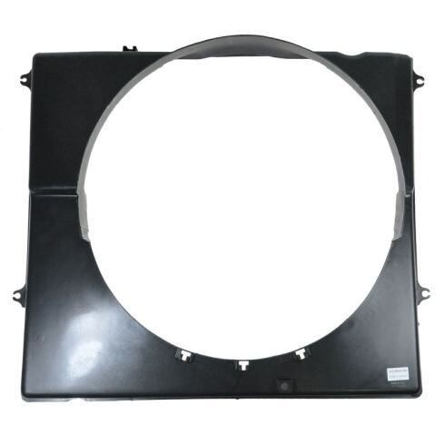

Okay guys, ive had my new to me 2002 series 78 troop carrier and I have a cooling issue. The good news is I know what it is. I have the 1HZ engine, but unfortunately the fan that connects to the fly wheel and shroud is missing. There is a cheap chinese electric fan bolted onto the radiator and its just not enough cooling at highway speeds. Under 50 mph running the AC im good, but on the highway I have to turn on the heat, and where I am (Panama) thats not alot of fun. My question is should I scrounge and look for the parts, or upgrade to a 4 row aluminum radiator with a dual electric fan set-up?

So i installed the clutchfan yesterday, and even without a shroud it cools better than the dinky electric fan. Im going to build a shroud out of aluminum over the weekend :) such an awesomely simple truck!!!!

I put on the stock fan clutch and tossed the electric one. I dont have the cowling for it so the fanclutch is exposed but seems to be running fine with the AC now at highway speeds. I do want to upgrade to a 4 row aluminum radiator though.
Get the shroud it makes a world of difference keeping the engine happy.and cool - I also want to upgrade to an aluminum radiator and an intercooler .
The fan is redundant at speed thats why it has its own clutch , it goes into free spin .
Off road or around town there is little airflow to cool the radiator and so the fan engages .
