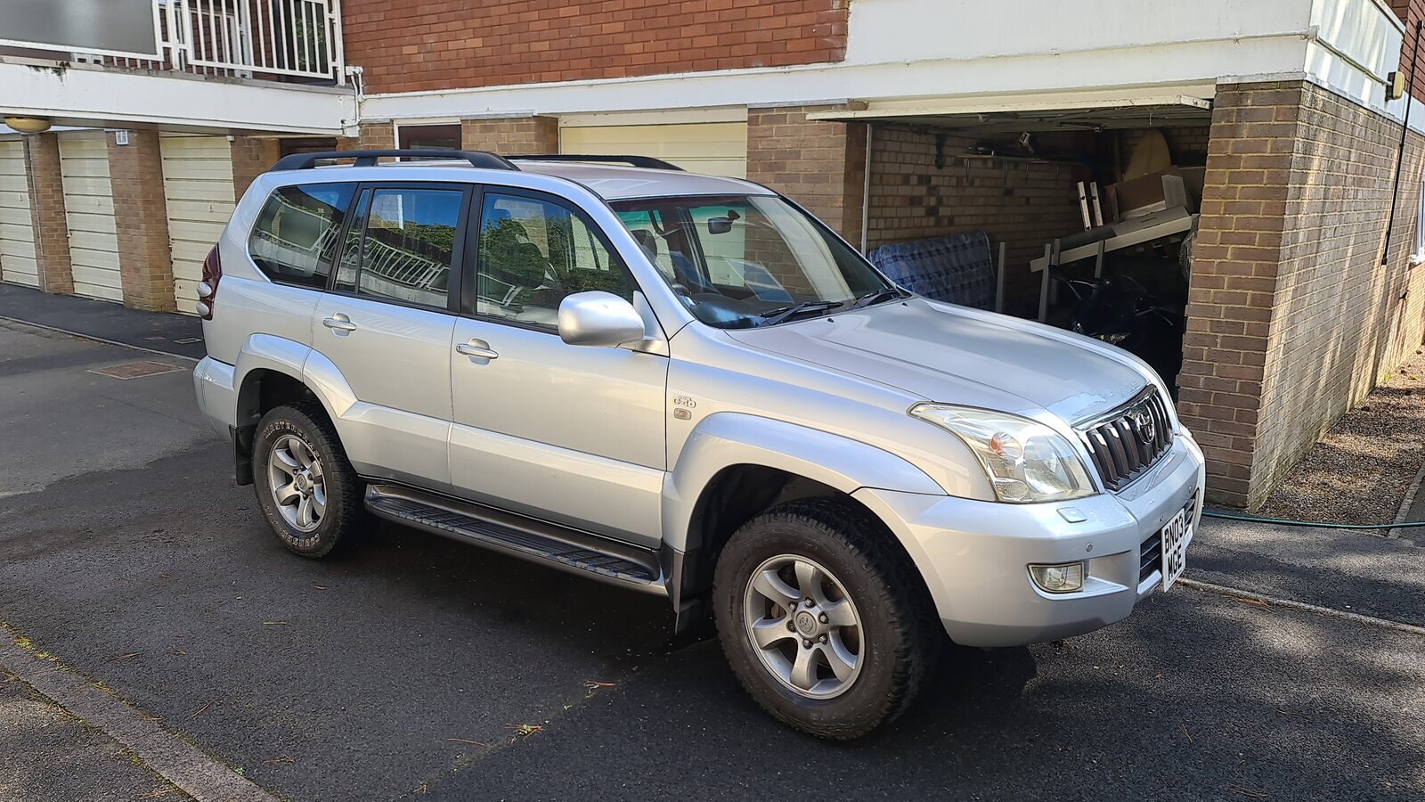

Hey guys,
Just had my 2003 lc3 prado land cruiser dropped off today. It's got 96000 miles and one previous owner.
Outside and inside are absolutely mint.

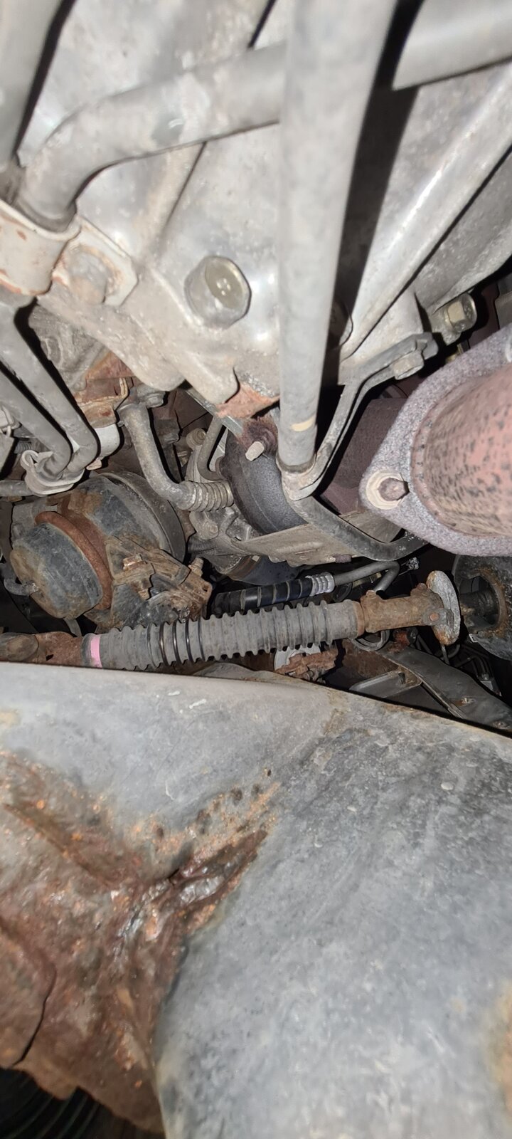

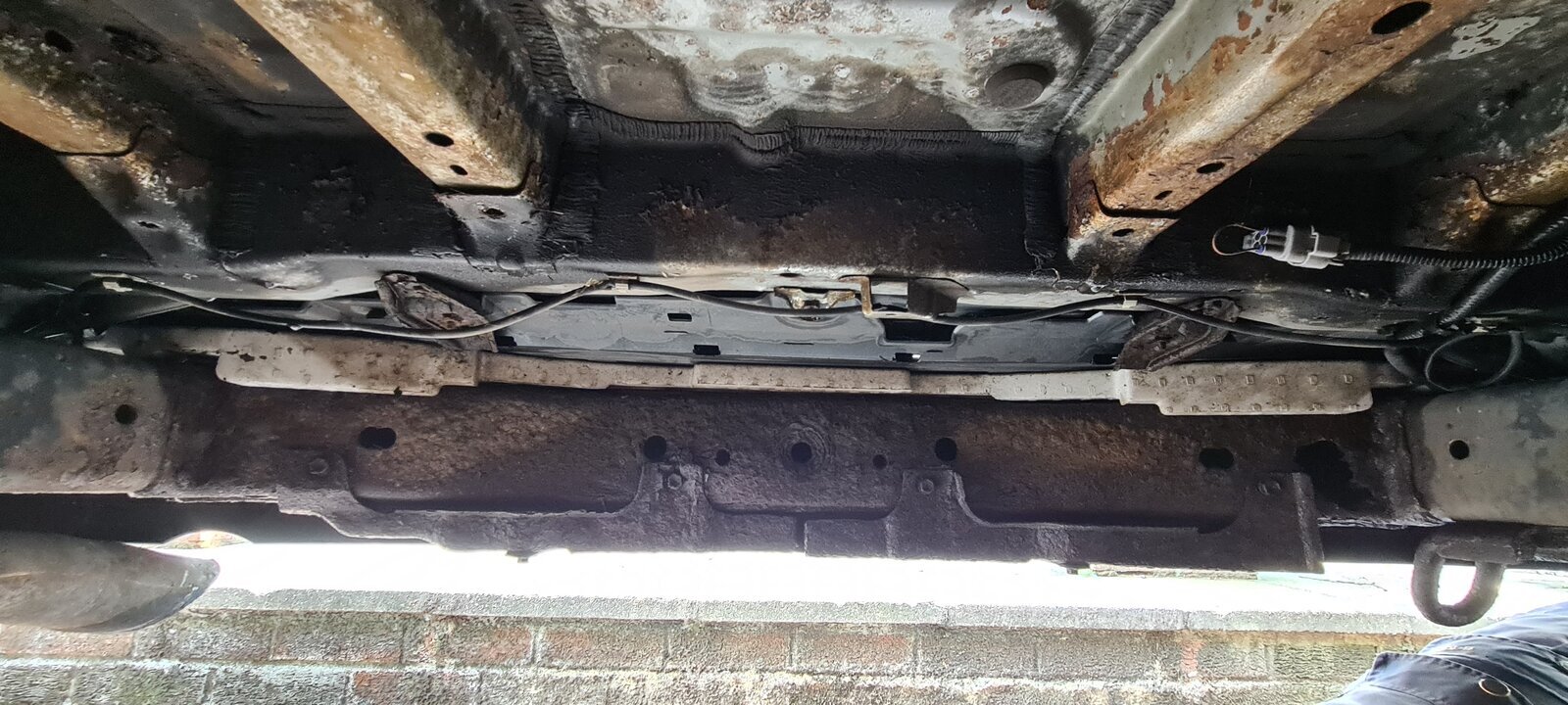

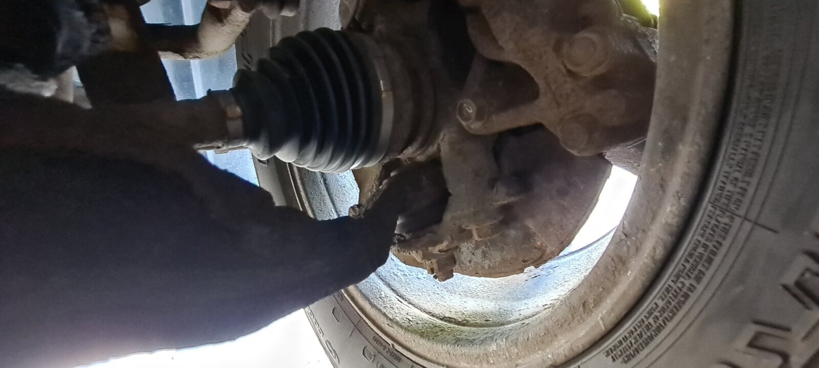

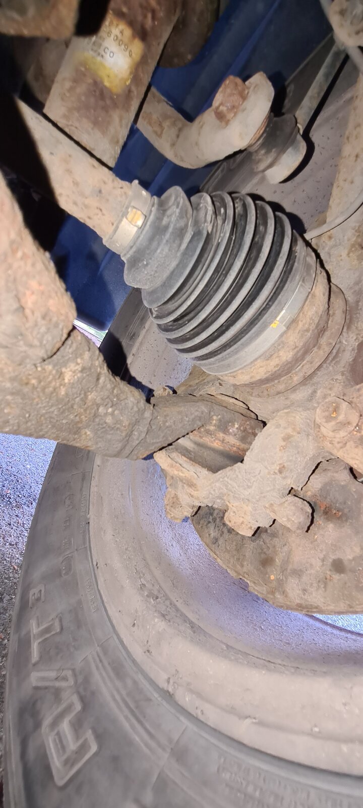

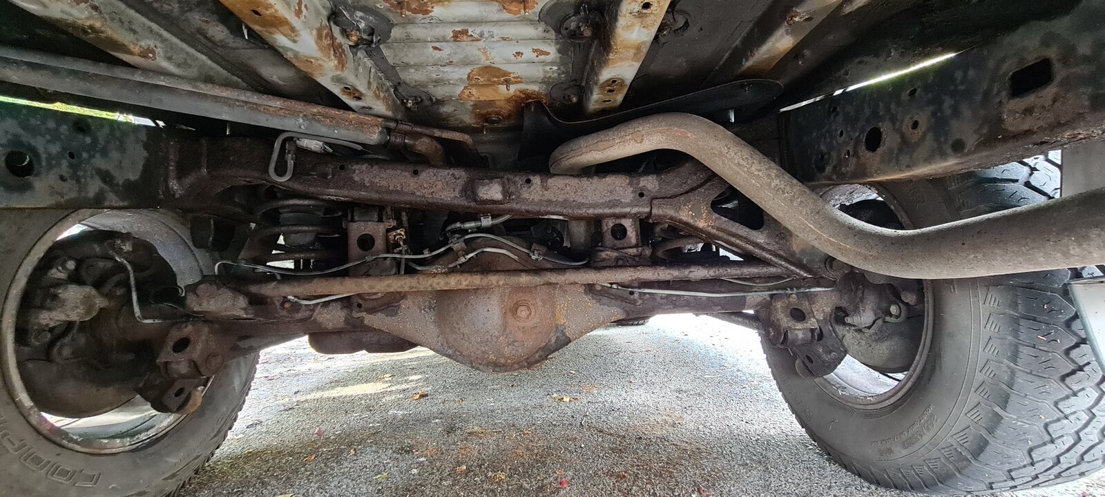

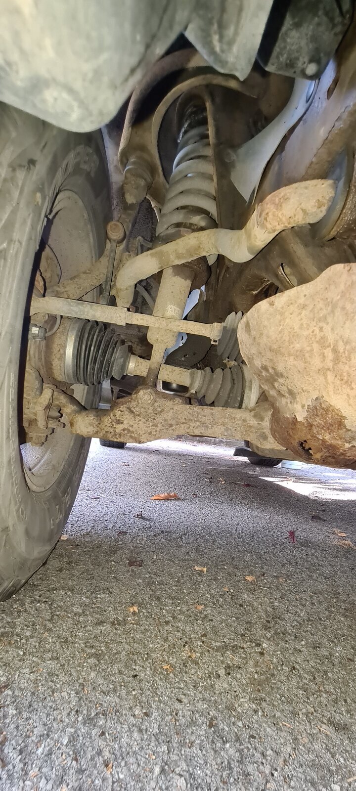

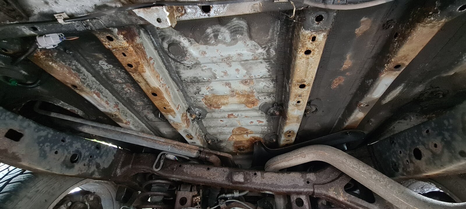

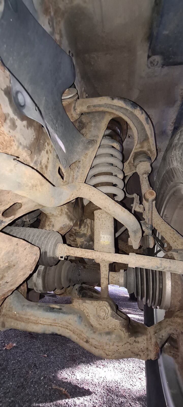

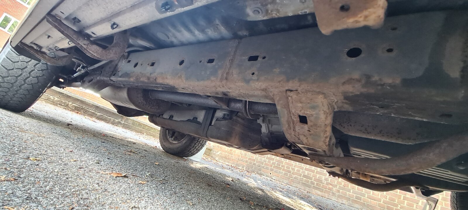

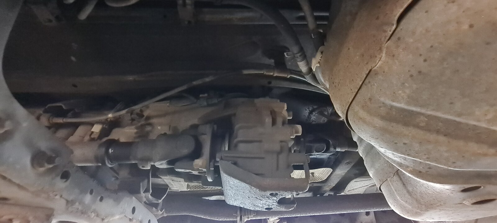

Now underneath is absolutely covered in surface rust but that's to be expected on an 18 year old I suppose. I spent a good hour underneath it today poking and hitting as much as could with a hammer haha! Couldn't put a hole in anything except for the rear cross beam between the two rear chassis arms. Not sure if it will be weldable or need replacing but I don't think it's too much of a big deal ? The chassis as a hole is bombers. No misting on the bottom of the turbo which was nice. Most of the rubber bushings all seem to have life in them too which is nice.
The engine is nice and quite even when cold but I suppose the injectors will still need doing shortly.
Has anyone ever tackled a full cleaning and rustproofing? I'm going to be taking it to a rust specialist next week but I really want to do as much work on this as possible as it's a project for me to learn and build.
I'm under no illusions that all the corroded bolts will be a right pain in the ass when it comes time to put on a lift kit haha!
Here's some photos from underneath after a jetwash.
Looking forward to speaking with you all in the future as I build this into a decent overland/greenlaner.

Most of that is surface, as you said, and it maybe worth sending a few hours under there trying to get that back to metal before doing anything. A lot of rust converters seem like acquired taste, many swear by them, others prefer to just sand it down, add a protective layer and get on.

Looks like a nice car! Whatever you use to protect it, its 90% about preparation. The more of that you can do yourself the better, than you know whats been done.
Where's the bit you poked the hole in, is that in the pics? Sorry if I missed it.
I think a few hours with a wire brush (or a slow speed angle grinder with a brush attachment) would work wonders, then you can see what you're dealing with.
That 120 must be the only one in the UK with factory paint left on underneath, especially at that age, what a find ! As said whatever is used prep is paramount. DON'T just paint over it as it is, with anything.
A good detergent pressure/hot wash to get rid of oil, salt grime etc, will be a good start, then thoroughly dry before attacking rust.
You will need all sorts of wire brushes/drill attachments to get in the various places, so be prepared to put loads of time in and get mucky. As karl2000 said, the only way to make sure its thoroughly done. Karl and I have just spent a very long time under ours doing that, and using different metods and products.
The join on the front crossmember shown looks suspect, but may look ok on clean up, and yes, the rear crossmember needs attention/replacing, with the rot ? on the r/h side.
You may want to consider removing the rear bumper to save labour costs. Mine fittings were like yours, 2 brackets tore off, and a few bolts snapped, which involved more work and bits to get back on. You will have to put it back on to drive over there, as lights/indicators in bumper on your model ?? But it will give you access to rear crossmember, and involve minimum labour costs to you for someone else to struggle with it. These 120s seem to rot from the inside out, too many holes in chassis and floor stffeners, which run the length of the vehicle, and also sills.

Yeah the rear cross member will need welding at a bare minimum. Will report on the front when it's cleaner but did seem soild. Hopefully that's it. The hole was in the bottom right as you looked at the picture.
