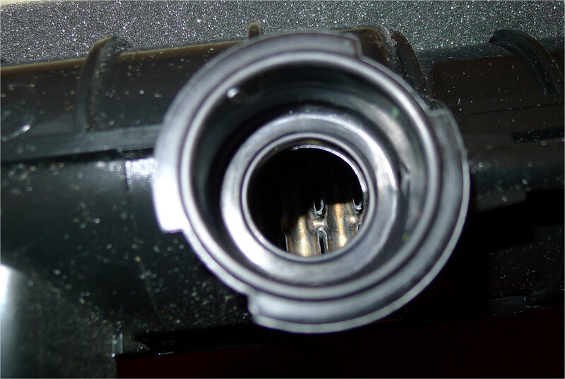

Also a technical question - by 3 core what do you mean, I assume it means there are 3 cores in depth, whereas 1 core means just 1 core in depth running top to bottom?
I would like to buy off Milners, to support a company that supports LC owners.
Pete
Pete
Imagine the rad in place.
All cores run top to bottom, single or 3 core.
The difference between the two is a single core is one elongated 'hole' running front to back. A 3 core has three 'holes' one behind each other front to back.
Have a look at the photo below and you can just see two of the cores, I couldn't get all 3 in the shot at the same time:-

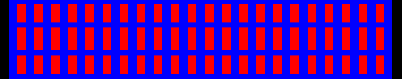

Please excuse this question from an ignoramus, but what difference is there between single core and three core, do they pass different amounts of water? obviously a single core is cheaper to produce than a three core, but if the volume of water passed is the same then the cooling capabilities should be similar :confusion-confused:
Chas its all about surface area to volume ratio, the higher it is the faster the rate of heat transfer. A single core rad may hold more coolant than a 3 core rad, this to some may mean that the single core rad can store more heat energy and therefore is better. But what is the point of that when the primary function of the rad is being a heat exchanger i.e. to transfer heat energy from one flow to another? A larger volume of coolant with less surface area means that you get a lower heat transfer efficiency. As you need to remove heat from the engine you would be better off with the 3 core rad due to higher heat transfer efficiency, especially in hot places like northern Africa. Think of everything that needs to be cooled, they all have large surface areas like computer heat sinks. Compare this to things you want to keep warm like boilers for your hot water, they have minimal surface are to keep the water hot.
Simple thermodynamics. :ugeek:
Rob was doing the theory while I was playing with the 'crayons' :D
Imagine cutting the top off the rad and looking down onto it.
A single core can only disperse it's heat through the sides of each core.
While a 3 core does the same + it disperses heat between each of the 3 cores
Hope this makes sense?
Thats great, its what I thought it meant, but best to ask if not sure.
