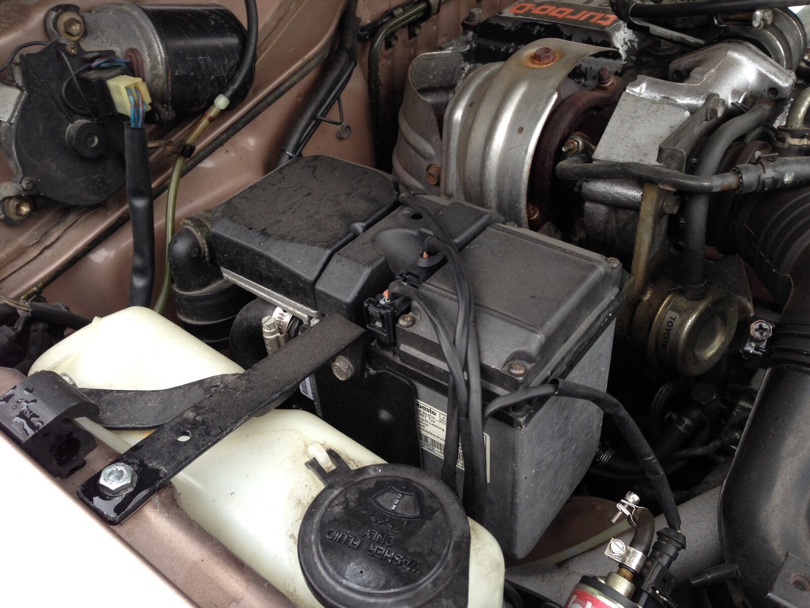

Installed a webasto, thinking that would help....
it does work, but when u crank the engine, the injection pump thinks the engine is hot and gives low revs....so I need to twist the rpm knob or gently press the pedal.

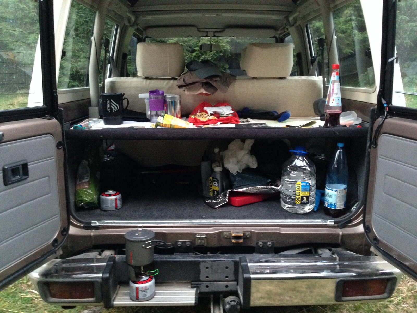

installed a shelf to keep things organised somehow

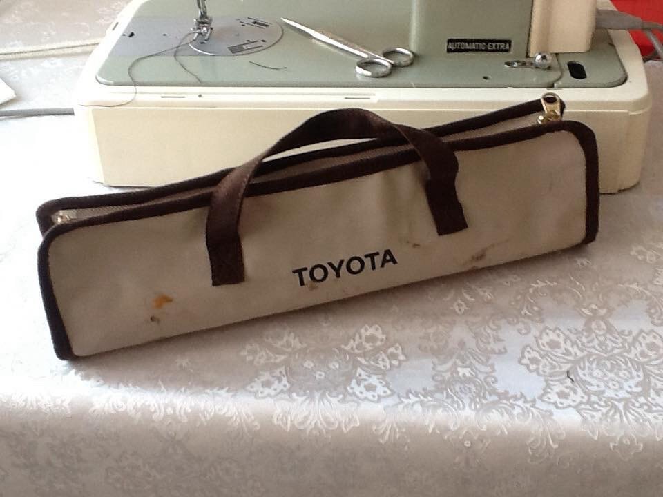

and found the unused tool box in the wheel arch...but chewed by a mouse...
so had to use the stitching machine a bit...:eusa-shhh:

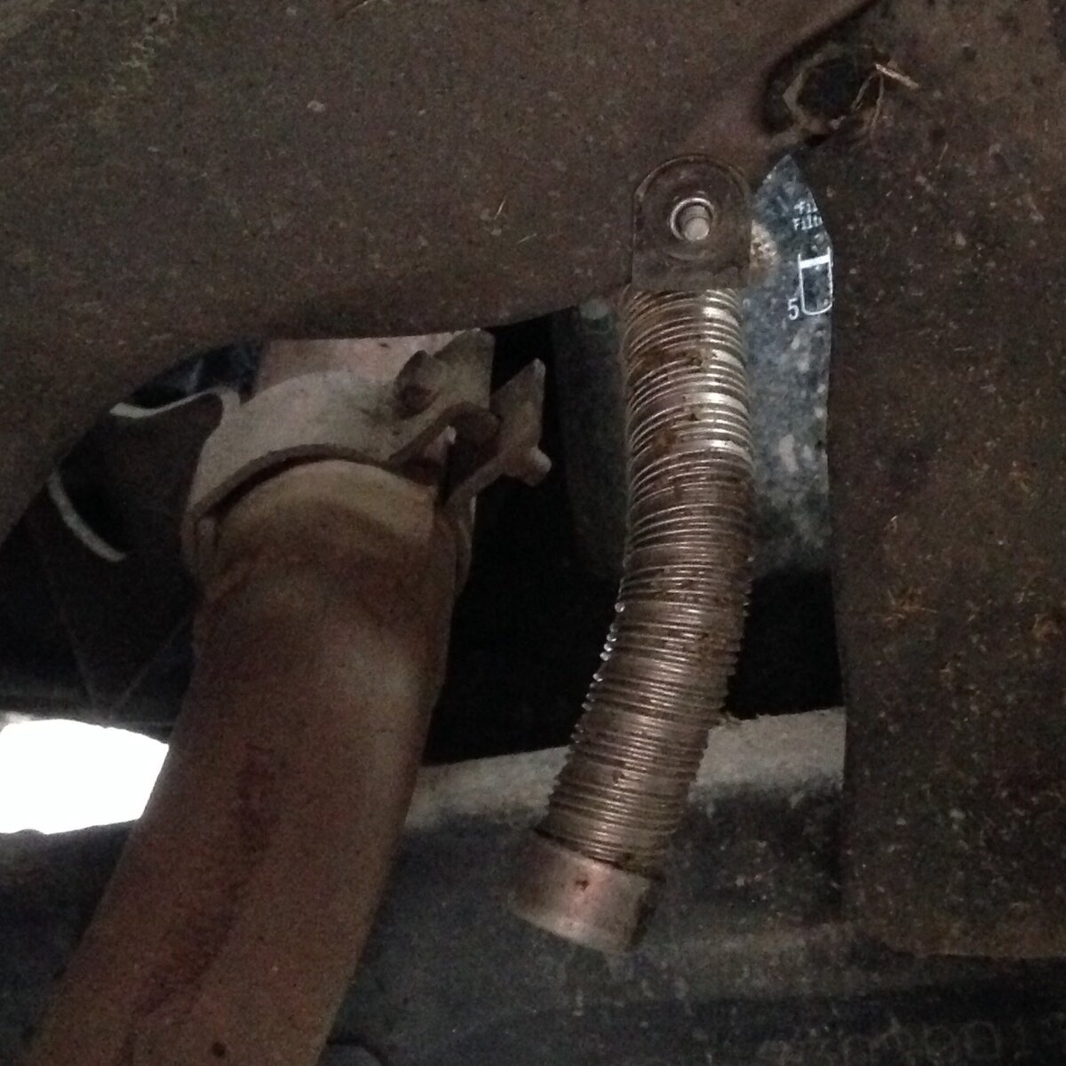

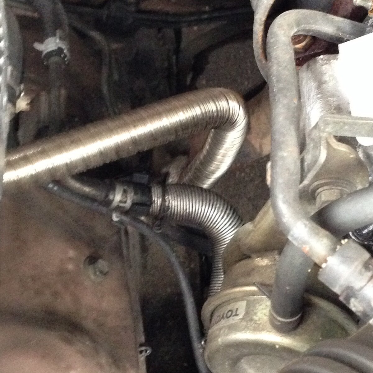

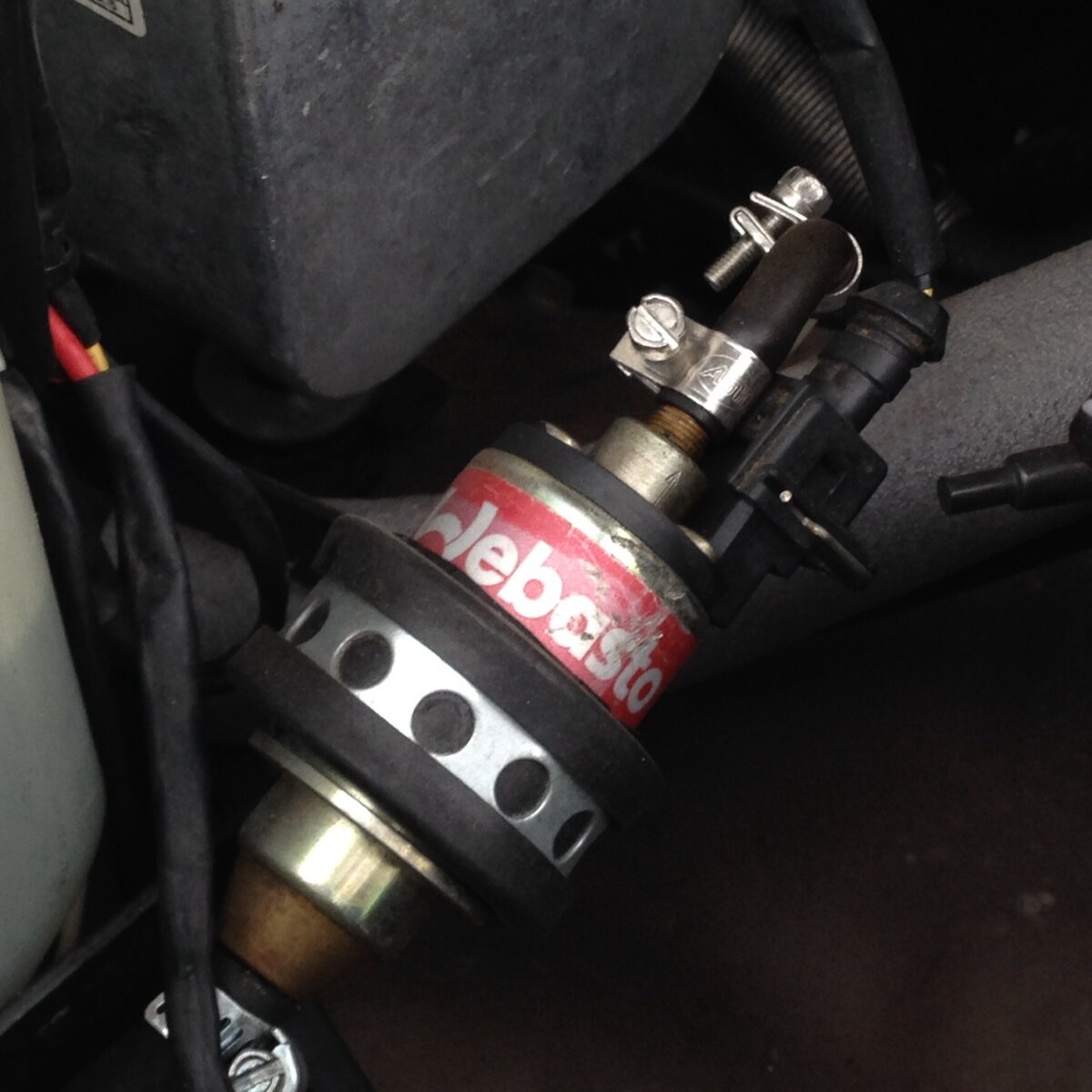

thats webasto rigging,
works ok, only flexible exhaust seemed be ok with the engine vibration
heat lever needs to stay switched on, otherwise there will be no coolant flow to the webasto and it will enter shutdown loop.

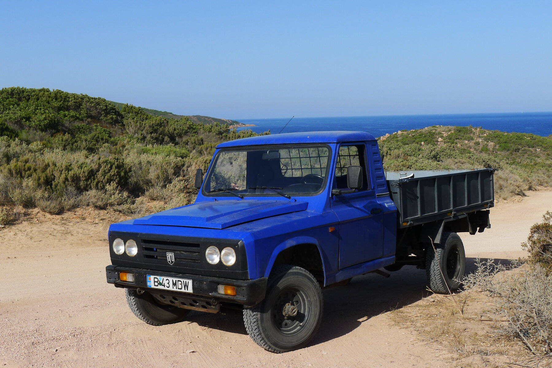

Im driving a romanian 4x4, a blue cabin flatbed at the minute...
