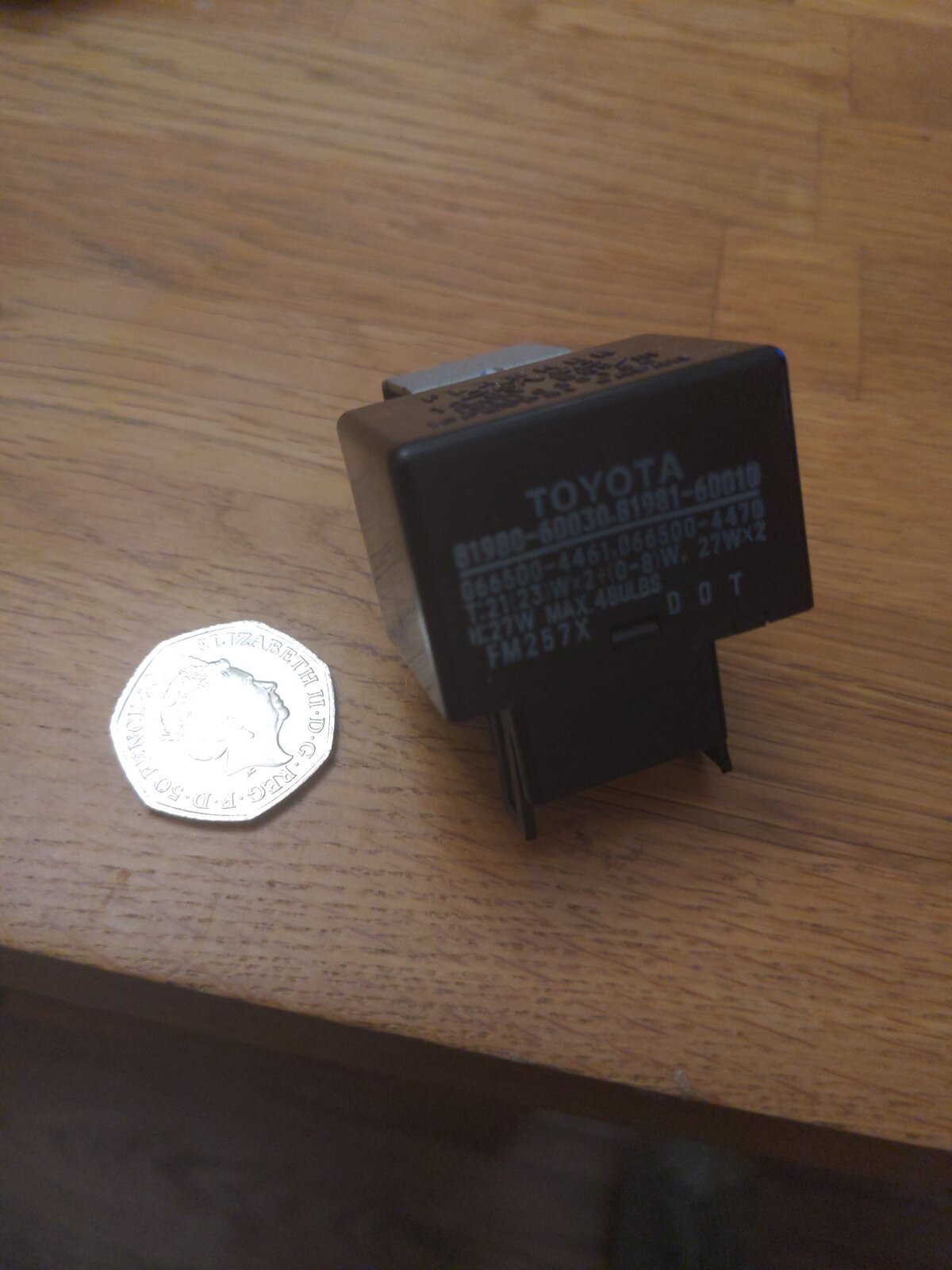

So out of the blue on sat/sunday my indicators and hazards have stopped working, I get no lights at any corner or the side. Immeadiate thought was the fuse, fuse ok, swapped with another known working fuse and still nothing.
Removed the relay and bought a 2nd hand one and fitted that, still nothing. do i take the plunge and spend £107 on a brand new one from toyota?

Checked all my bulbs bar the 2 side ones as it started to piss it down. They were all fine. Beginning to think I need a new relay to rule that out.
Have you checked its not a common/Grounding issue like the chap on IH8MUD site.... Just hoping it could be something simple.... Sorry (Edit) iv just re read the last post again on the ih8mud site... Yes it sound like the relay........... Good luck
Struggle to see how it could be as a number of systems share the same found and they work??? Maybe a bought a dodgy second hand relay
The last post says, he bought two new controllers, both turned out to be dodgy... They sent him a Third and Hey presto everything worked.... Im guessing when the say controllers they mean Relays
Not sure what the relay looks like on these, but personally at that price id try and do some testing with a multimeter first.
Just basic stuff - is the signal getting to the relay to switch it? Can you jumper the output of the relay to see if the lights turn on and therefore rule out anything beyond the relay?

if all your tests pass, the relay must be buggered.
You could also test the relay separately, using a 12V supply.
