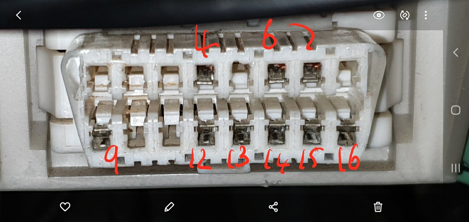

I saw this video on YouTube regarding using an a Autophix 3210 ODB2 dongle on a 120 -
My 2006 LC4 won't work with this, so mine isnt OBD2 compliant, but obviously some 120's are.
My connector has pins in positions 4, 6, 7, 9, 12, 13, 14, 15, 16 - see attached.
Looking at Which OBD2 Protocol Is Supported By My Vehicle? - OBD Station - [Leaving Land Cruiser Club] that doesnt correspond to any OBD2 protocol.
Anyone got a 120 that works with OBD2, and if so what pins does your connector use? I assume it needs a different ECU to make it work?
(I was thinking it would be nice to have torque pro dials up on an android auto headunit!)
I have a 2009 120 invincible and it works on OBD2 its connector pins use number 4,5,6,7,9,12,13,14,15,16 so the only difference to yours is I have pin number 5 in use as well as your pins that are used .

I have three of those handheld OBD2 scanners and they all work on my 120 and its a UK spec 120
Anyone tried strapping pin 4 and 5 together as that seems to be the only electrical difference?
So much for this idea - just tested two bluetooth dongles and those pins are strapped together in the dongle anyway!
