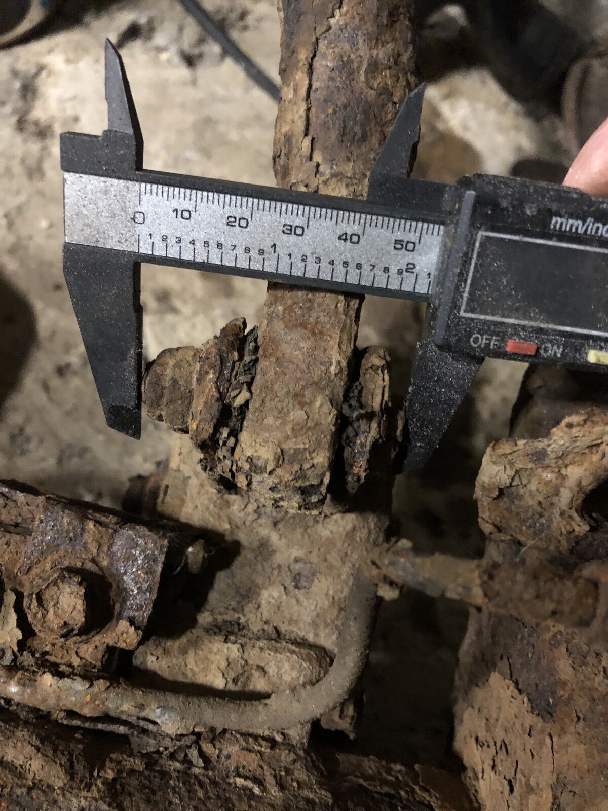

The sway bar bracket to chassis bolts are m8, same with the D bush brackets, and then connecting to the axle they are m10.
Length wise, the new generic m8’s I used had 20mm of thread.
Bolts axle end, I’ve just measured an original bolt on my old axle, overall length is 55mm.
They don’t need to be high tensile or anything fancy.
