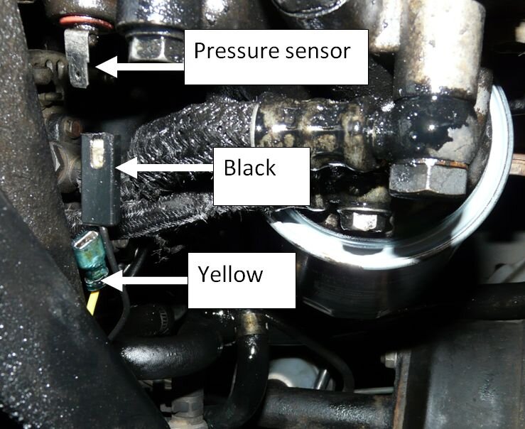

I discovered that I have knocked the wires loose (when removing the alternator) that connect the oil pressure meter on the dash to the oil pressure sensor.
My problem is that there are 2 wires. Both of them reach the sensor and fit the connection. I cant see any other places for these wires to attach to, other than the pressure sensor. I tried plugging them both in (one at a time), checking the oil pressure gauge on the dash, and revving the engine while checking the gauge again on the dash.
I found the gauge on the dash did not move when the yellow wire was attached. When the black one was attached the gauge on the dash shot up immediately to well past high (and off the meter) and slowly dropped down to low after a 1 minute or so.
Are both of these wires supposed to connect up some how? Did the sensor have a double male plug thing??
one is the low oil shut down, the one without the notch in the clip.
the other is for the "bell" on the oil pressure sender.

The gauge works on very low amps and if you attach the wrong wire they burn out real quick and I suspect this is what you have done.
They go for around $70 at the wreckers.
You may also have a problem with the sensor,you can usually get them from parts stores for about $30-40.Lots of Toyota cars and other models of landcruisers use the same sensor or sender as some call them.
