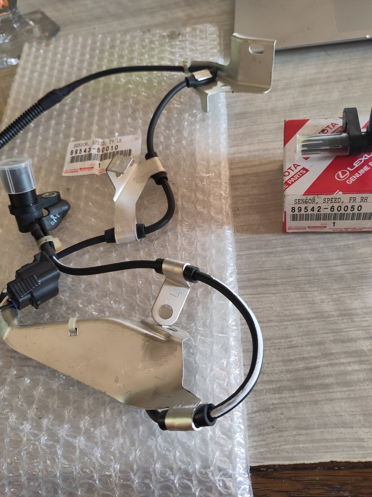

Wanted: 80 series Dec1992 HDJ80R VX 4.2 ABS front sensors (both sides) - needed urgently for May MoT
I have tried to find new sensors for my LC80 - I think the part nos are:
Front sensors LH 89543-60010
Front sensors RH 89542-60050
but I ordered these from Amayama Trading in Japan, using my VIN, and what they sent me was wrong. I haven't been able to find these anywhere else...
Please Help!!!

The bracketry on those looks like 100 series, and that's what shows up for those part numbers.

Unless you're planning on returning the 100 series sensors to Amayama, couldn't they be modified to fit the 80 series or are they a totally different, size and shape etc? An ABS sensor is just a magnetic pickup with a bit of wire and a plug
