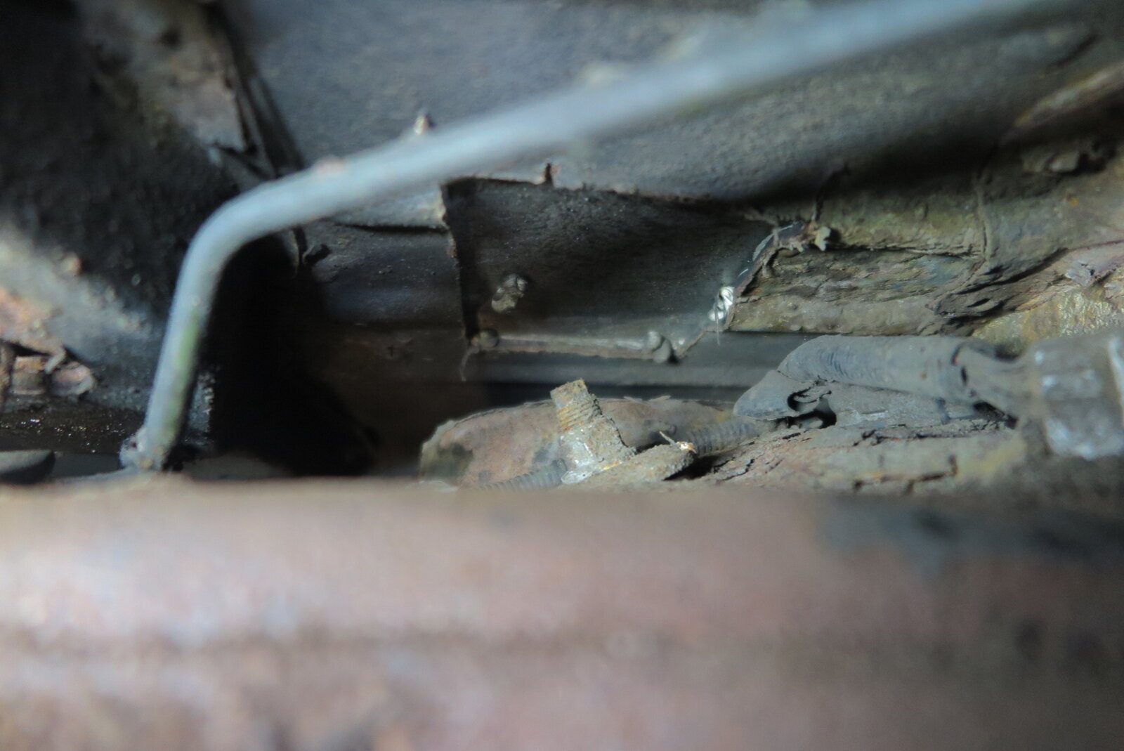

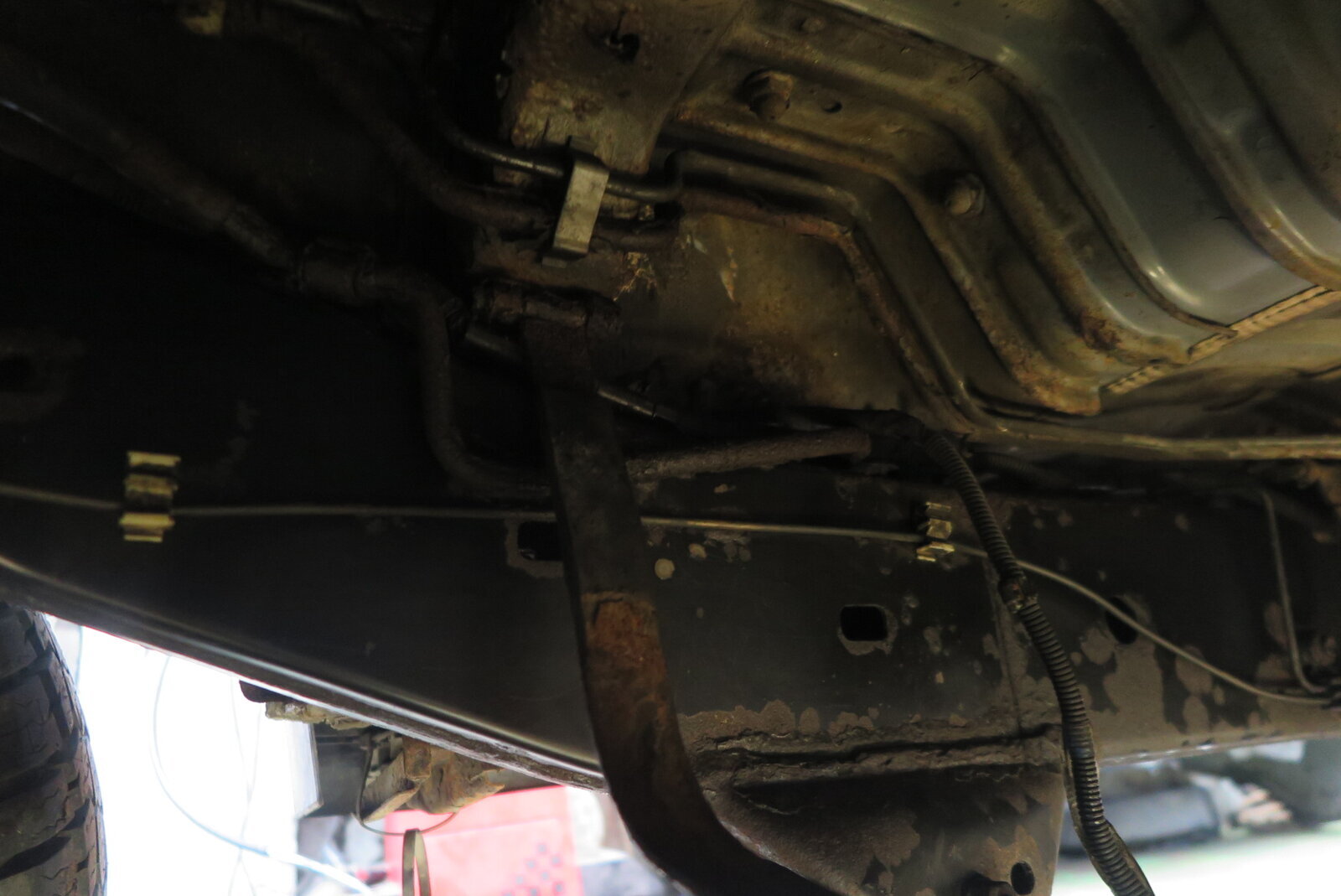

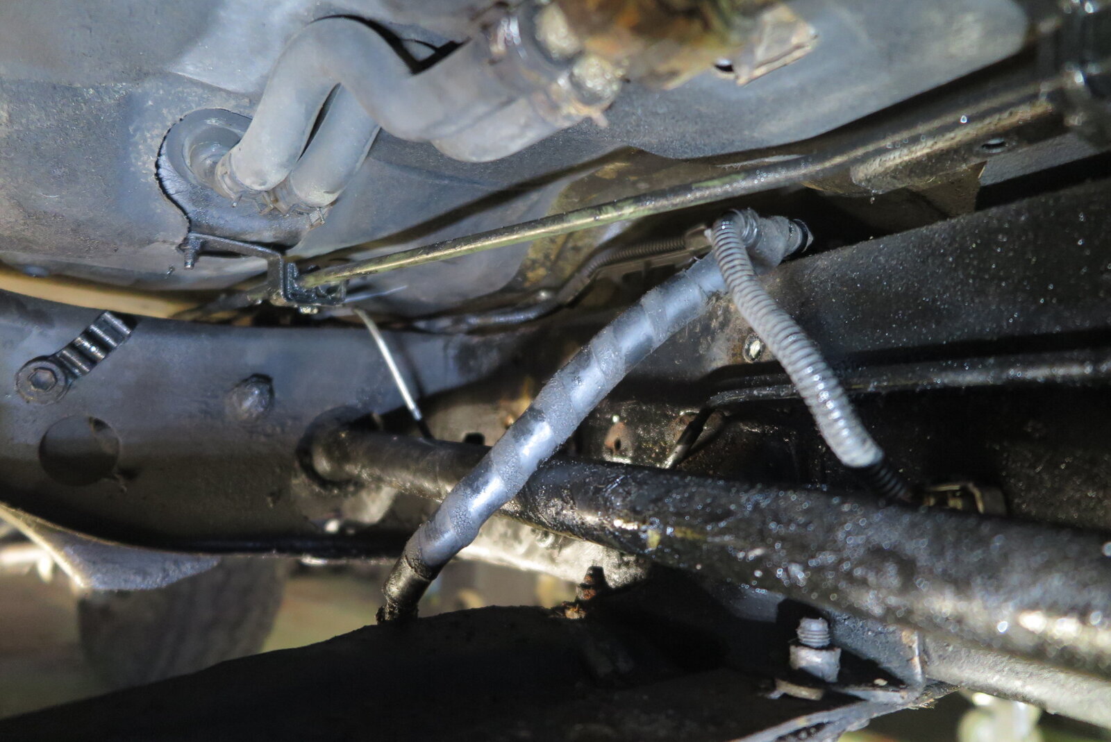

I have noticed that there is only one hydraulic brake pipe to the rear axle, I would have thought that it would have had a dual system to the rear, one pipe to each corner. With removing all the AHC gubbings, plumbing and wires, there is now a lot of clean room down there so I am contemplating running two pipes and hoses, only contemplating?
Pictures of the NSR with the fuel tank removed. All the steel fuel pipes will be replaced with clear braded hose. I will replace that brake pipe with a better fit, this one was obviously done with the fuel tank in place.

Afaik, only the newer 100s with anti skid/spin had two pipes, two circuits, for the rear brakes. The master and ECU are also different, with separate control for the two rears. I suppose it is not easy to convert to the newer, 4 circuit master, and that you would have to change several ECUs. As it is, you and me have only one outlet for the rears on the master (atrac came later on the diesel), so I can't see the benefit of splitting that outlet into 2 pipes running to the rears.

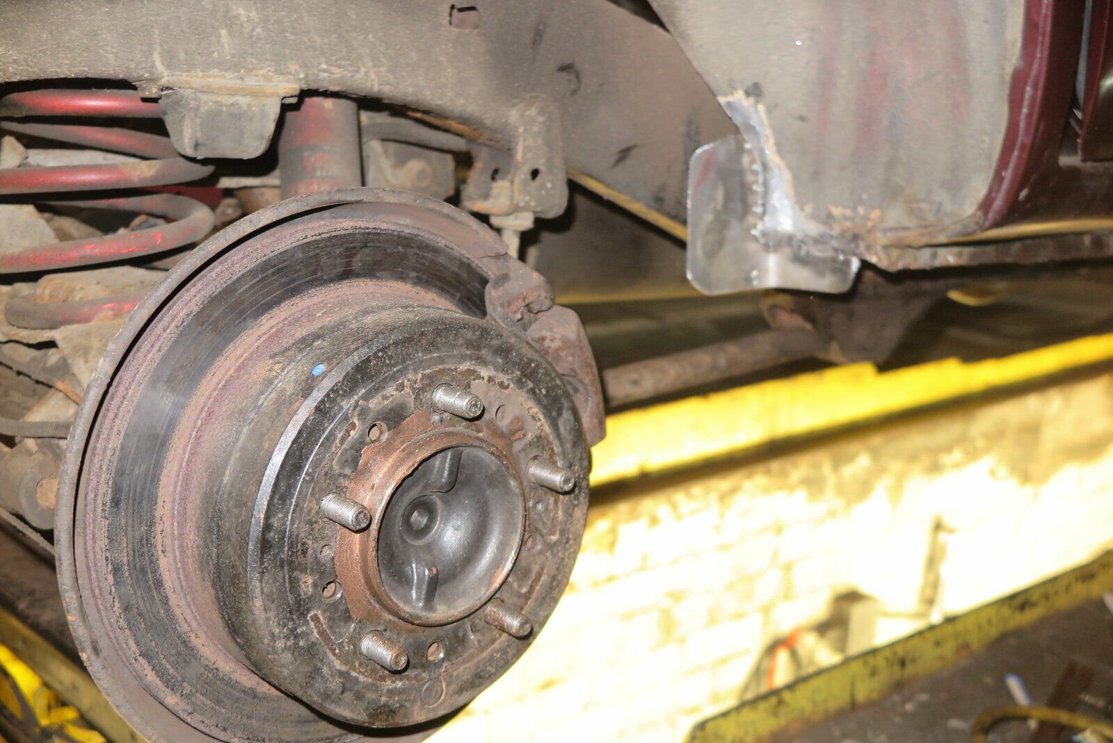

Well, I have stripped and cleaned up the parking brake. It adjusted up nicely so gave it a test. Park brake on and in gear, it would not set off so I'm happy with that after the 'Disco III Screaming Banshees' as it is commonly known in that fraternity. How nice to have a proper hand-brake that ratchets on and works with confidence. Play the Ennio Marraconi.

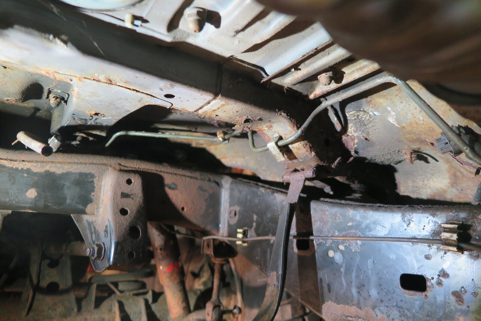

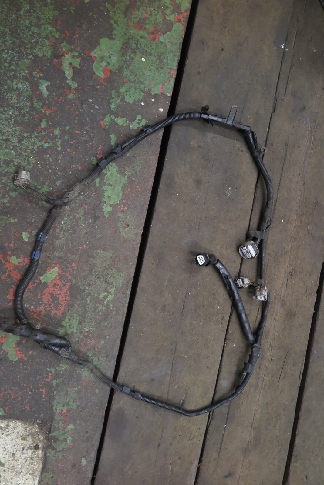

The other interesting thing is after removing all the AHC Metal-Work, (bye-gum there was some weight in and among all that stuff). All the cable trunking along the NS chassis is for the AHC. From under the NSR passenger floor there is the one cable for the fuel sender unit. So I've removed the AHC cable as pictured from the central control unit to the NSR shock absorber top. There are two multi-plugs there and this is where the ABS from the NSR wheel feeds in. That cable is like a net holding all the road crudd on top of the chassis. Glad to remove all that stuff. Going to work along OS chassis next and see what can be removed as 'surplus'?
