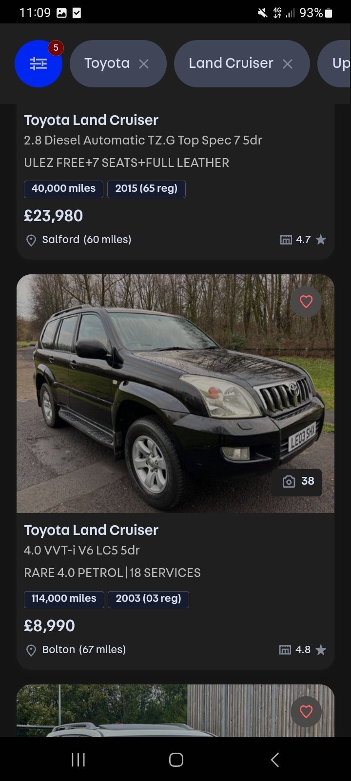

I'm interested. Any thoughts lads? I'm in Portugal for a few more weeks. It's in much better nick than mine.

Yes, underbody is where its all at, underbody corrosion first mentioned in 2018, only a close examination to decide how bad.
I had a browse the other day, quite surprised how cheap some 120's are being advertised at, a 2 minute browse on the MOT history soon explained, rust rust and more rust.
Notice some ads deliberately avoid showing or actually cover up the reg plate, am i the only one who wouldn't even bother to go look at one that's obviously hiding the MOT history unless it was literally around the corner.

Going back to the 03 one above, in the real world it's a £3-3.5K car, although it's rare, it's old and seen a fair few winters. JMO.
