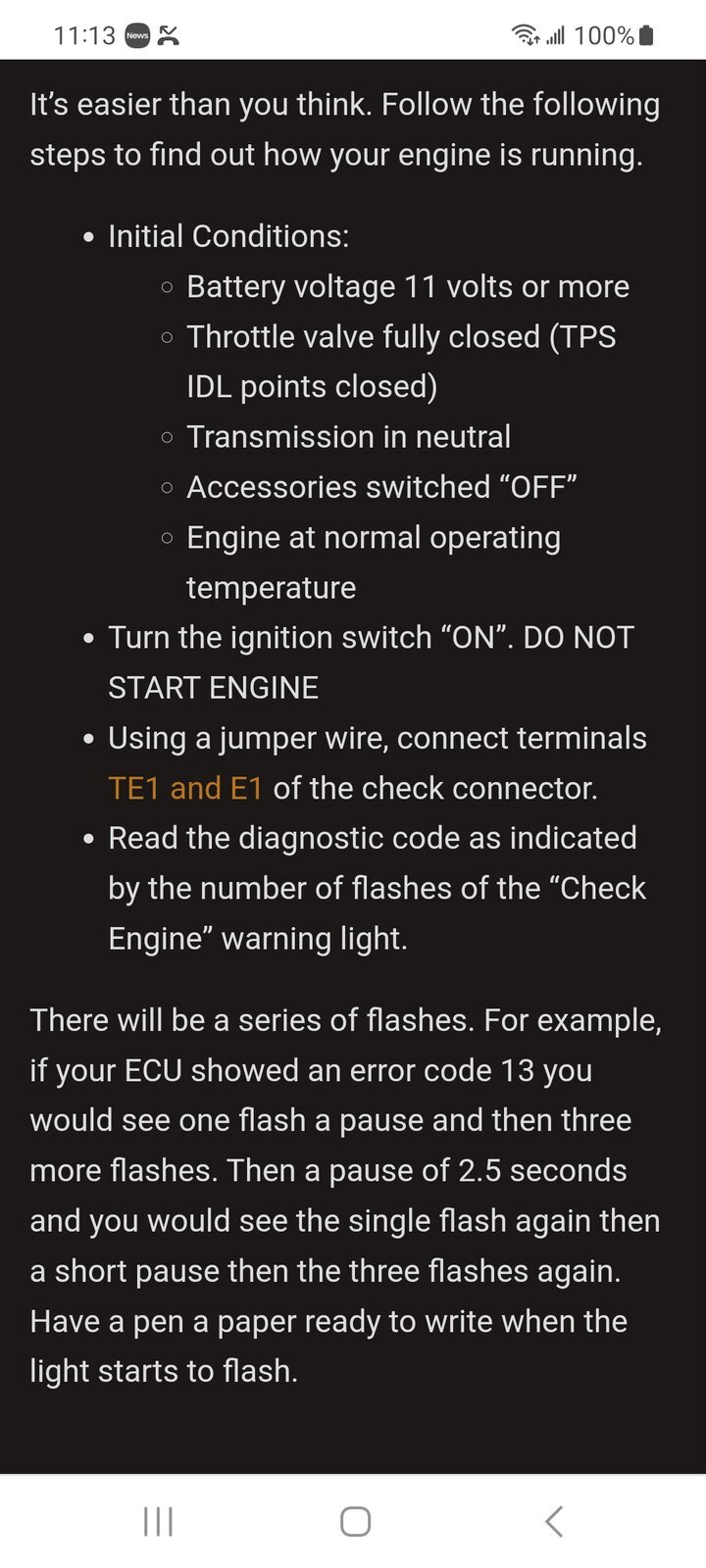

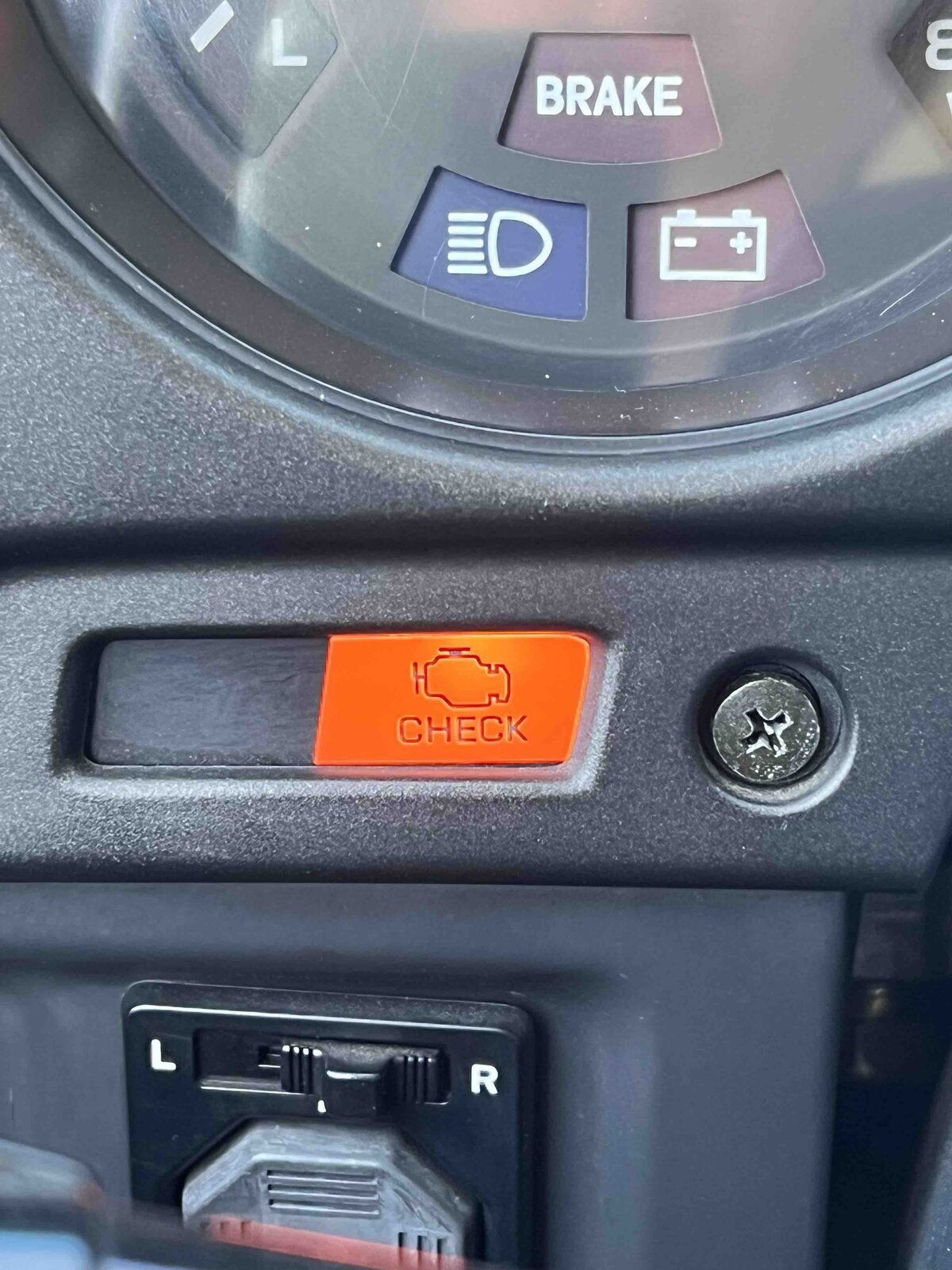

I had one problem with my FJ62.
The check engine light came on.
When I start the engine after a short time, it is off, but after 10 minutes of driving, the light comes on again.
Can you tell which parts of the car show problems?
I would like to take it to a auto repair shop, but I'm wondering if they can fix it with regard to a slightly older car like mine?
I would very much like to know if there is anything I can think of.
Thanks
