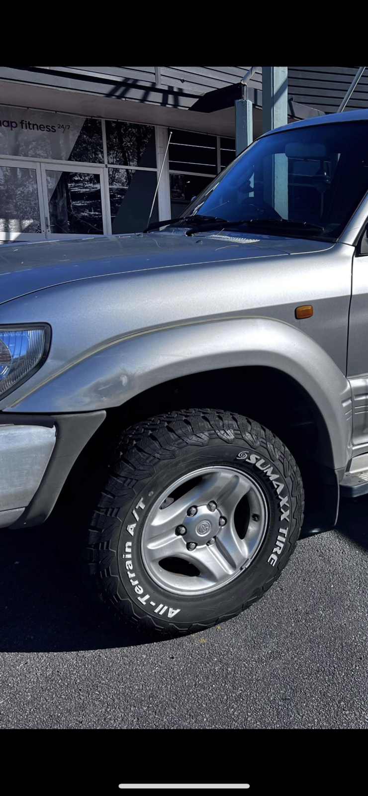

The tires are pretty new, I've attached a pic

Your just learning to drive a proper 4x4 is all , taller and heavier so they don't handle like a car . No ABS in the scrapyard junk i learned to drive in which is why i hate abs , at the first slip all my instincts scream at me to ease off the brake to maintain control . But of course i should instead scream like a girl stamp both feet on the brake pedal and go into a steering frenzy while abs lets the car travel about 4 times further into trouble than it would if it didnt have abs .

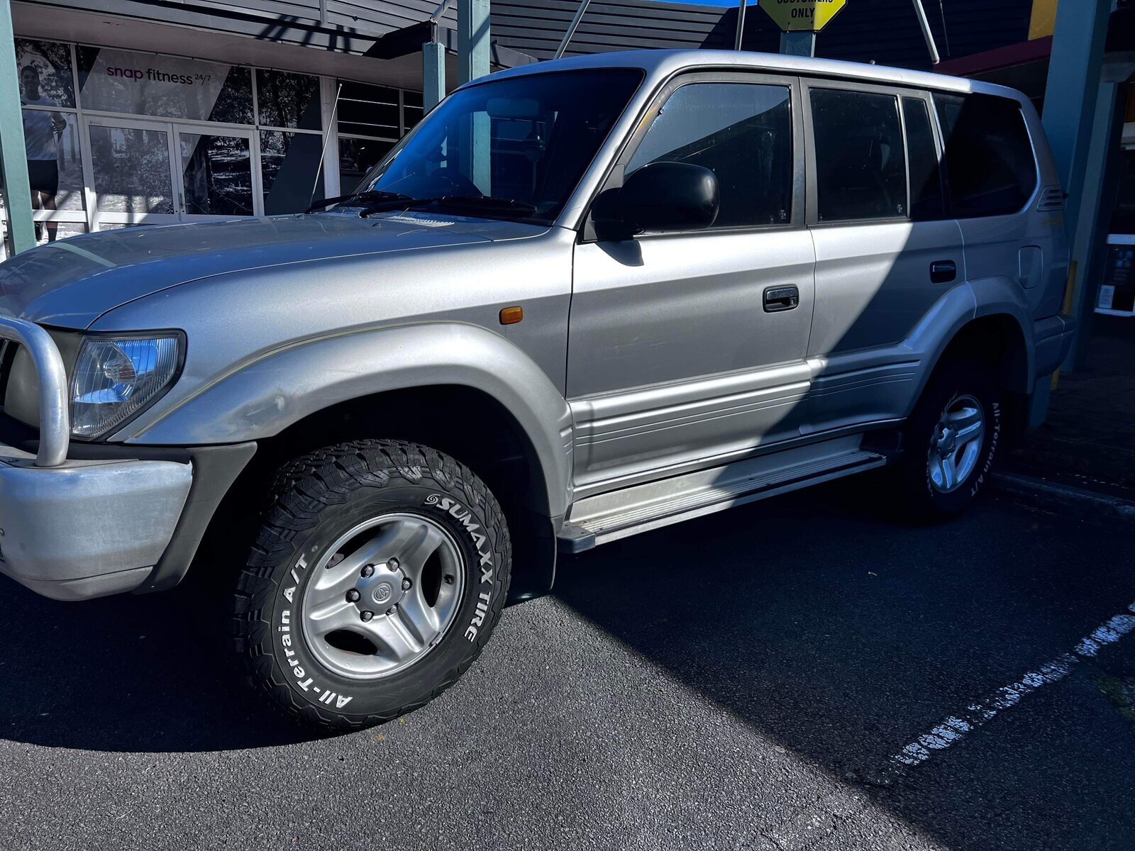

mines not quite ready for the full off road trip just yet, although it has been lifted which is nice to not have to worry about, roof rack will be ordered next week as for some reason I have to go into the store to get it delivered to the store, can't just do it through the website, and then maybe a snorkel

You will come to love it i'm sure and the things that alarm you now you will soon recognize as character :thumbup:
