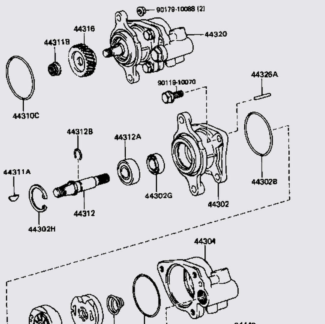

It's on the pump itself which you can get to by removing the front wheel then the vertical plastic mud guard.
I think if you have that solenoid switch on the steering box you won't need and don't have power idle up. You will be fitted with pps which is purely a hydraulic system operated by ecus which detects vehicle speed and increases the power steering the slower the car goes. Engine power up is therefore not needed.
The pps system is described in RME-184 :-
SR- Steering
SR-28- Description of pps- Not all cars have it.
SR-56- Exploded diagram of steering box including pps solenoid location.
SR-65- pps system chart/diagram as to how it works. No vacuum nor idle up involved.
I have pps on mine so won't be looking for power up any further.
Does anyone have the alternative power steering system (not described in RME-184 that I can see).
Towpack do you mean your pps solenoid is on top of your steering box and not your psp.
Just sitting down to lunch Frank so I'll post some up in an hour or so.Hi Towpack
Pictures would be very useful so I can determine whether or not I have the power idle up. If I have it's never worked and the car was only 3 years old when I bought it. It's a 1995 VX 24 valve.
