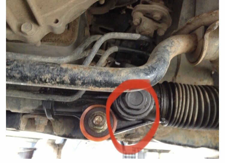

Hi, I have oil drop at the bottom of the rack big nut shown below. Is there a seal within the assembly? Power steering reservoir still full. But want to be cautious, thanks.
Note: picture not my car. Didn’t have my phone with me while under the car so have to get an internet picture.

The big nut is the rack adjustement nut which allows the tension on the steering rack to be increased or decreased.
I can't remember what the set-up is inside it but there are some old threads with photos I vaguely recall.
You could try tightening up the big nut, but don't overdo it otherwise your steering willl become very tight and no longer self-centre, though it's easy enough to back it off a bit if you do. THere is a locking ring around the outside but that is almost impossible to loosen so just concentrate on the big nut in the centre.
It is brownish oil, should be power steering. Not the distinct Auto trans oil smell.
I probably agree. Watched a Timmy the Toolman YouTube video that replaces the guide and there is no seal in there.
Does this mean that the seal within the rack is knackered?
Might try the Lucas power steering stop leak and see how it goes.

I would thoroughly clean and degrease the whole area, then run the truck for a week or so, so you could be more sure where any fresh leak came from. Then you can be sure what area to focus on. Check your power steering fluid level though.

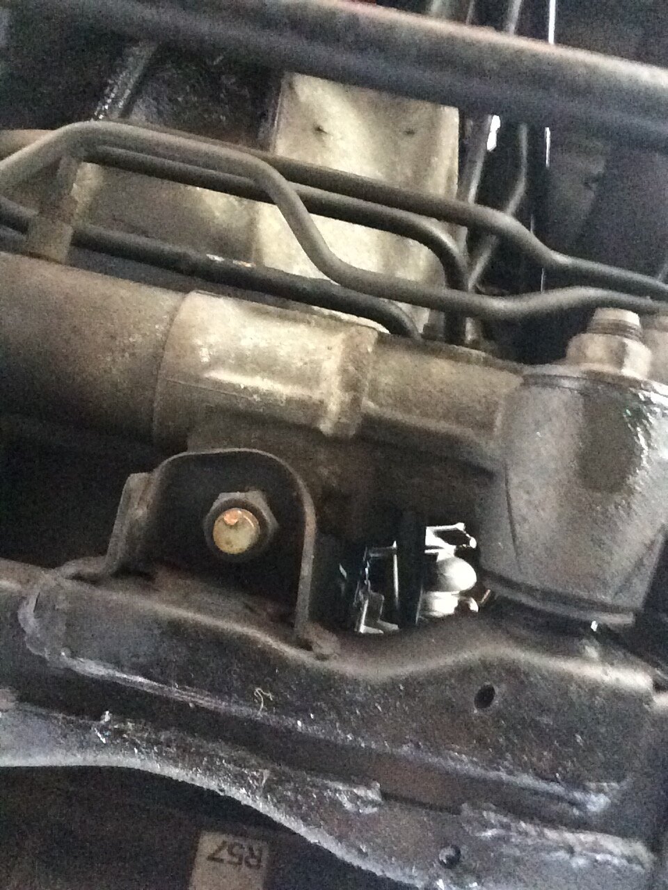

When I first got my truck, there was a leak from one of the driveshaft seals on the front diff. I suppose the gear oil would get flung off the driveshaft and blown backwards. It used to drip from the steering rack- see photos. You may have already found the correct culprit but oil has a habit of spreading and appearing to come from something else. Just saying - be sure you are chasing the right thing.

Thanks Beastrider for the photos. I will clean and double check. I have replaced one of the leaking CV seal last year but this is on the other side of the rack.

Hmm. Not sure. It could be leaking from the point where the steering column entres the rack, which is on the opposite side of the big hex nut. Of course it's possible to refurbish a rack and replace the seals but I was advised by my old mechanic that it's rarely worth attempting unless you're an expert and have access to the right tools. I don't know whether that's a fair assessment but I know it would be beyond my abilities! If it were me I would try the stop leak stuff and if it doesn't work budget for a refurbed rack. I had a squeaking rack once and partially replaced the fluid by sucking it out of the reservoir and replacing it with new, doing that several times with lots of turning from lock to lock between top ups and that seemed to work well, with no need to undo pipes or anything.

Cheers diggerdave, I will cross check again. After looking at photos from the net, as you said, the entry or joint between the column and rack could be a likely leak source.
Quite likely of the bushes have gone. With engine off, lie underneath and have someone waggle the steering wheel side to side. There is supposed to be something like 1mm of movement. Quite a common age-related failure. If it waggles about all over the place then quite possible that the quite delecate little series of seals that DD mentioned have had a work over. I rebuilt mine a long tome ago. Quite fiddly.
