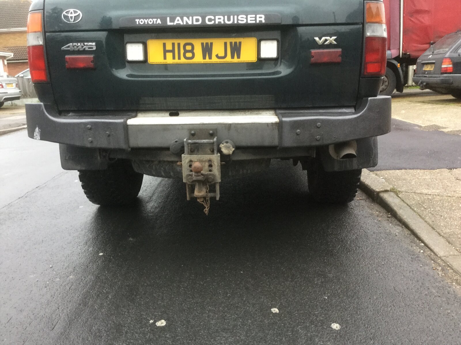

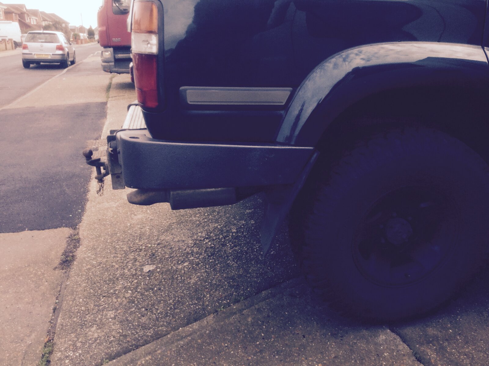

hiya, I wanted a rear bumper so as to look quite original and I had these made from heavy gauge steel and they are mounted on the chassis at the leading edge, so they will take a side impact, I will use the original bolts at the back to mount a plate for a spare wheel/ jerrycan carrier as per the normal layout, this might give you an alternative idea, how original does it have to look? That's the factor, mine often get confused with original bumpers, but not by enthusiasts.
