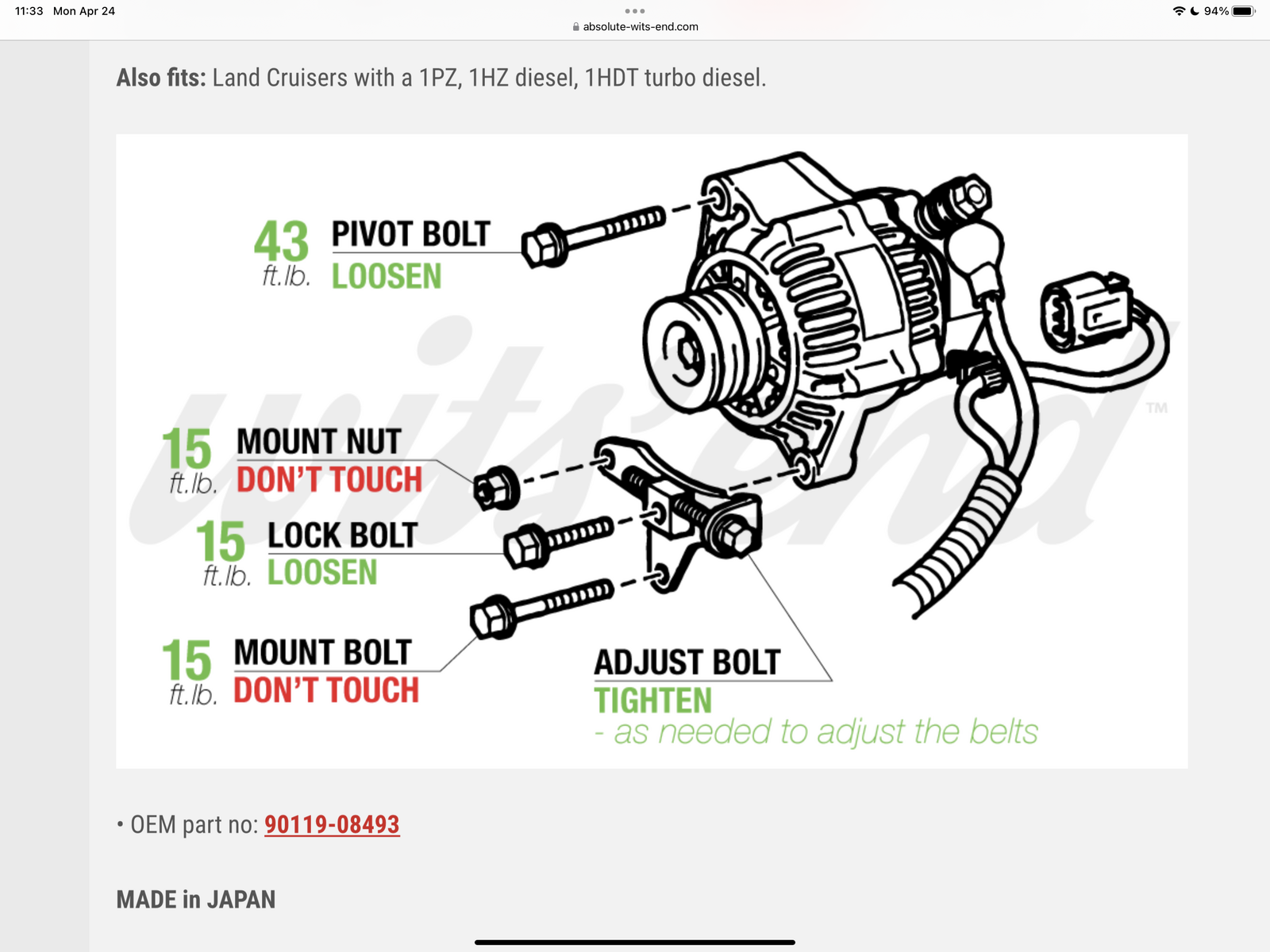

The alternator tensioner has 2 bolts that take few minutes to figure out how the tension work.
At this point, while you there, replace the 2 alternator belts.
The alternator also has a pivot that is underneath the alternator with a bolt that should be loosened as well. Care should be taken with the tensioner bolt, I snapped mine because I didn’t loosen the lock bolt first.
