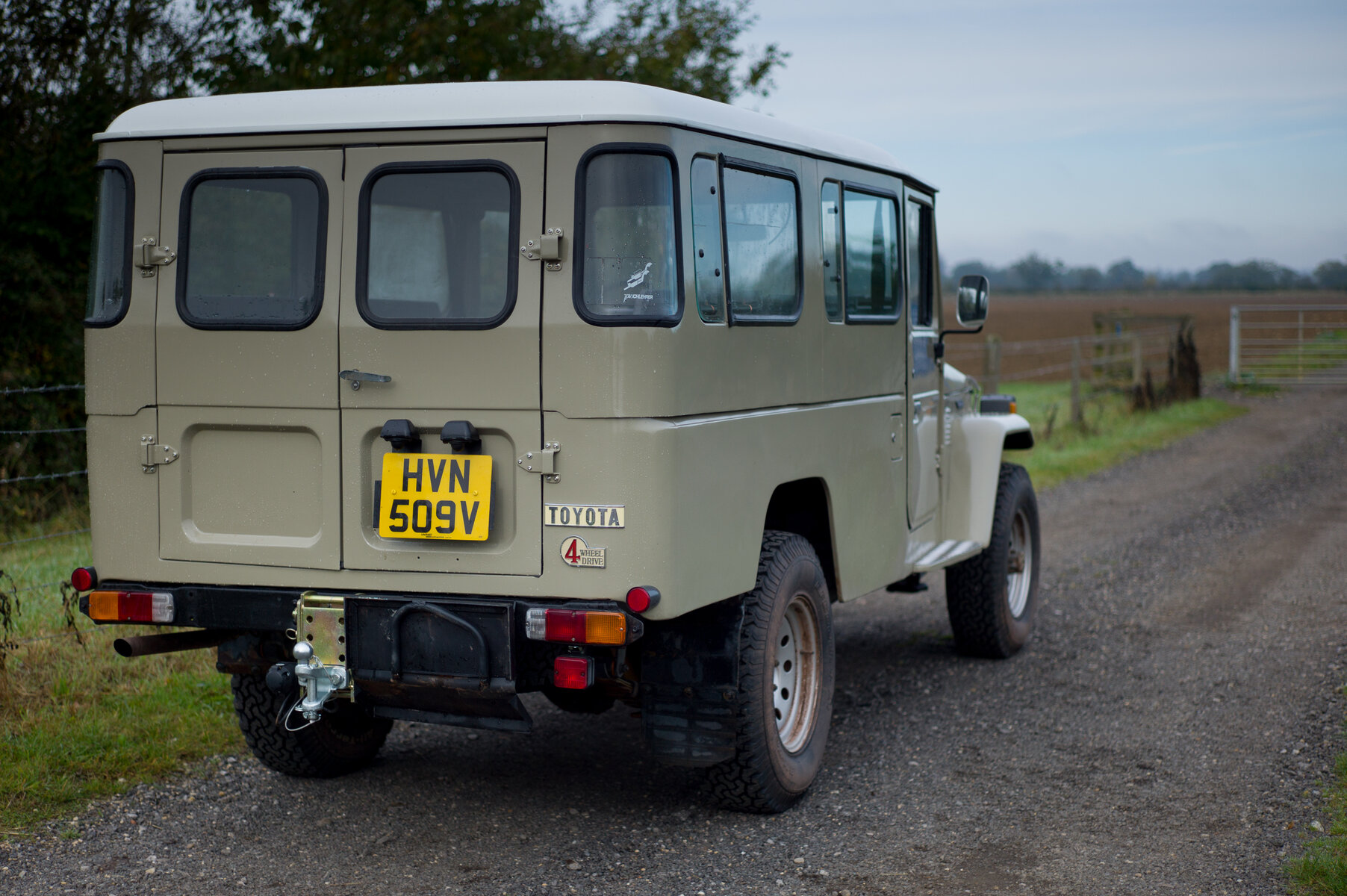

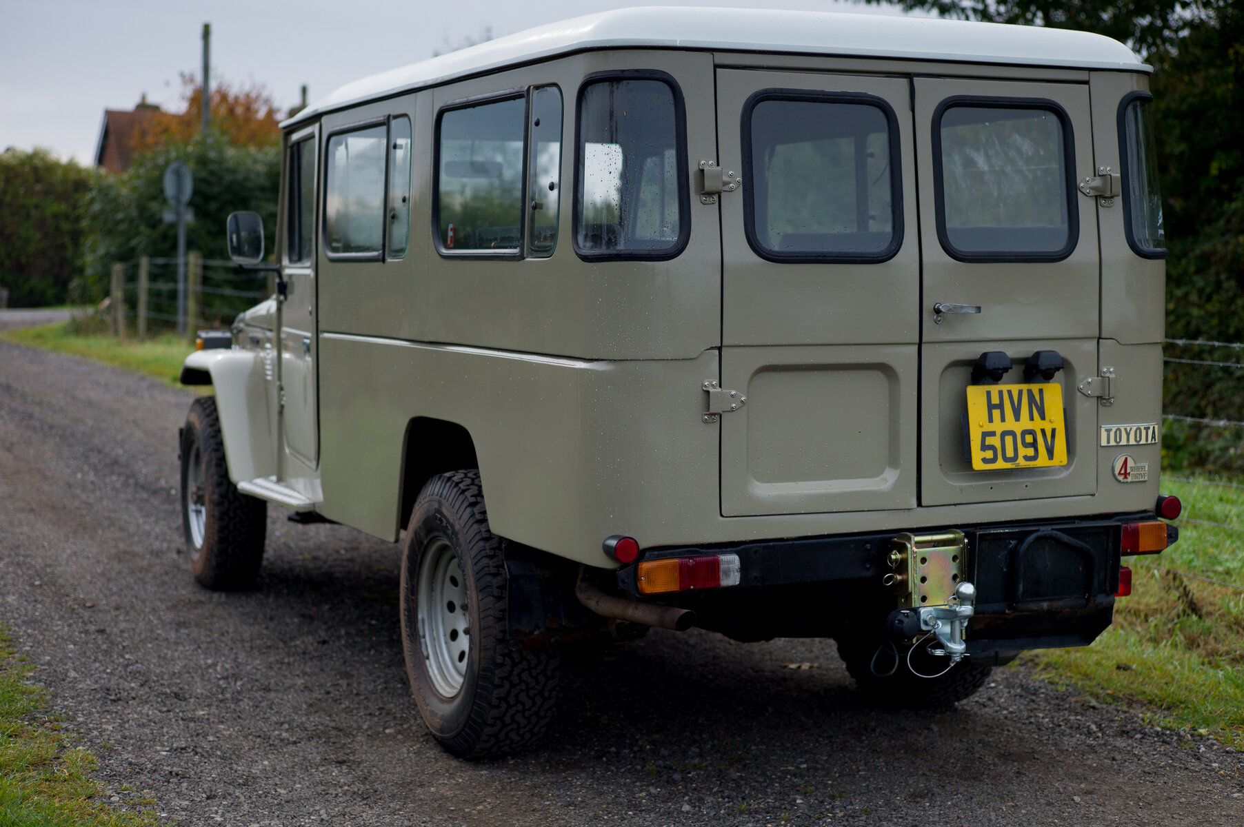

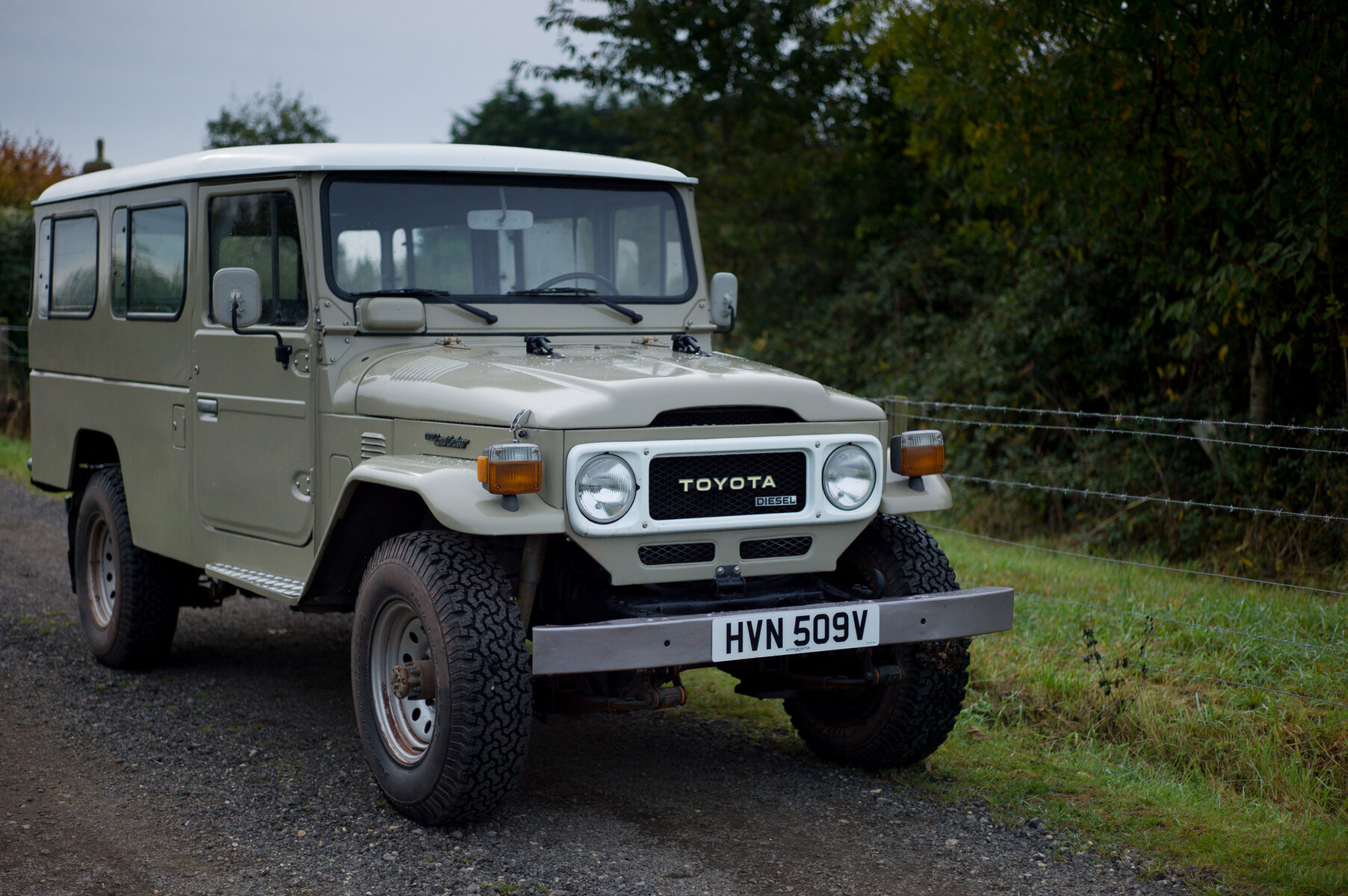

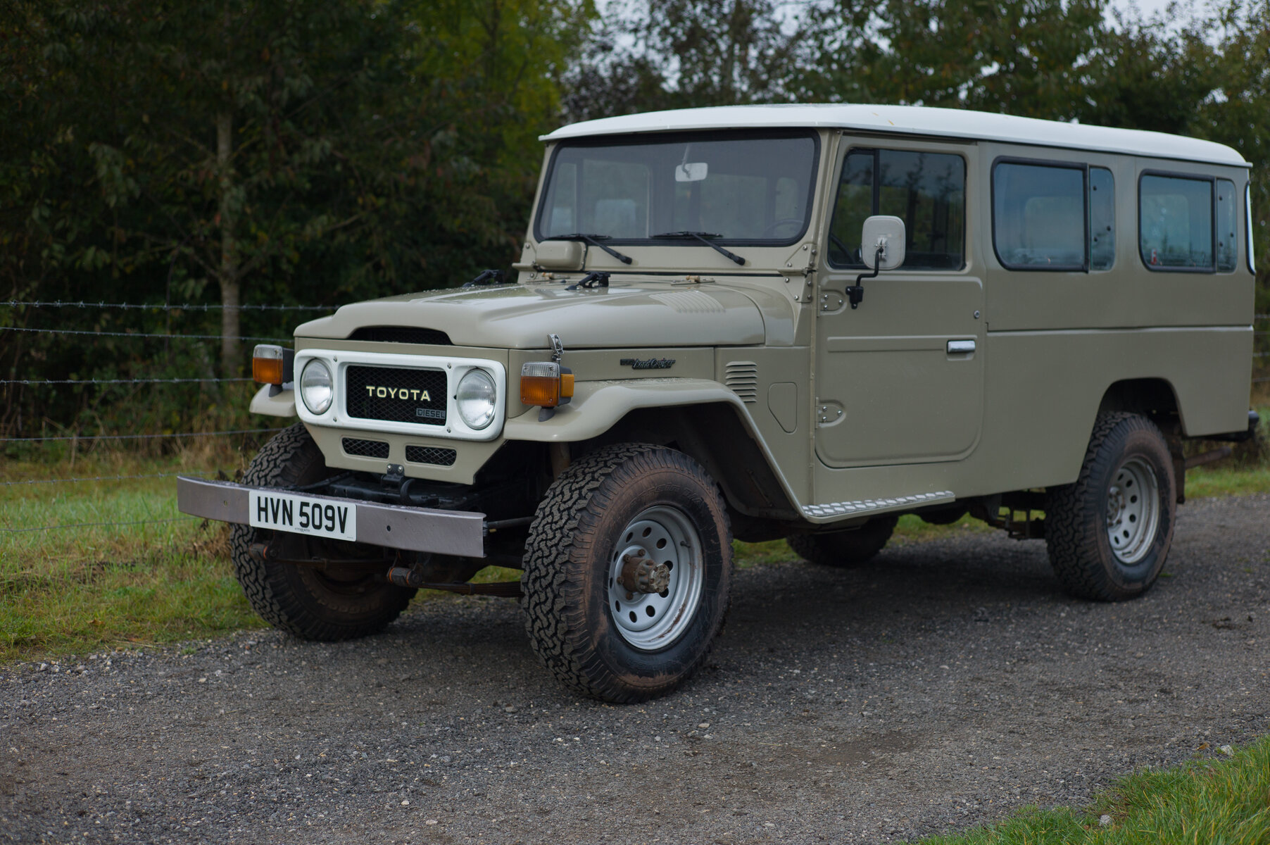

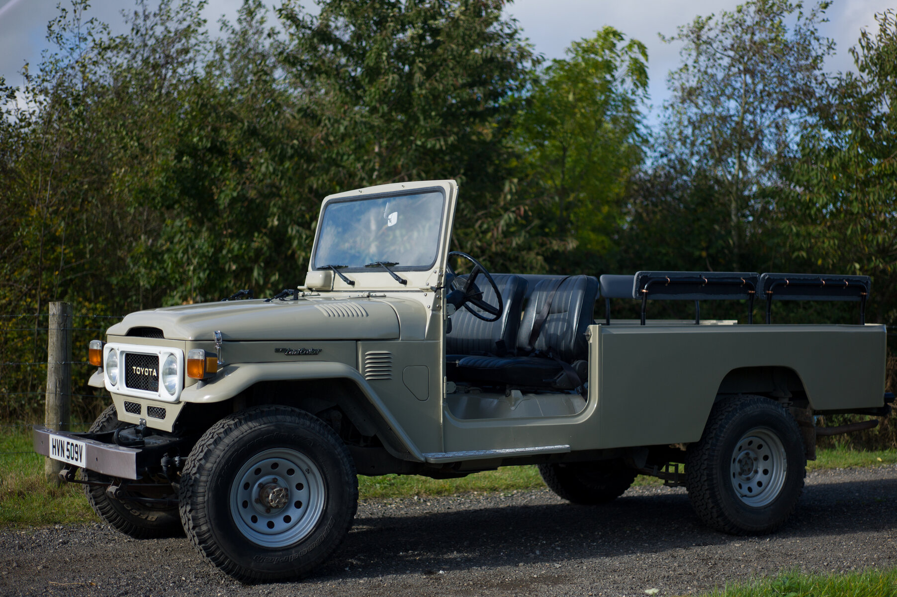

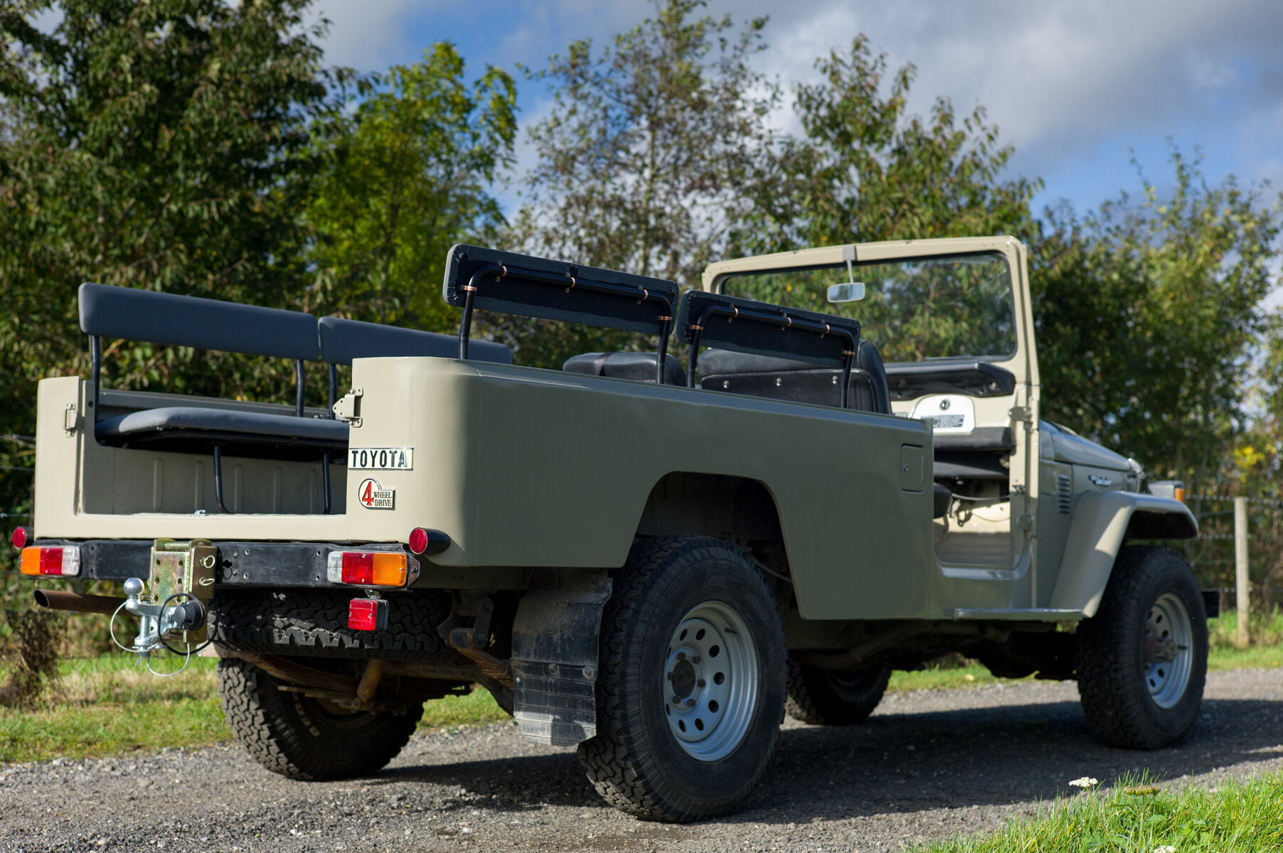

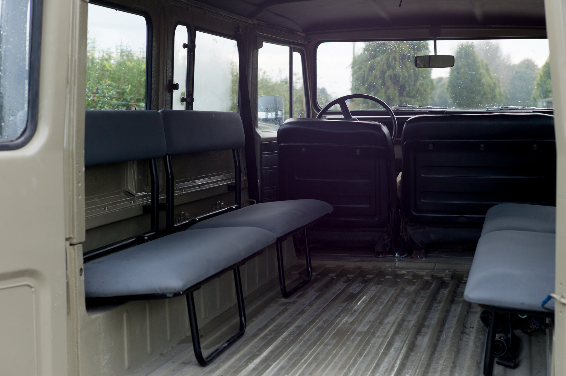

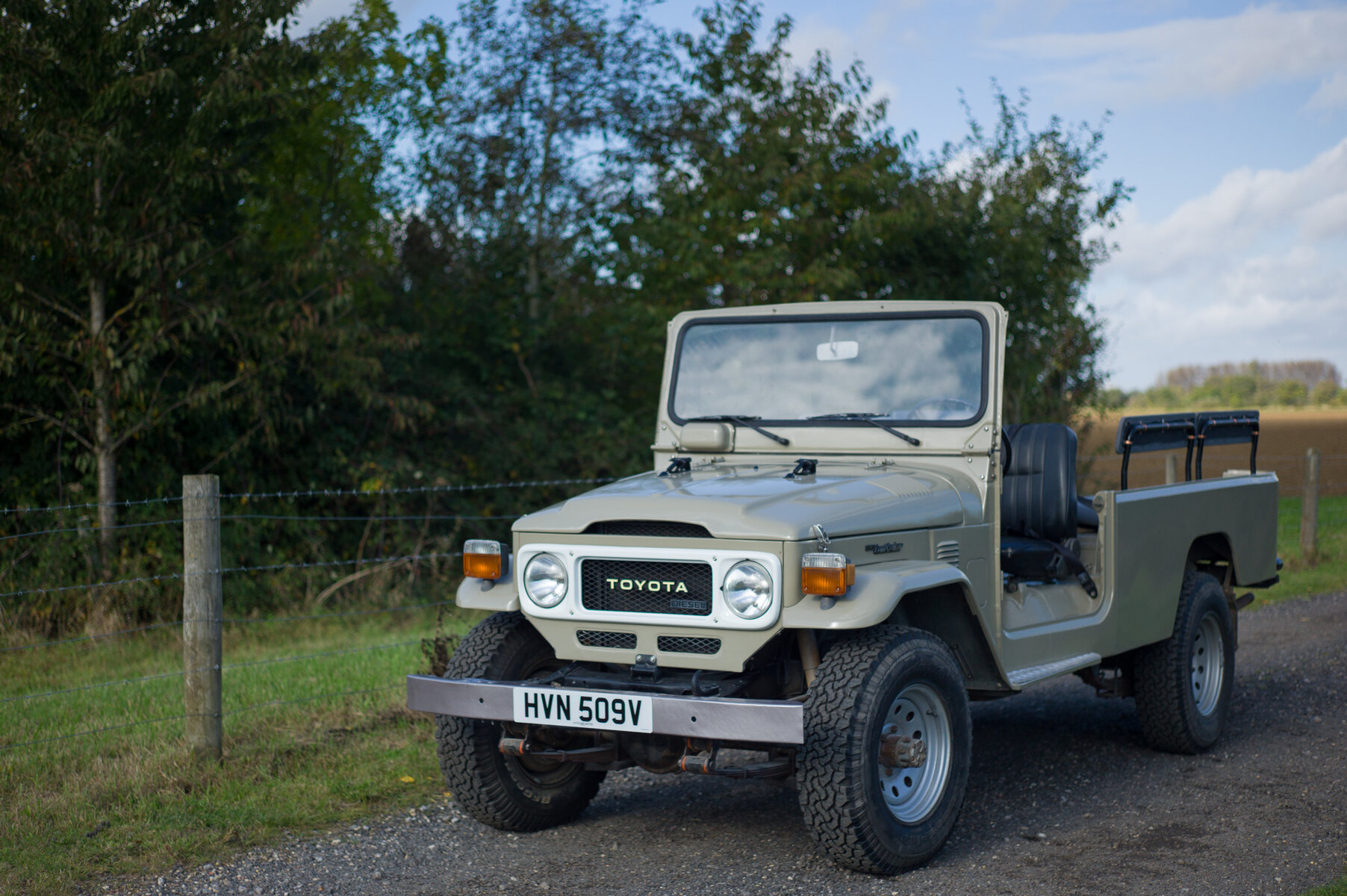

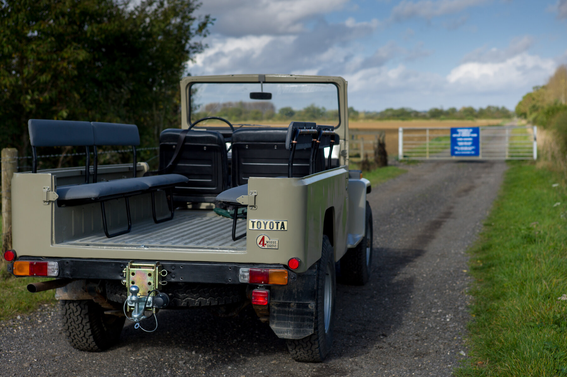

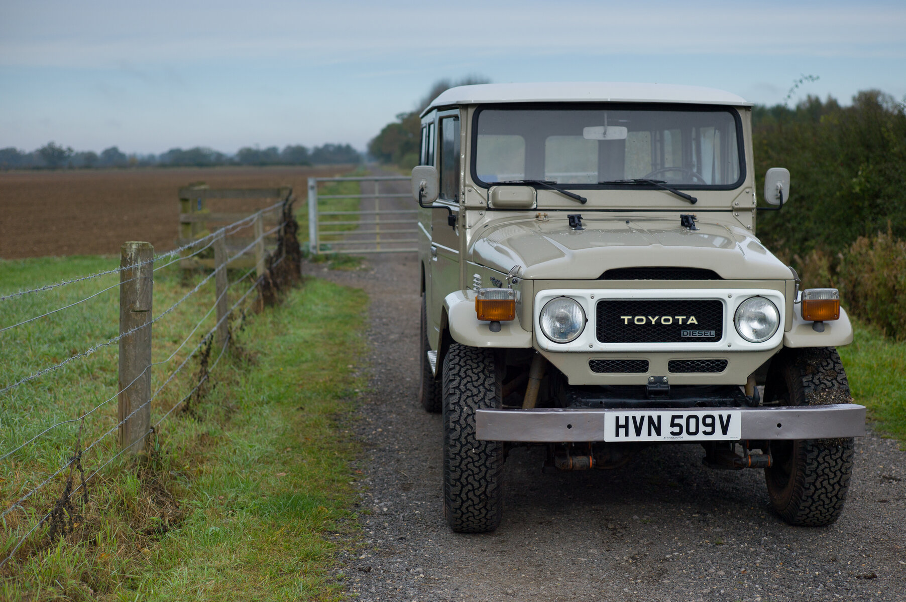

Restoration Nearly complete (see photos)
Yesterday we managed to drive the BJ45 out of the garage following a full body repair and respray.
Thanks to Geof and his team in the spray shop at Three Corners Garage in Ambrosden Oxfordshire, they have done a great job over the last few weeks.
Photos to follow.
Land_Cruiser_BJ_45_Beige_416 .jpgLand_Cruiser_BJ_45_Beige_416_2.jpgLand_Cruiser_BJ_45_Beige_416-3.jpgLand_Cruiser_BJ_45_Beige_416 _-4.jpgLand_Cruiser_BJ_45_Beige_416 _-5.jpgLand_Cruiser_BJ_45_Beige_416 _-6.jpgLand_Cruiser_BJ_45_Beige_416_-7.jpgLand_Cruiser_BJ_45_Beige_416 _-8.jpgLand_Cruiser_BJ_45_Beige_416 _-9.jpgLand_Cruiser_BJ_45_Beige_416 _-10.jpgLand_Cruiser_BJ_45_Beige_416 _-11.jpg
Her first outing was at Lincomb yesterday. Thanks to Tony, Andy and all others for making us feel welcome, we had a great day.
Adrian
Hi Adrian it was good to see you and the good lady and the Cruiser looks so cool in the new colour big Thanks. For letting me have a go in it I love the old 40's hope you will come and see my and the boysIn May 2015 good look with the cruiser thanks a lot Tony.
That's just bootiful!
Great colour and a really professional job there Adrian :thumbup:
Thanks for the compliment.Working with Land Cruiser Owners Club members who helped me with parts and advice, suppliers from abroad and the team at Three Corners Garage has been a long and enjoyable process.I'd do it again I think.Adrian

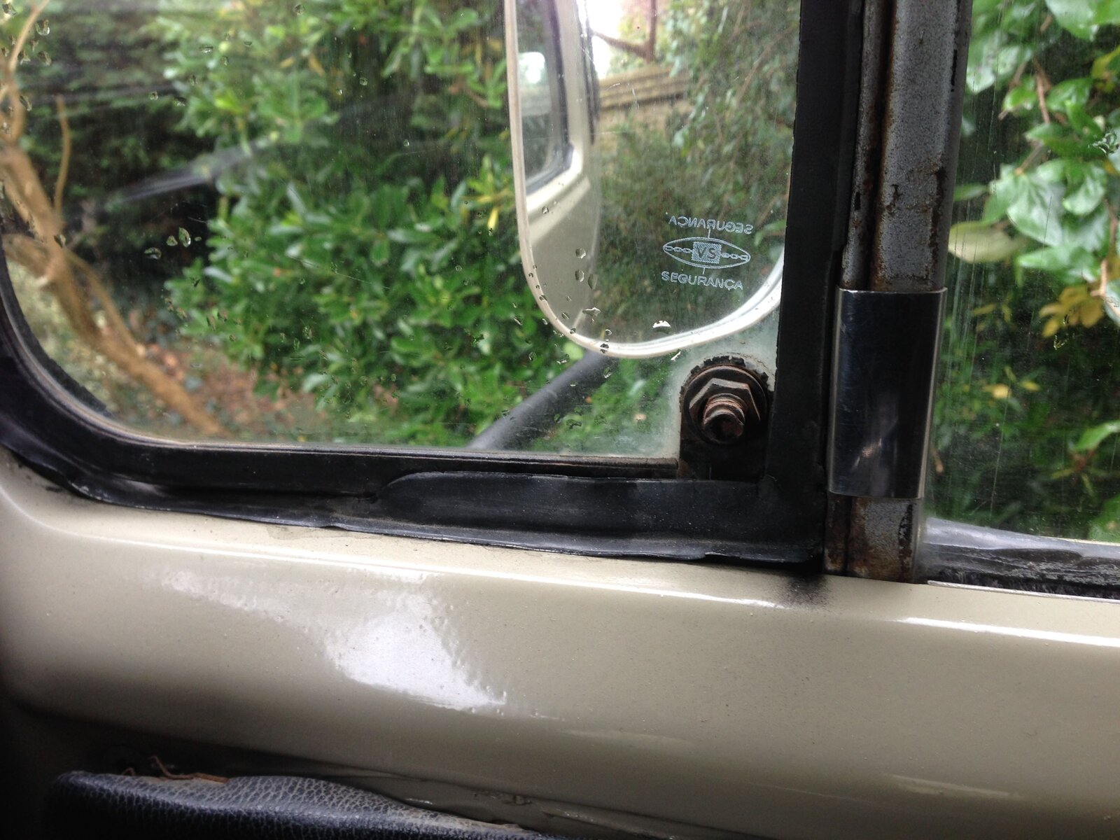

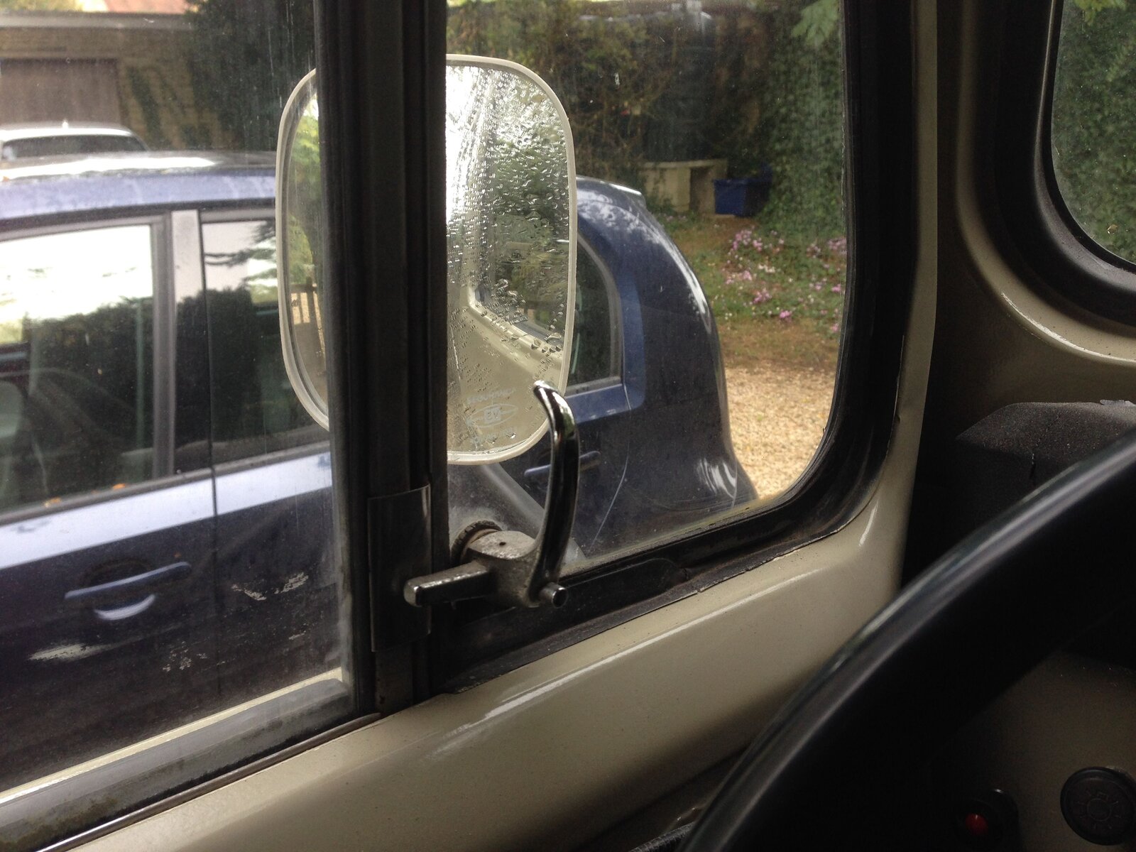

Do you have a quarter light window catch, I need one for right hand door (LHD passenger side)?

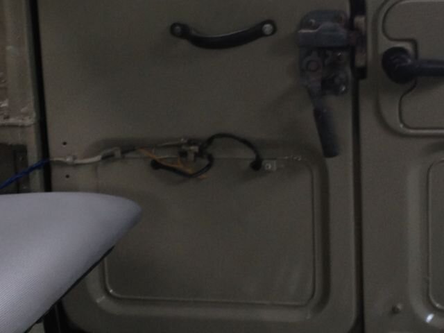

Also a wiring cover for the back door?
Please let me know
Thanks
Adrian

Hi there mate
no as i tend to sell doors complete, but pretty sure I can get them just might take a few weeks.
Giles
Okay, let me know if you find one. I'll keep looking elsewhere in the meantime.ThanksAdrian

Thanks for the compliment. I must say Beige 416 seems to be a classic colour and looks really smart
Adrian
