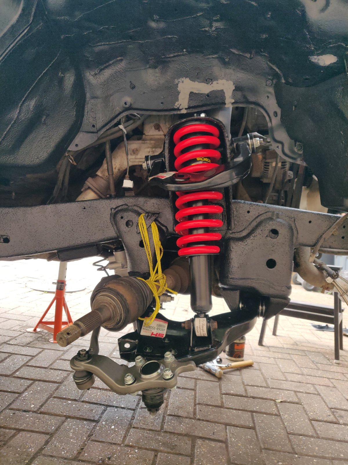

    Monroe plus pedders kits are available from roughtrax and on the advise of @Shayne and @diggerdave are what I'm fitting on my 95... +2 inch lift... They look cool too

    Looking good Finiterex!

    Yeah mate she's getting there!

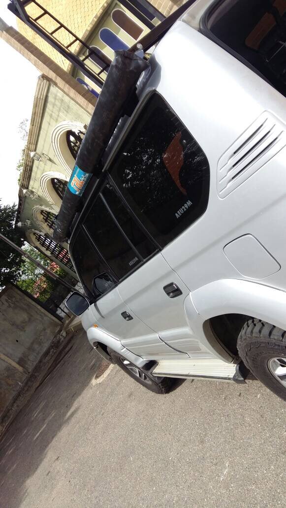

    The car has a lift. Quite high. W
    Did anyone else use this kit. Just trying to find out more info .
    Looks great though. There is some kit on mines aswell. Just not getting a chance for a pic . It's lifted and has bigger blackened springs.
