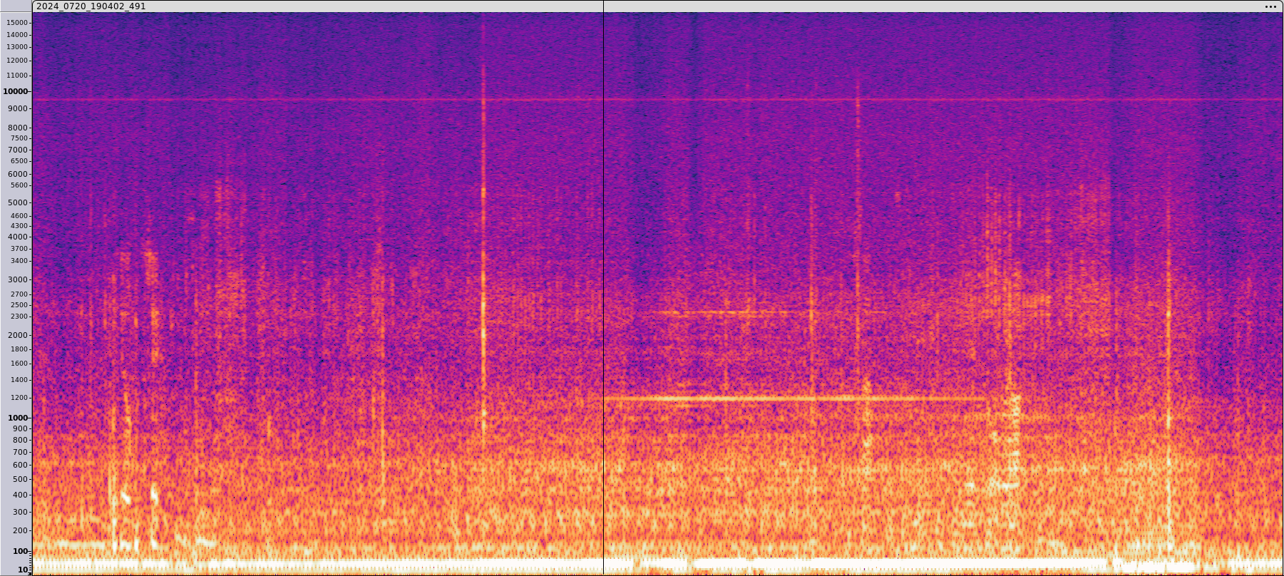

First - recording from dash cam + overlay showing resequence spectrum with time marker:
Today is first time I encounter this sound. It's frequency is fixed at 1200Hz, so to me it seems independent on engine rpm or speed.
Any ideas on what can cause this sound? It seems to be triggered by the forward tilting of the car, possible in combination with steering hard left (not maximum) and reversing in low gear
Other than the sound itself, there was nothing else noticeable about the car. No decline in engine power, no vibrations, that sound only.
[edit]
adding sound time-line as spectrum - screen copy from Audacity.
I had fitted new brake disk splash guards to the front of my 120 a month ago and all seemed clear of the disc when I checked at the end just by spinning the wheel by hand in straight ahead position. However, when turning left on full or nearly full lock and on my sloping concrete at my house it it was catching.

Car was visiting workshop yesterday and it was found that the brake shield needed to be moved slightly. The car is still on workshop, but for a different issue (I make a new post about that)
