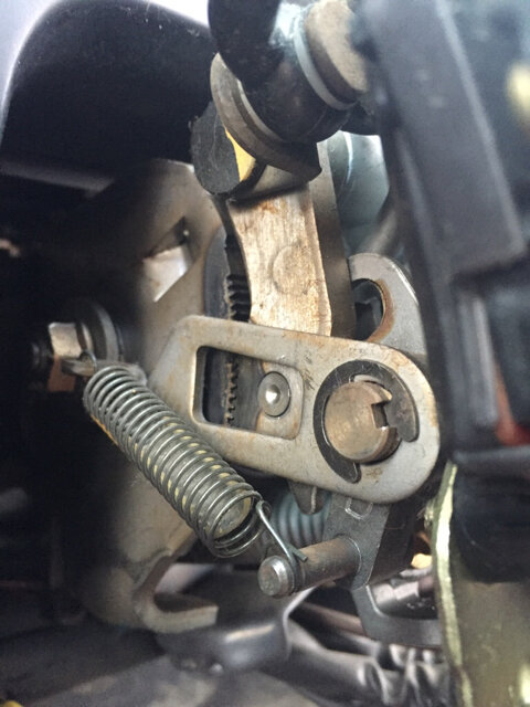

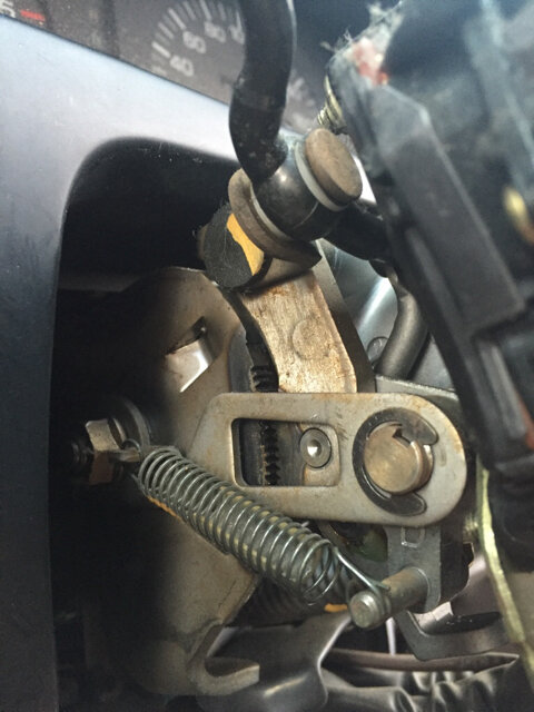

Left side
You can just see the stamping behind the toothed arm.

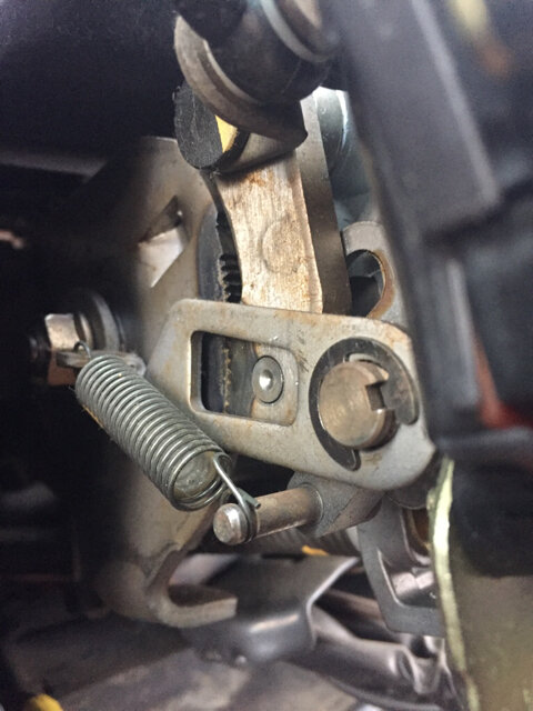

Right side

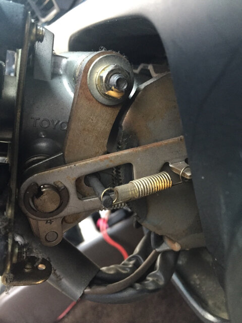

On the first photo, it turns out the arm with the spring in the foreground, is a final lock. This was not engaging because the arms were stopping just shy of their final position. All the last mm of return being taken care of by springs.

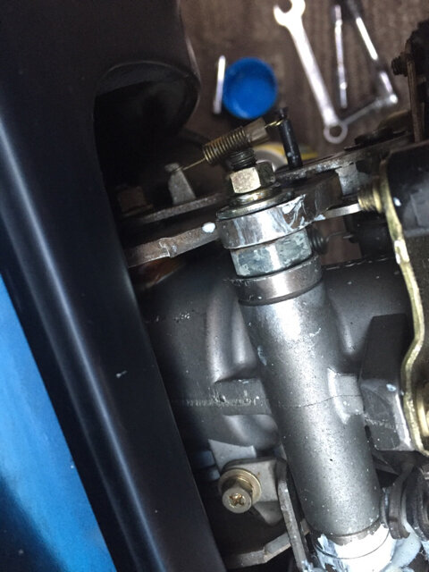

So, I decided to clean off the old gloopy grease and spray some new in (the only stuff I had was white grease but I figured this should be ok). I loosened off the pivot bolt at the top of the lower photo and sprayed grease into the pivot and tightened it back up. All the time it was loose, it worked faultlessly, tighten it and it became reluctant again.
Note, there is an adjustment to the right hand side so that the meshing of the teeth on both sides can be lined up (nice touch Mr T[emoji4]). I tried adjusting this but still no joy when all pulled up tight.
The adjuster is the hexagon shaped chrome looking piece just a bit below the nut.

After much deliberation, I decided the thing worked best of the nut was left slightly loose, so, reluctantly, I swapped the 6mm nut for a self locking 'nylock' nut and did it up till it wouldn't work and backed it off a smidge. It all works fine now.

Left side
Right side
