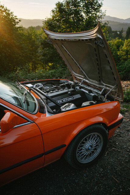

How many 1990's BMW have been in continuous use as a daily driver and will remain so for the foreseeable future . No Cruisers aren't BMW's thankfully :icon-wink:
Shayne, I do drive a 90's BMW with 300,000 + miles... but if I had to choose I would keep the Cruiser for sure. We are in the twilight of internal combustion so you might as well drive something that puts a smile on your face, right?

Can't argue with that , if it makes you smile then it can only be a good thing :thumbup:
