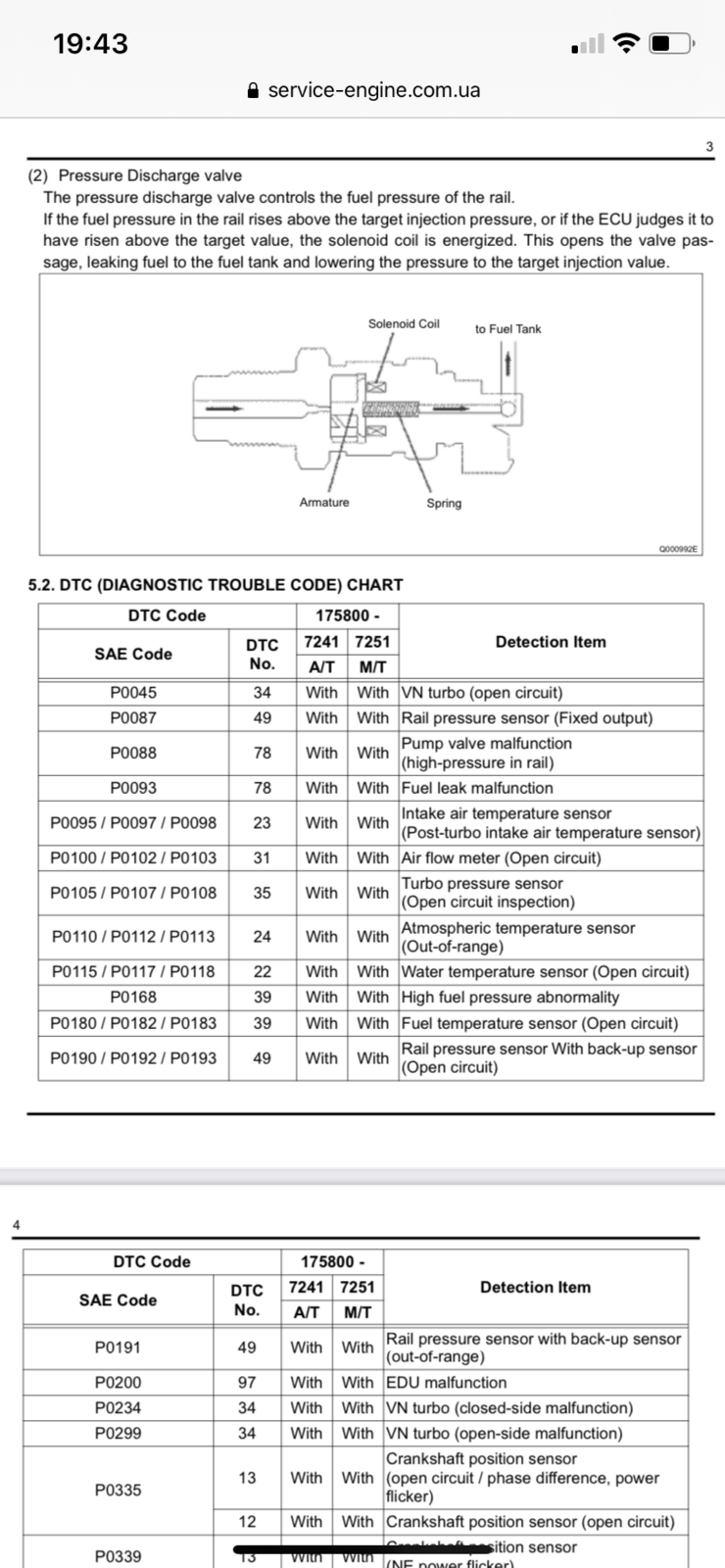

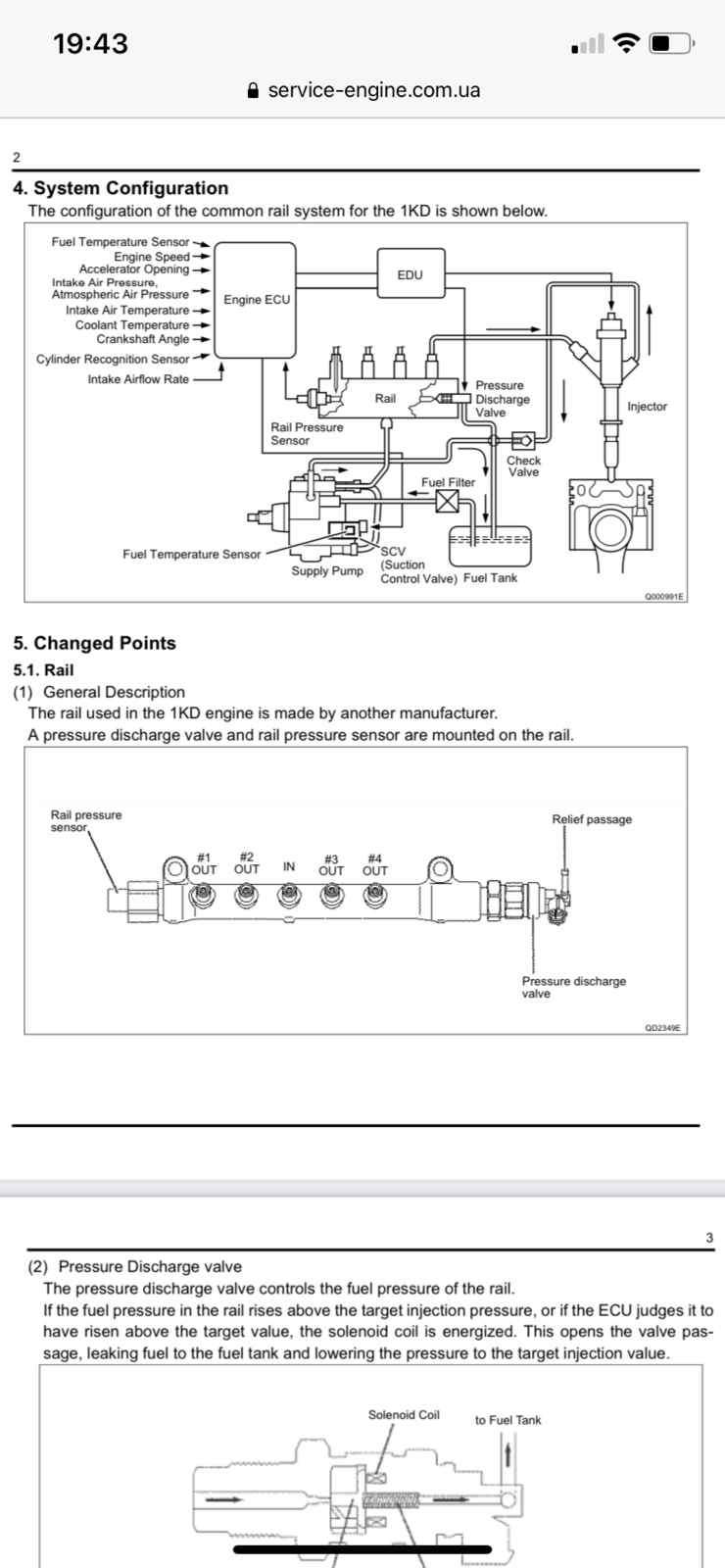

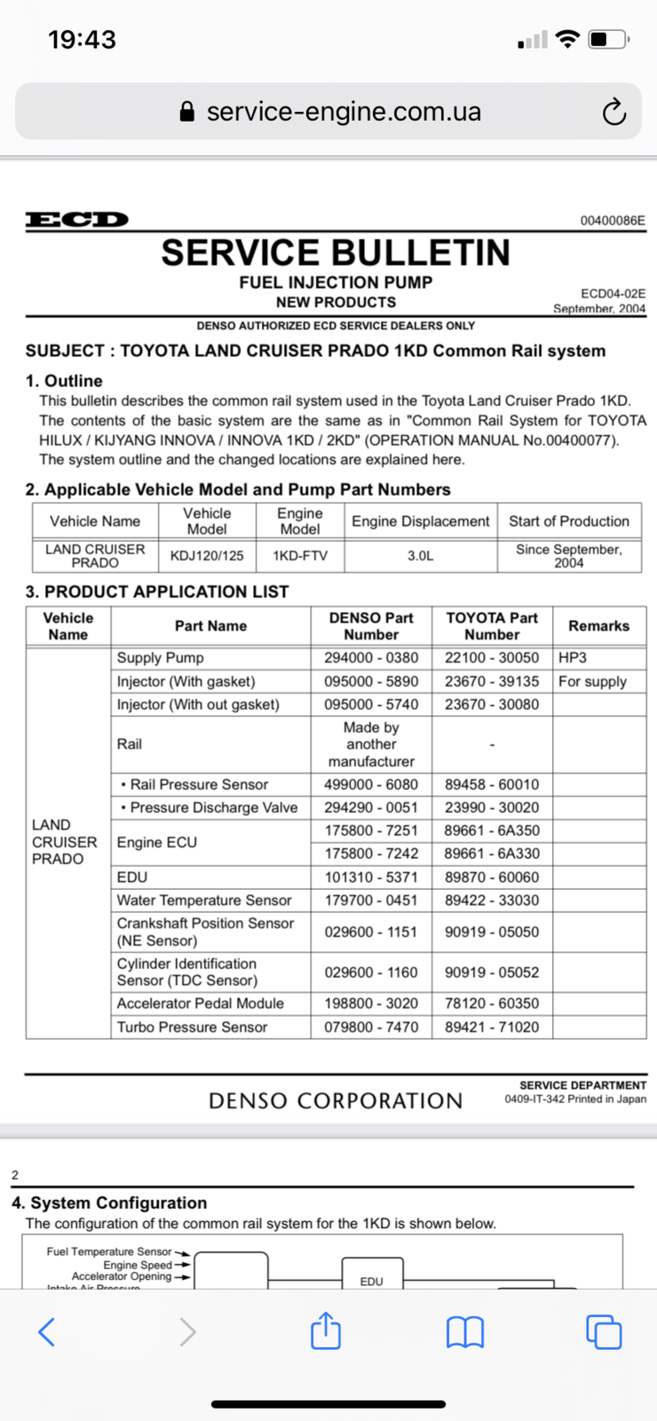

I found a pretty good little technical paper from Denso on the fuel injection system:
https://www.service-engine.com.ua/webroot/pdf/TOYOTA LAND CRUISER (2).PDF
On page two it shows a really handy little schematic of some key inputs that the ECU relies on to make informed decisions about fuel delivery. Couple of screenshots included as well.
After reading this, I am realizing that my troubles are so consistent, easily repeatable and somewhat dependent on specific revs AND a particular load state being achieved i.e uphill - it’s possible that the ECU (or one of these specific inputs) has a role here.
So now off to check each one of these ECU inputs - inspection, clean and where possible some further review on my poor version of techstream.

After getting to the point of having very few remaining options, and convincing myself it was an ECU issue - I went back through the listing of ECU inputs that I found in the schematic below (I included the full extract in a previous post).
Using Techstream I re-checked that each of these items was providing stable inputs and reasonably relevant measurements. Except I couldn’t test crank angle or cylinder recognition - largely assumed these to be fairly major inputs that would definitely throw multiple codes and would cause more significant symptoms.
All the readings seemed spot on. And I was really only left with the intake airflow. Readings from the sensor have been hard to monitor properly as there is constant fluctuations. I’d previously discounted this sensor because it gets cleaned frequently and I guess the logic had been that if the sensor was faulty, then the car would have problems running across all rev ranges.
