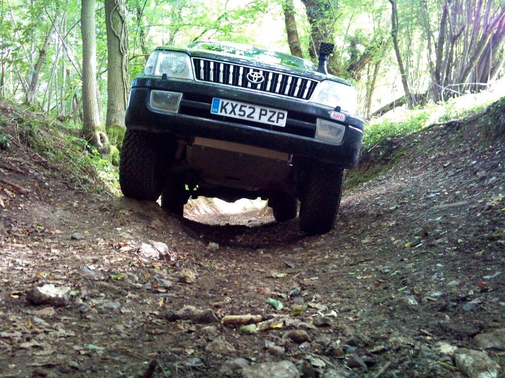

In complete agreement hence:
ASFIR Bashplates and 2 inch lift ;)
