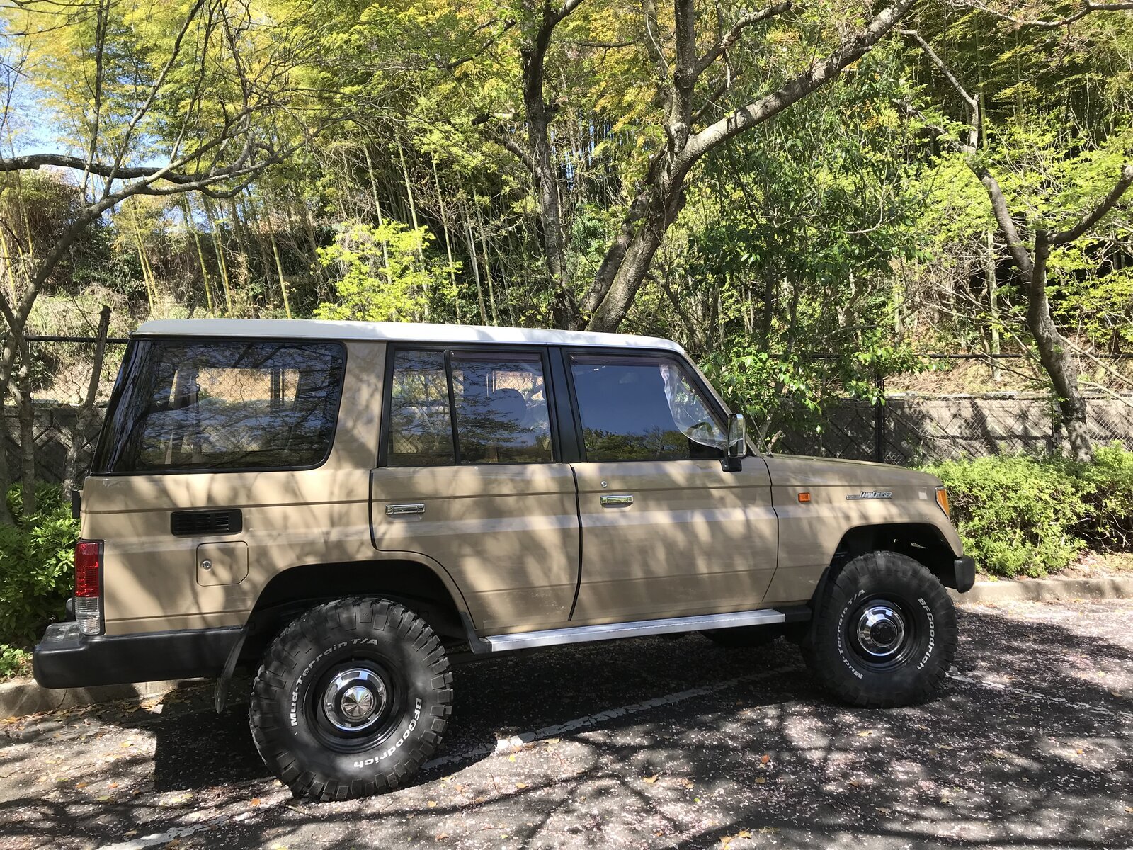

Wow! So a bun of people have had this infamous click no start issue. Me too! Though not every time it is more frequent lately.
1994 JDM Prado KZJ-78 with 3.0 kz-te motor. Battery good, checked cables and grounds all good. When I “wiggle“ the key and pray it will start (so far).
Makes me think an ignition switch problem. The KZJ has ignition switch #84450-60210 and it is verified as being discontinued.
Any ideas on a substitute switch? This is a three position type with glow plug then fire of course, and the button to release the key.
Thanks in advance.
