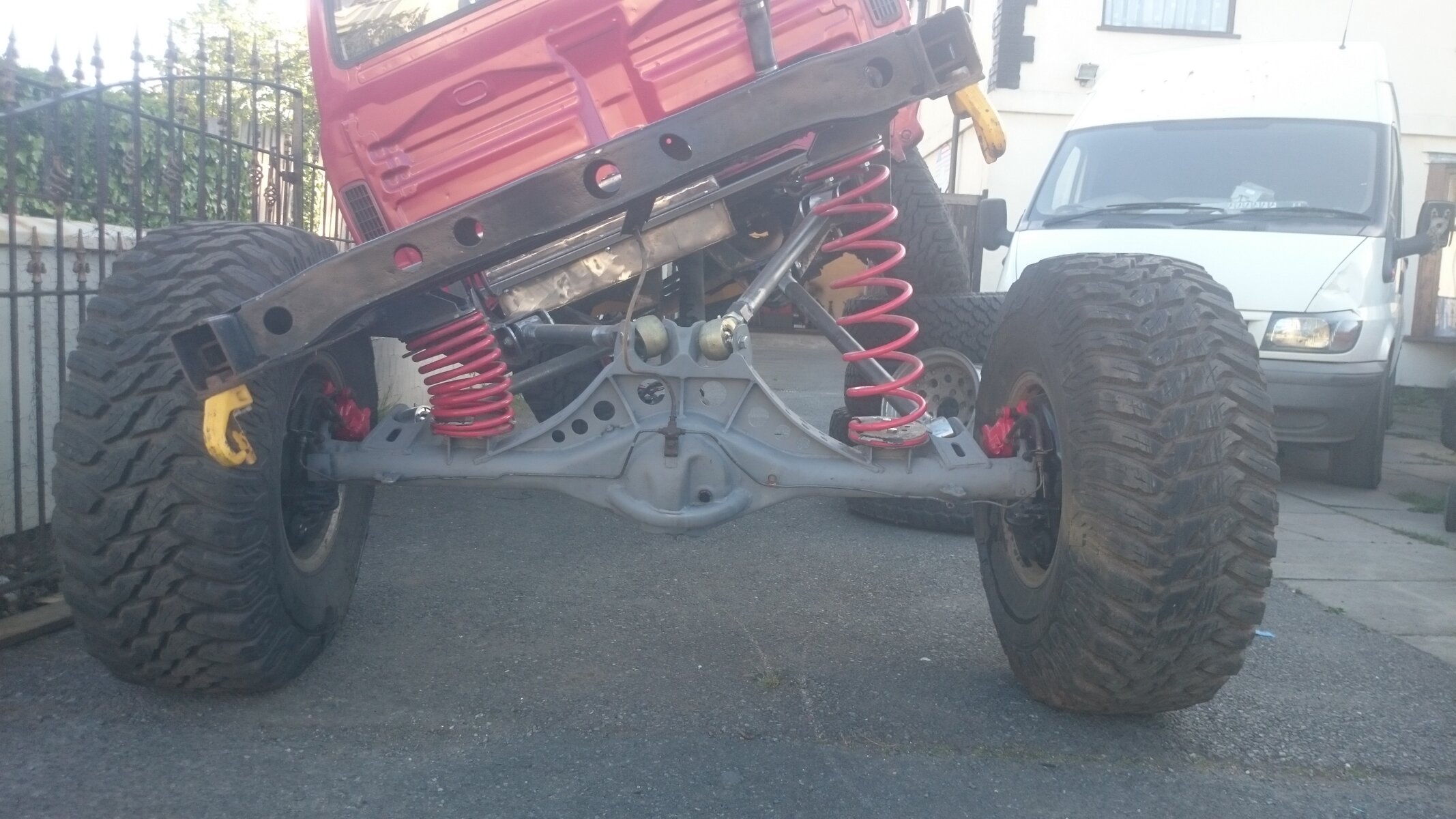

Any plans to "fill-in" the gaps between the front bumper ends and the arches? I'd imagine that quarter to be a bit vulnerable, I know that my front ARB quarters have come in handy on several occasions :whistle:
The lift looks 'substantial' do you have any steering 'drift' issues? I'm going with dropper boxes on mine when I get the chance to collect them from Stan's place. At the moment I'm sure that the caster correction is inadequate.

Thanks mate I know the yellow is a love it or hate it thing I am getting a Aussie bullbar of my mate hopefully so that will come round and meet up with the arches. The steering used to wonder abit I had to always correct it when going down motorway. Now I sorted the castor to +3 it's back to factory with the 4" lift so it drives perfect even going 70mph stays straight no wondering what so ever. I to am going to fab up some new brackets for the chassis end of the radius arm to sort castor out if I get the 6" spring am probably maxed out with them brackets on axle as my track rod is close to the radius arm but not touching when I cycle the steering

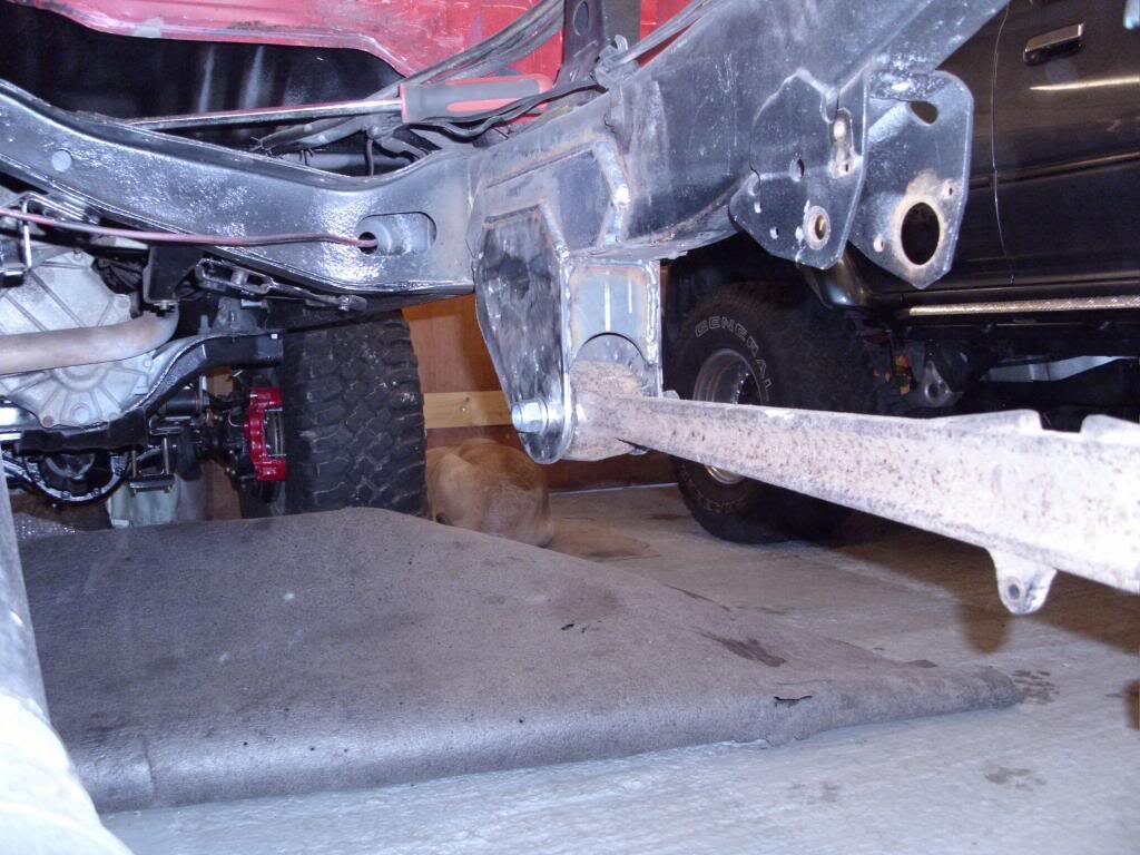

Take care fabbing them yourself.
Chris on here is an expert fabricator and he got into several difficulties with his. He ended up buying drop boxes from Blown 80 and they cured all his problems. I've bought the same, just have to collect them from Kendal...

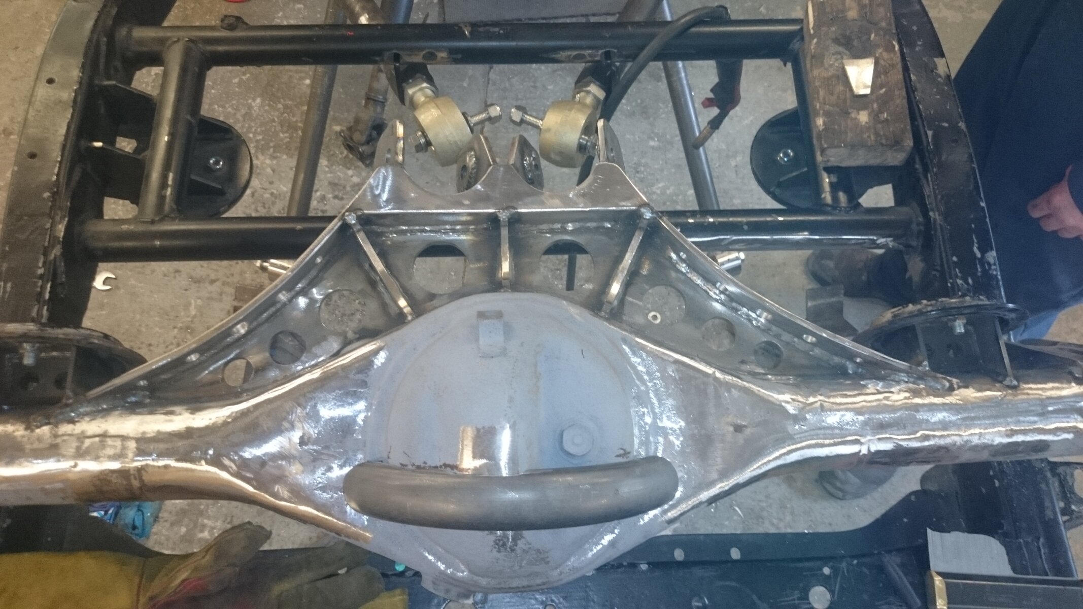

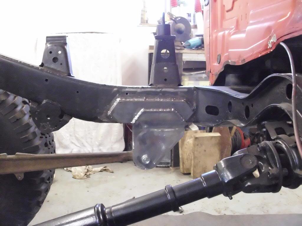

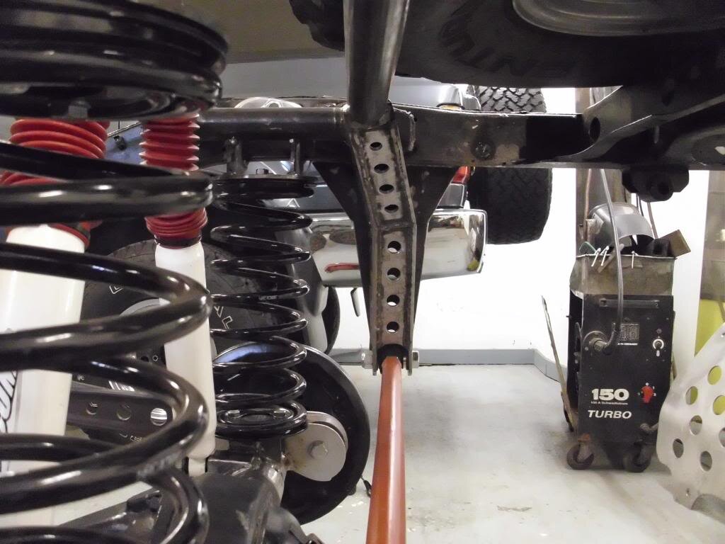

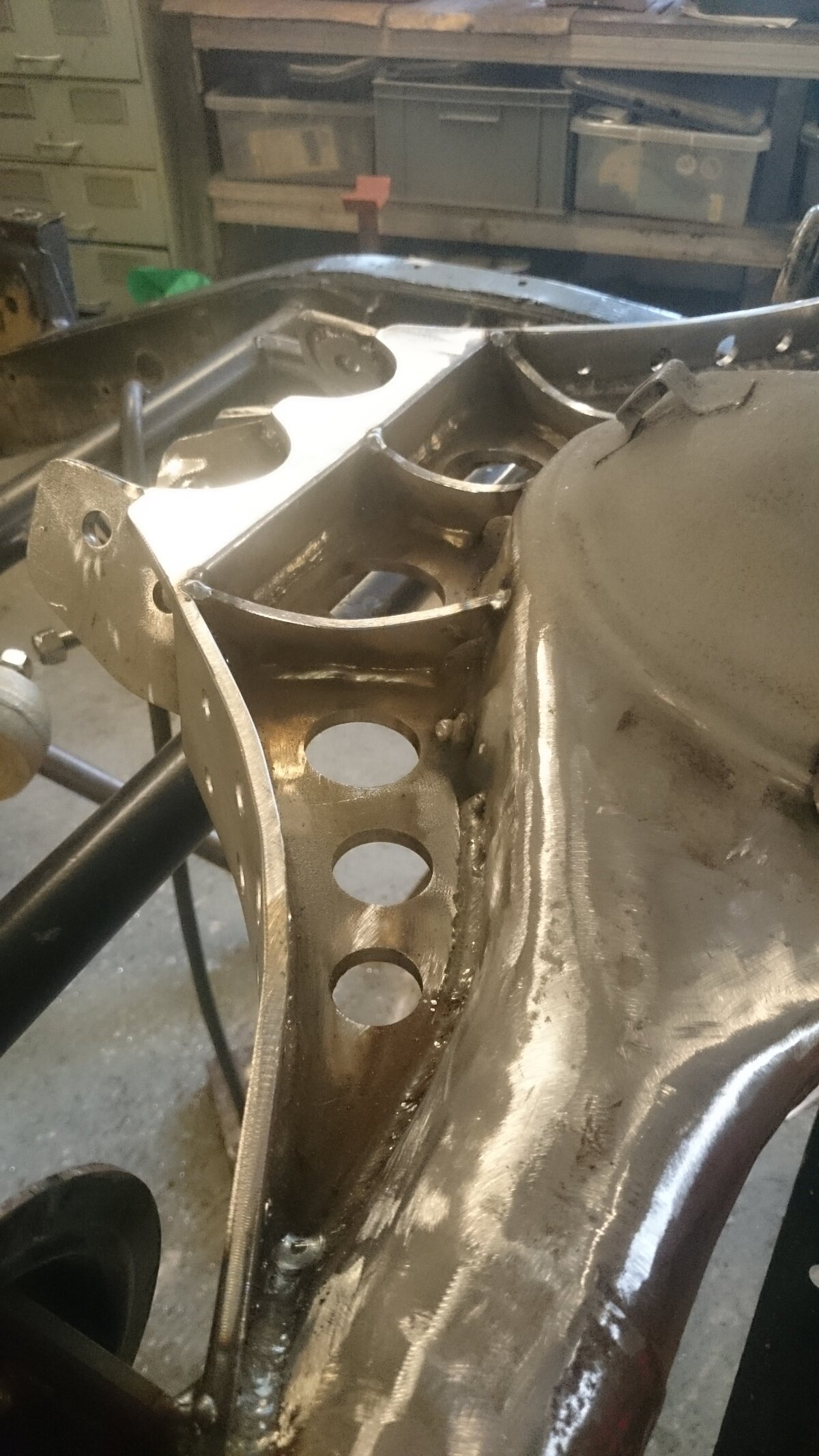

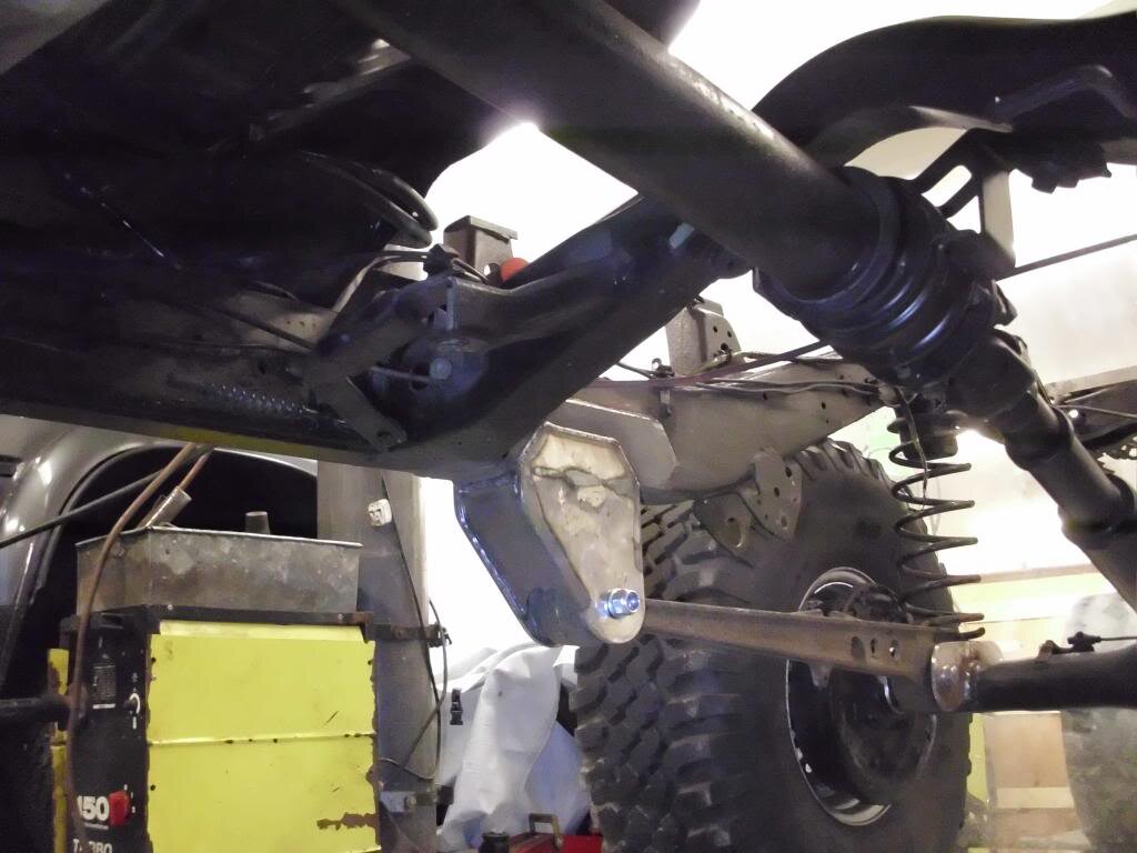

DSC_0717.JPGDSC_0738.JPGDSC_0713.JPG fabricating them shouldn't be a problem :thumbup:
I don't doubt the engineering, but for some reason, his home made boxes caused all sorts of handling difficulties that were resolved with Blown 80's units. Wish you better luck with yours :thumbup:

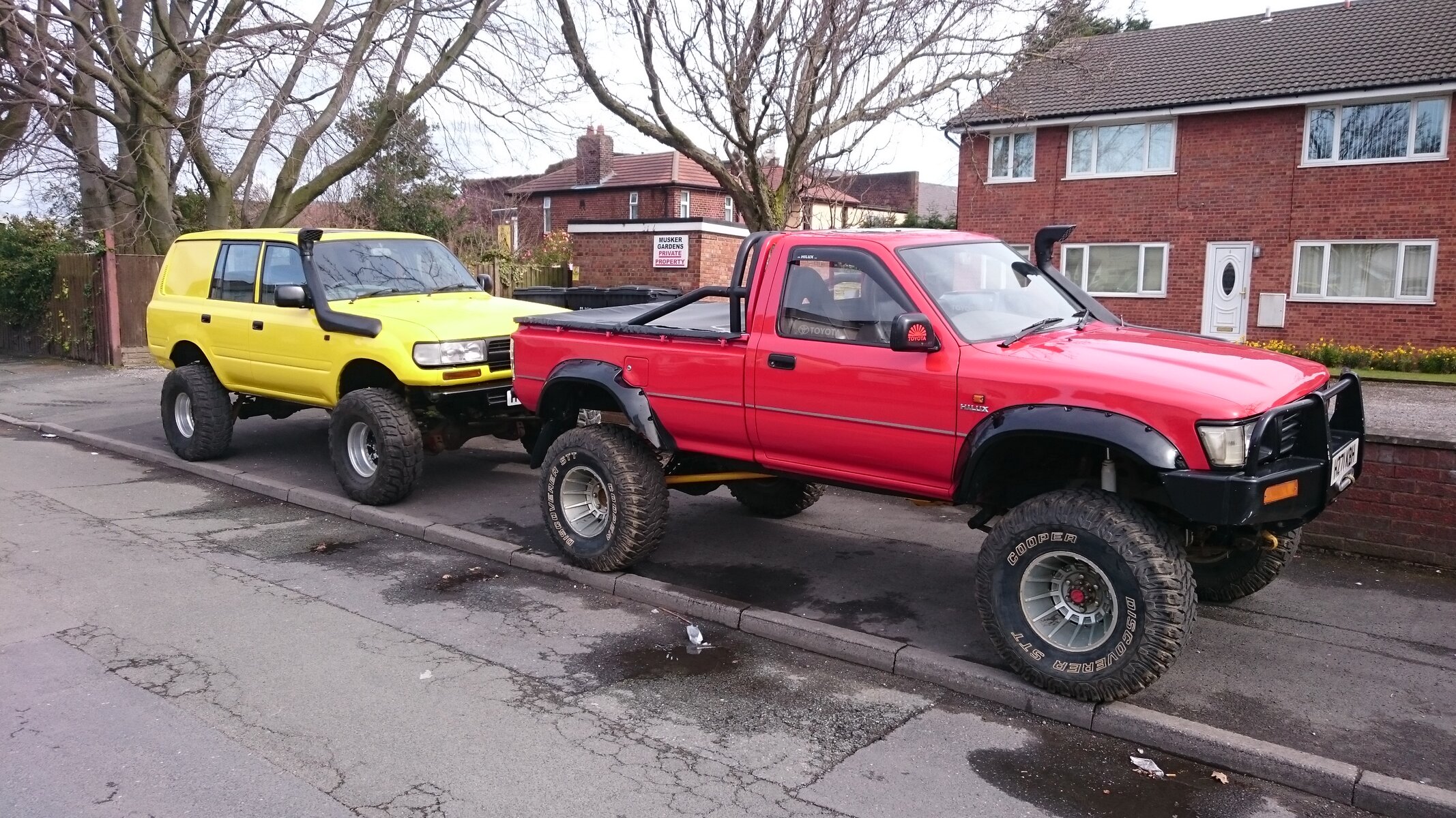

(what is it?)
I will upload another video I think the video didn't work because there was music o the background (copyright) bolocks lol. It's not a trayback it's my mate mk3 hilix pickup DSC_0031.JPG

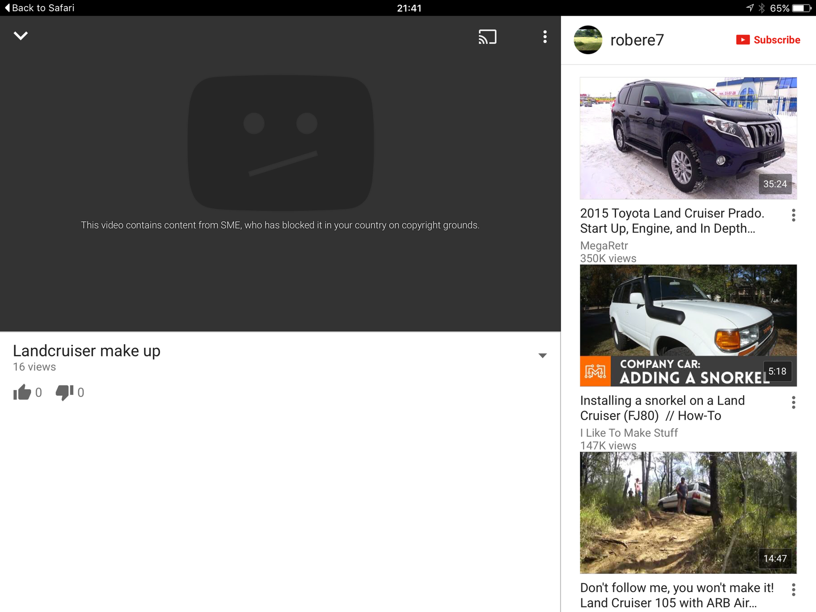

Tried to watch the vid but saying content is blocked due to copyright in uk ? Nice job on the truck though

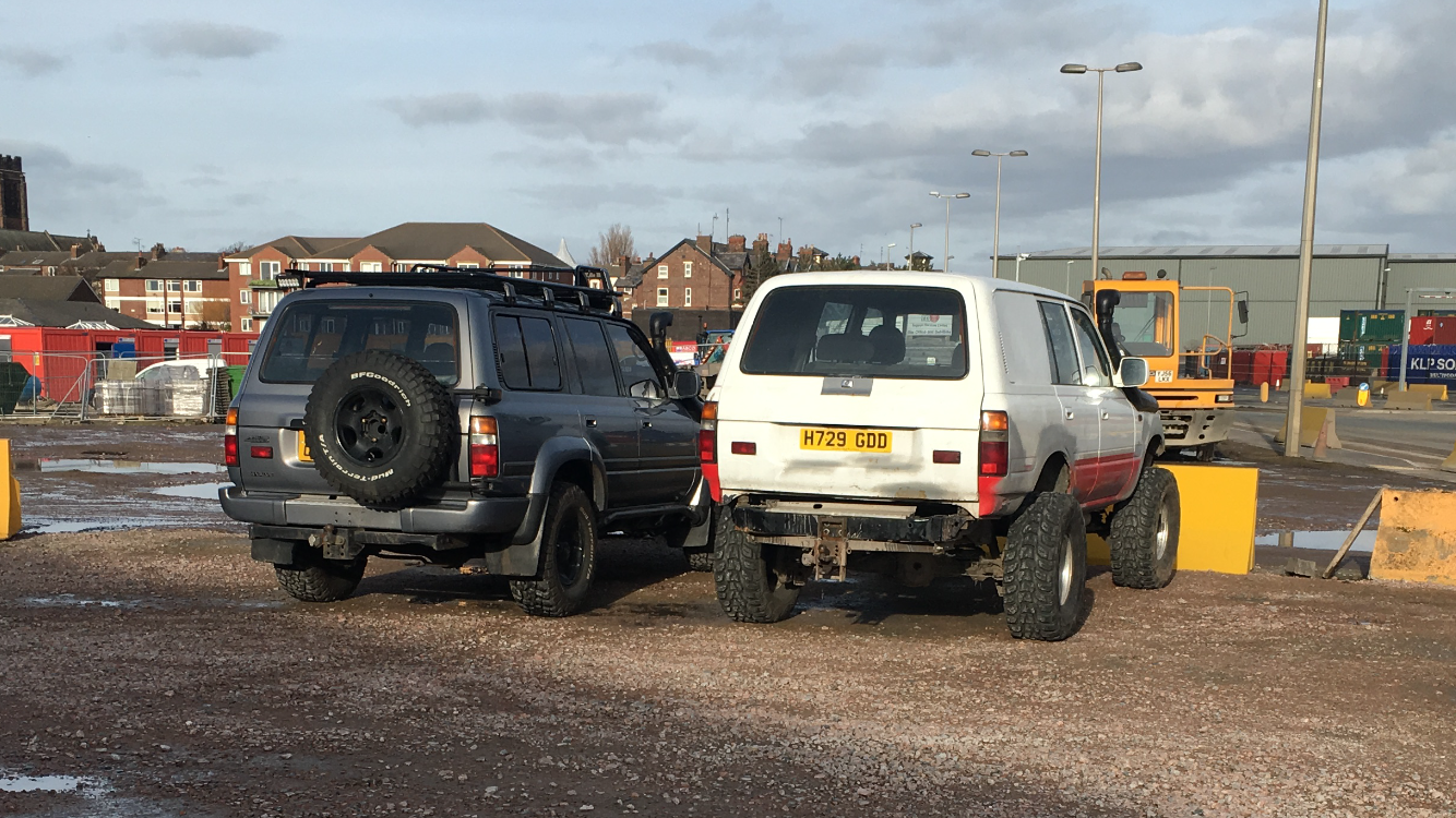

image.pngI parked next to you in the dock the other month and it made my cruiser look small
Yer Im the one that stopped I asking about the roof rack
