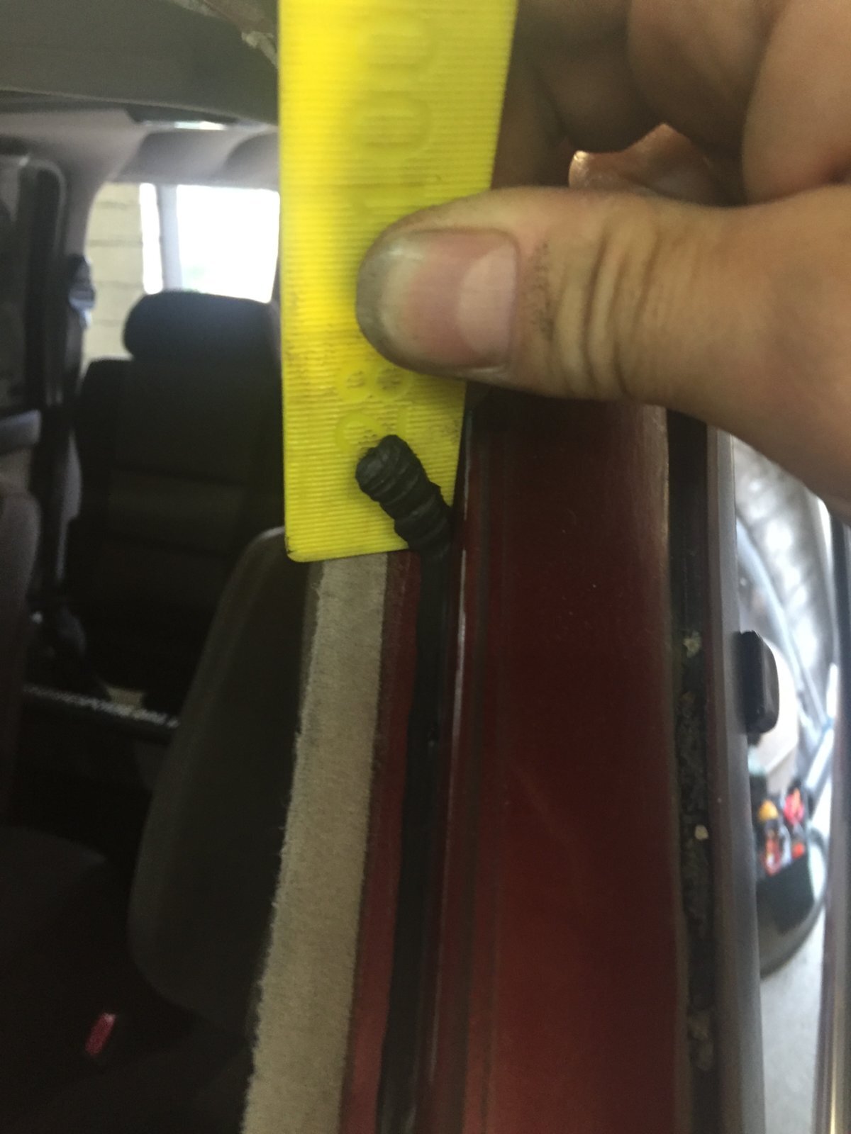

All glass out.
There was a bit of a question as to whether a screen could easily be removed after using Butyl Screen sealer. Well, it does, quite easily. Cleaning off the remaining sealer is easy with a plastic scraper and brake cleaner.

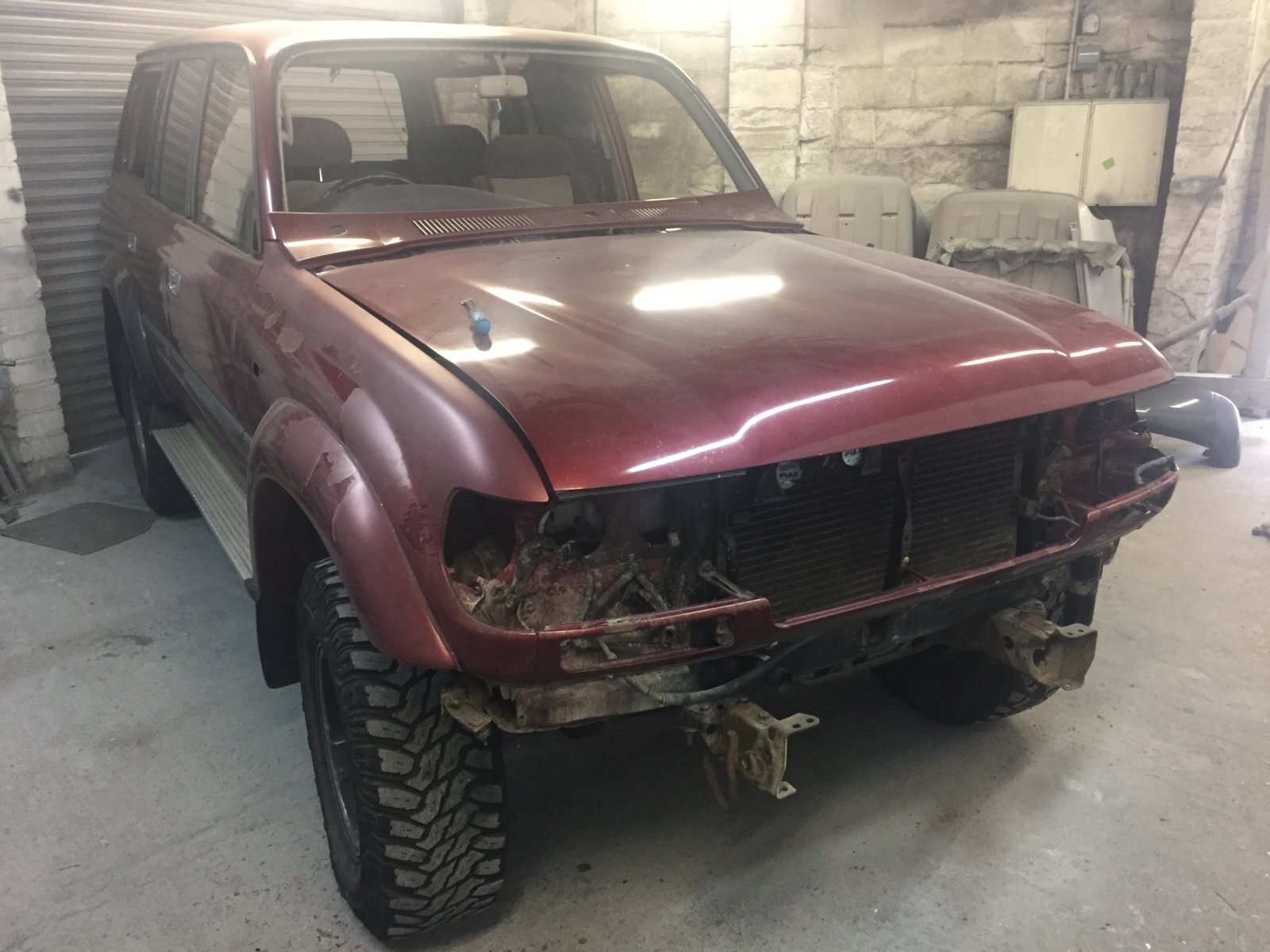

Bumper off to be able to get to the front valance.
