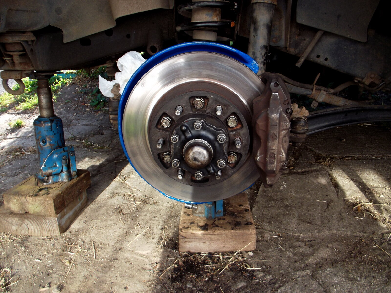

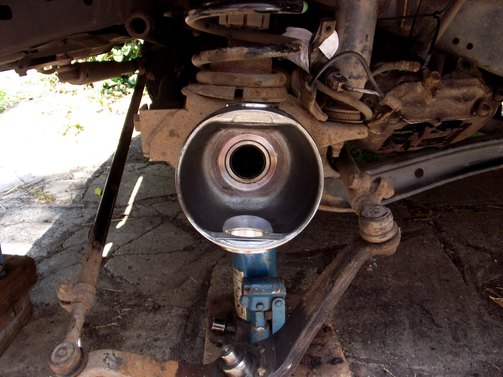

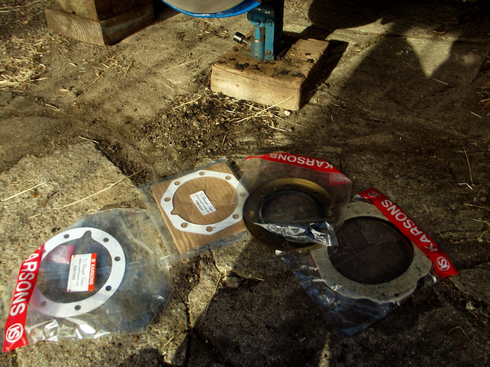

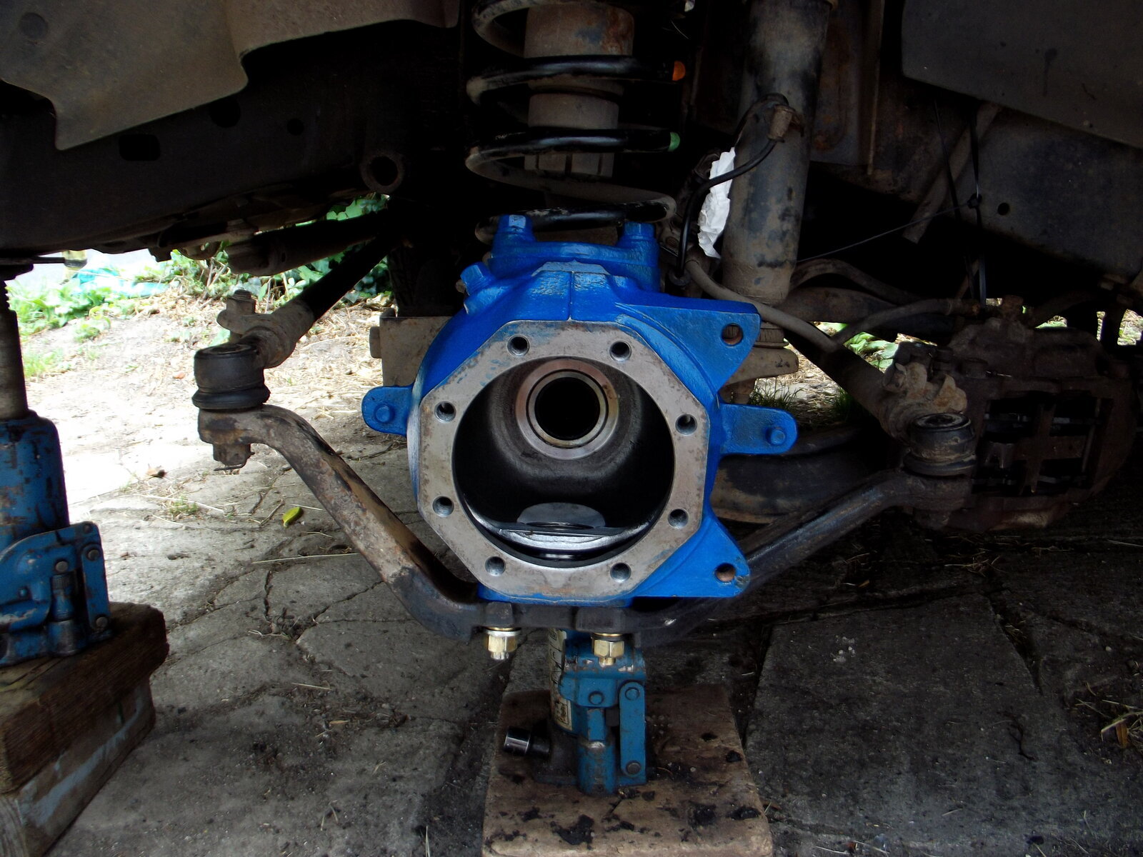

Iv just done a Knuckle strip down job on mine, Its a pretty straight forward job, Just sign up to RoughTrax and get what you need, It will mean a complete Gasket kit Steering Knuckle wiper seal kit, Inner axle seal x2, Cv grease Bearing Grease, Steering Knuckle bearings ( i can bet one or two are Knackered... Dont be phased by the endless list.. It really is an easy job....... But be prepared for new wheel bearings. AND more ... But even after doing that it doesn't cure knackered diffs if its gone that Far..... where exactly are you......This is what iv just done and what the steering Knuckle should look like :lol:
Well what started out as just a broken lower steering Knuckle stud. Turned into a Full front axle strip out, New steering Knuckle bearings, seals, axle seals, Gaskets, Knuckle wiper seals.... Jesus the list goes on,.... About £200 worth in the end ( price of a stud £3)... anyway a nice enjoyable job in the end ::thumbup: While i was at it Treated the old Gal to some new Rear pads and a fuel filter....
