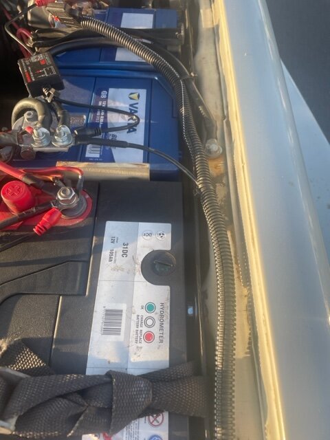

Please start, before all else, with checking the mass/ground connection right beside the main battery (see picture: the screw bolted to the right into the plate work). Remove all (even) suspicion of corrosion between connecting terminators, plates, bolts etc. Check whether cable connections are firm (not 'secretely' broken). Assure a sufficiently thick mass cable.
Then, and only then, continue checking other more complicated things.
